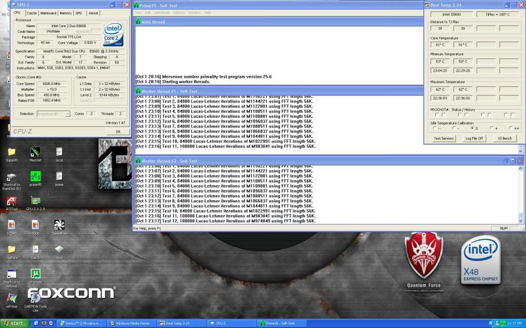

I added a couple more .. come on ppl get priming those OC's..... :)
jaredpace i will take the highest one of yours (thats minimum 3 hours primed) when i have time to look.
Reason why i stated Minimum of 3 hours primed (as a requiremenet of this database) is that many ppl can do 1 hour-2hours, but that 3 hour is extensive and i have seen many times cpu's crash just after 3 hours. Now of course i would love to see your OC primed more then 3 hours, so do your best and prime for longer if you can.
I usually do a minimum of 12 hrs of Orthos Blend and never have had an issue afterwards, but for this 4.2ghz i did 16 hrs before i shut her down and went to bed . I am sure it would have went further, but i was not staying up till 8am to see and i can't leave my PC run all night as its to loud ... then i can't sleep... :)
