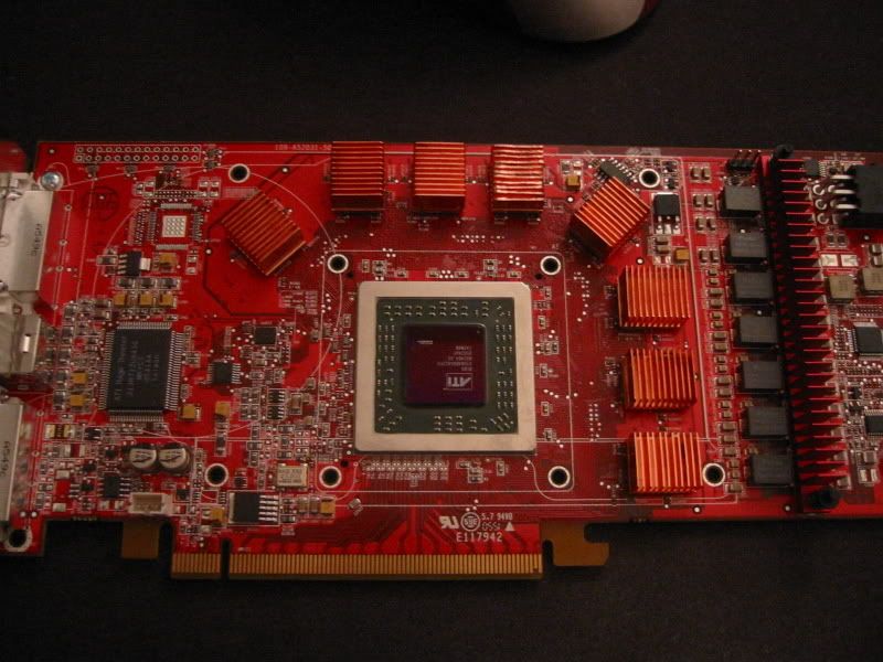

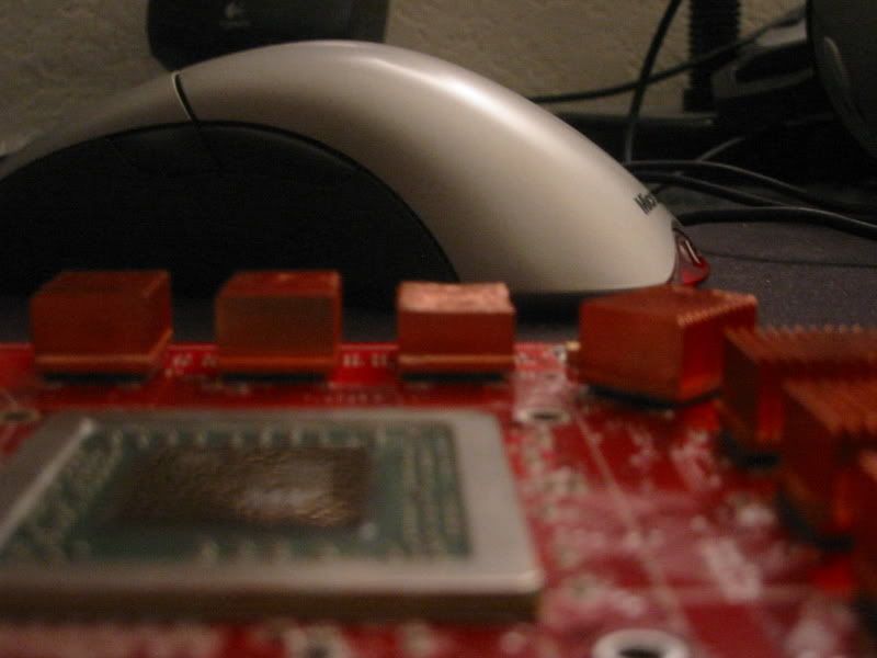

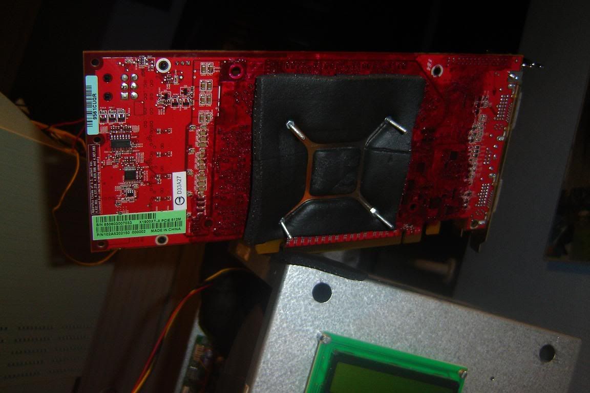

Well did some modifications...
http://img270.imageshack.us/img270/4...01837ot.th.jpghttp://img270.imageshack.us/img270/9...01853te.th.jpghttp://img100.imageshack.us/img100/6...02015bq.th.jpghttp://img270.imageshack.us/img270/7...01863ny.th.jpghttp://img100.imageshack.us/img100/4...01886af.th.jpghttp://img100.imageshack.us/img100/1...01933fv.th.jpghttp://img270.imageshack.us/img270/7...01965lt.th.jpg
http://img270.imageshack.us/img270/3...01959nc.th.jpghttp://img270.imageshack.us/img270/6...02038zd.th.jpghttp://img270.imageshack.us/img270/3...02088if.th.jpghttp://img270.imageshack.us/img270/6...02104id.th.jpghttp://img270.imageshack.us/img270/1...02113yl.th.jpghttp://img270.imageshack.us/img270/5...02126sm.th.jpghttp://img270.imageshack.us/img270/1...02139lg.th.jpg
http://img216.imageshack.us/img216/9...02157jz.th.jpghttp://img216.imageshack.us/img216/7...02172wx.th.jpghttp://img335.imageshack.us/img335/4...00014qr.th.jpg
Just started to see the max gpu speed...mem's default, cpu not maxed, benchs at 3345!
6k would be pice of cake with vga aircooled and single core!
http://img476.imageshack.us/img476/6766/7304dh.jpg
I will put 2tornados later on the card ;)

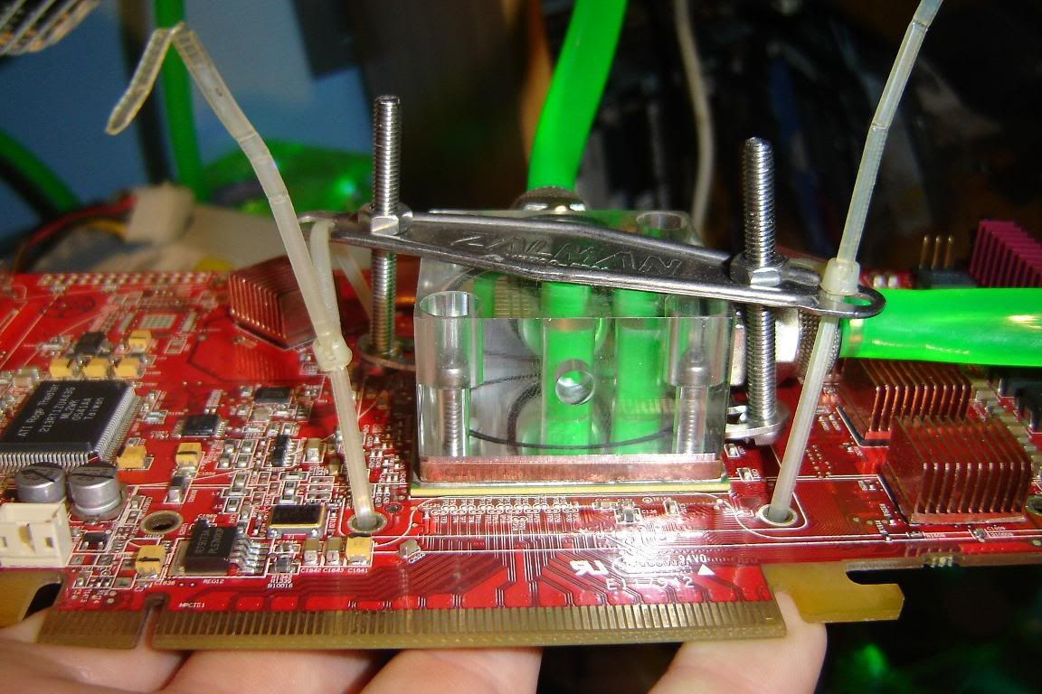

http://i3.photobucket.com/albums/y55...med-blokk1.jpg
:toast:
Will give this sucker something to chew on the next couple of weeks.
Originally Posted by LenniZ
You didn't shave down one of the ramsinks? I have the same block and ramsinks but I had to shave down one of the sinks so the tubes could fit without hitting the sink.
http://i40.photobucket.com/albums/e2...1900XTX001.jpg
http://i40.photobucket.com/albums/e2...1900XTX002.jpg
have to love the getto mod

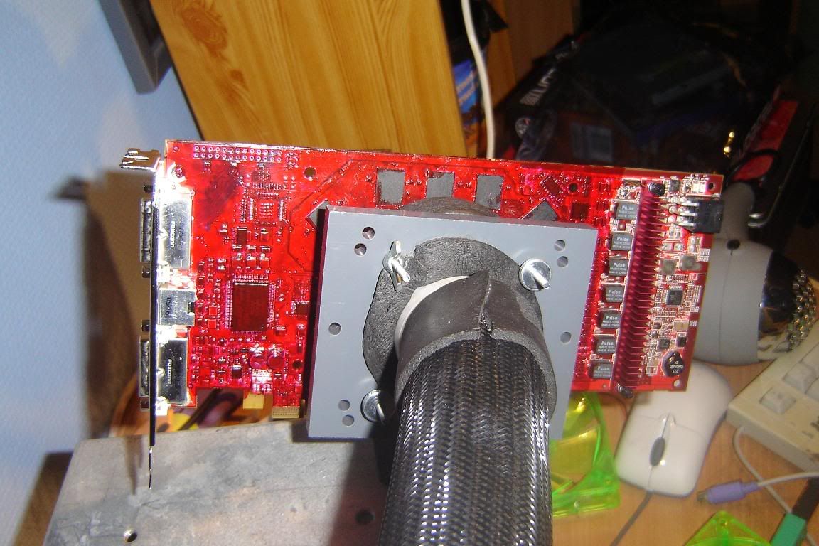

http://i3.photobucket.com/albums/y90...r/DSC07099.jpg
http://i3.photobucket.com/albums/y90...r/DSC07100.jpg
and some more to come
http://i3.photobucket.com/albums/y90...r/IMG_0790.jpg
It fitted well without any problems at all.
I would love to find out how well that ghetto mod is actually mounted. I would be kinda nervous about that one.

How hot does the voltage regulator get for you guys? I'm stressing my card out with HDRIBL right now and the voltage regulator is at 77 C right now and seems to be climbing. :explode2: Kinda worried that it's getting too hot, have any of you removed the tape that's on the voltage regulator sink and put AS 5 on them?
Are the HS mounting holes for the x1900 the same as 68/7800 geforces? I've got a water block that i made a custom mount for, for my 7800 and wondering if it will fit on my soon to be x1900xt.
Is that person me? Well, my XT idles at 30c and loads @ 38-40c (depends on roomtemperature)Quote:

god hates me i think , put the mach2 on the card and cold bug @ -12°c and it get wild :(
