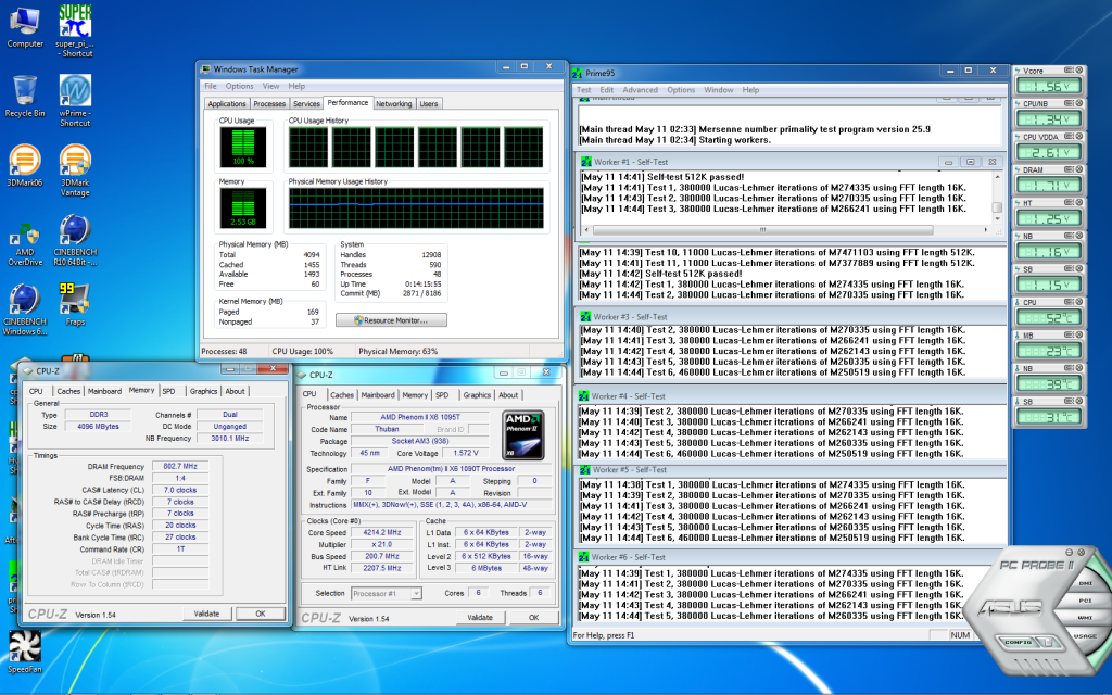

Reporting back in. My 1055t did Prime95 stable 10 and a half hours with 1.55v/1.57v. LinX, full memory 20 pass test as well, but forgot to do a screenie.
http://img208.imageshack.us/img208/7238/1055toc1.th.png
I am going to try this with a much lower Vcore. i'll report back if there's good results.
1.57V for just 4G? That's insane.
good temps for the volts though :p: ive been helping him a lil through pm so hes starting to get it figured out.. id guess he'll get 4ghz stable somewhere around 1.5-1.52v :shrug:

setting my voltage to 1.57v for 4.2ghz and the nb at 3ghz look what the mobo does
http://i271.photobucket.com/albums/j...tan771/1-1.png

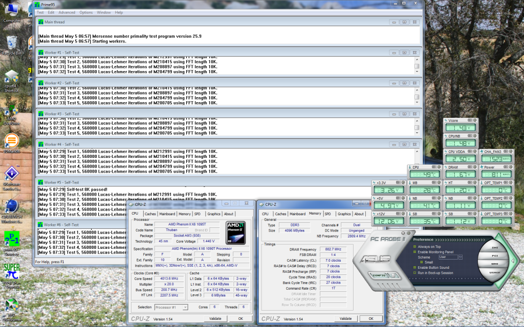

- CPU Model: AMD Phenom II X6 1090T BE
- CPU Stepping: have to check but certain about week 15
- CPU Frequency: 4100 MHz
- CPU vCore: 1.475V
- CPU Multiplier: 20.5x
- CPU Turbo: Disabled
- CPU NB Speed: 2800 MHz
- HT Ref Speed: 200 MHz
- RAM Speed: DDR2-1066
- RAM Timings: 5-5-5-15-2T
- RAM Configuration: 2 x 2GB
- RAM vDIMM: 2.00V
- Motherboard: Gigabyte GA-MA790X-UD3P
- Chipset/Socket: 790X + SB750, AM3
- Cooling: Air (Noctua NH-D14)
- Temps: 19C Idle / 40C Load
- Operating System: Windows 7
- 32/64-Bit: 64
- Stable/Suicide/Untested: Stable

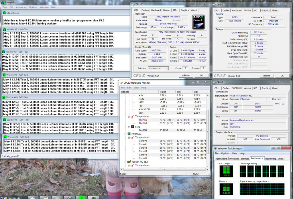

Ambient temp is 21 degrees Celcius, so I don't believe the temperature the CPU is reporting.
This is all in a closed Lian-Li PC-A05N with an UltraKaze 2000 as intake powered by the CPU fan header. The fan runs 1100RPM idle and around 1700RPM under full load.
CPU Stepping: 1012DPMW serial 005
CPU Frequency: 4113 MHz
CPU vCore: 1.4V in bios 1.404V in windows -- 1.44V load LLC enabled
CPU Multiplier: 20x
CPU Turbo: Disabled
CPU NB Speed: 3085 MHz
HT Ref Speed: 205.7 MHz
RAM Speed: DDR3 DDR1644
RAM Timings: 6-6-5-15 1TT
RAM vDIMM: 1.63V
Motherboard: Asus Crosshair IV Formula bios 0801
Chipset/Socket: 890X + SB850, AM3
Cooling: Watercooling Heatkiller 3.0
Temps: 16ºC Idle / 30ºC Load
32/64-Bit: 64
Stable/Suicide/Untested: Stable 40 mins Prime blend
Ambient temp: 21ºC
http://img.photobucket.com/albums/v6...me4100crop.png

Ran all night (8 hours) at 4004 MHz on this 1055T. I had to set it to 1.55V. Lame. Turns out my board droops to around 1.51V under load, so no wonder I was crashing with lower voltage set.
On a side-note, here's a shot from my last DI run. This is the speed I played BC2 at, though voltage was higher I think.
http://pcrpg.org/pics/computer/thuban_4550_cpuz.png
CPU Stepping: PH-E0 / CCBBE CB 1012APMW
CPU Frequency: 4000 MHz
CPU vCore: 1.525V (VID) / 1.481 V (Actual)
CPU Multiplier: 20x
CPU Turbo: Disabled
CPU NB Speed: 2000 MHz
RAM Speed: DDR3-1333
RAM Timings: 9-9-9-24-2T
RAM vDIMM: 1.60V
Motherboard: ASUS M4A79T Deluxe
Chipset/Socket: 790FX + SB750, AM3
Cooling: Air (Zalman 9700)
Temps: 17.5 C Idle / 47.5 C Load
32/64-Bit: 64
http://img514.imageshack.us/img514/8750/4gstable.th.jpg
Uploaded with ImageShack.us
CPU Stepping: CCBBE CB 1013 CPAW
CPU Frequency: 4215 MHz
CPU vCore: 1.525V
CPU Multiplier: 21x
CPU Turbo: Disabled
CPU NB Speed: 3010 MHz
RAM Speed: DDR3-1600
RAM Timings: 7-7-7-20-1T
RAM vDIMM: 1.7V
Motherboard: ASUS Crosshair IV Formula
Chipset/Socket: 890FX + SB850, AM3
Cooling: Watercooled
Temps: 52c load
32/64-Bit: 64
12 hours prime95
http://i271.photobucket.com/albums/j...hoursprime.png
