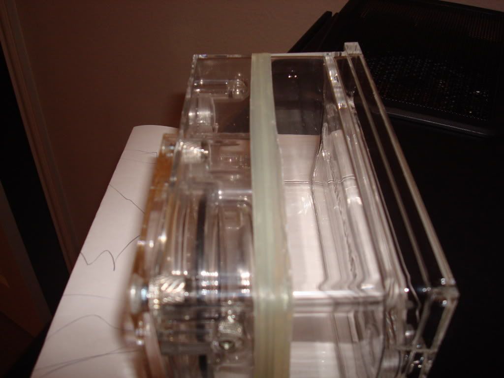

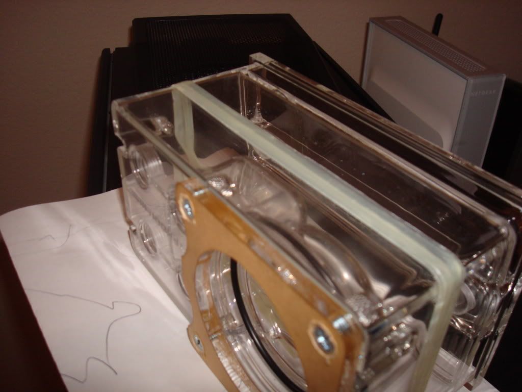

Just a quick update...
Testing is complete and I am working on the data analysis now. Need to snap some better photos (I don't like the ones I took earlier), and get cracking on the review write-up. I'm going to push this in front of all the other reviews to get the data published ASAP.

Also, mine has a white stripe around it joining the two parts, I didn't see it in the PICS on Primochill's website. It kinda kills the look, luckily it will be hidden in the case, but still.
Man am I dissapointed :mad:
compare the pics above to the actual product. Primochill fail :yepp:
The ugly white stripe kills product. Is this a bait and switch or what?
http://i118.photobucket.com/albums/o...l/DSC00939.jpg
http://i118.photobucket.com/albums/o...l/DSC00940.jpg
Nope it is some hard plastic bonding material. I am not the only one with this type of garbage.
The original process bonded the two halves together using the ledge/lip built into the part but there were bubbles visible from the front, like how glasses can make eyes look bigger. They switched to a process that put a crystal clear band on but people complained about not being able to use a fluid with Ethylene Glycol.
I told them people would hate that band if it were straw colored lol. To be fair, the one you have looks much thicker then normal and the protective paper on the acrylic mount adds some color. When filled it is not quite so noticeable, and of course is invisible when installed.
