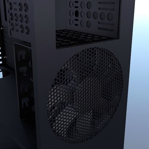

Made a few changes/refinements, incorporated some suggestions. What do you think? :cool:
http://i277.photobucket.com/albums/k...se-mkII-20.jpg
way to go.
PD: usb and microphone jacks should be on top (easy access)
What if I put the ports in a 5.25 sized panel and added a shallow 5.25 bay at the bottom. That way you could mount the ports in any of the available bays, top, middle or bottom, or omit them if you preferred. Of course, the case would be supplied with 5.25 blanks to cover any bays that were not being used.....

Made the changes to the front panel, as mentioned. What are your thoughts on these renders?
http://i277.photobucket.com/albums/k...se-mkII-22.jpg
http://i277.photobucket.com/albums/k...se-mkII-23.jpg

I have a suggestion to improve the look of the front fan. You should shape the edges of the grille material so that it sits flush with the front face of the case, instead of being recessed. Its hard to explain in words, but, do you know what I mean? It would make it look more OEM and less modded, giving it a much sleeker look.
I've given the grill idea a go, but I'm not sure that this would be easy to replicate in reality...:shrug: Let me know what you think....
http://i277.photobucket.com/albums/k...ox64/Grill.jpg
I love the case, but I think meshed front (like the MAC PRO) will look better IMO.

Ya! the grille looks great. its not difficult to manufacture it that way, they just 'punch' the shape into the material, by slamming it in a mold. It didn't turn out very noticable in the render, but in person it will be a different story.

Here's another render with the side cover on, with the flush grill.....
http://i277.photobucket.com/albums/k...e-mkII-25s.jpg
This is really good stuff right here. I wish I could have a case designed by you!
How about a square fan grill? As suggested by Eddie3dfx....:up:
http://i277.photobucket.com/albums/k...e-mkII-26s.jpg
A lot better, it goes with the side grills.

OK, I'm not going to bother re-posting the renders and animations that were lost, as they are now, basically, out of date.
Here is my latest render, now with a 140mm exhaust fan at the rear....
http://i277.photobucket.com/albums/k...II-50-1024.jpg
Here is my latest 360 degree animation, including the 140mm fan, with and without the side panels....
http://i277.photobucket.com/albums/k...ani_panels.gif
Finally, here is a simple animation showing the case air flow, which is the reason why the PSU is mounted with fan facing upwards.....
http://i277.photobucket.com/albums/k...aseAirFlow.gif
Excellent. I'm liking this quite a bit.
The hole in the mobo tray behind the processor is key! I wish more case manufacturers did this. Its a big pain in the butt to have to take my entire mobo out to swap out processor cooling solutions.
If I may be so bold to make a suggestion however...
It would be very handy to be able to substitute more hard drive capacity in the bottom compartment in exchange for the bottom rad. I'd be much more likely to want more than 4 hard drives (4 SSD's in RAID 0 + 2 "standard" high capacity HDD's in RAID 1 for archive = 6 drives!) than a triple rad after already having room for a quad!
Just something to think about.

Although, I have always found the USB ports to be more usable, when located near the top of the case. Perhaps even on the top 90 degree bend.
Looks like you can flatten that area out a tad and add the nec ports there..?

The front grill seems a little ugly to me, if there was a way to cool the drives without having the front grill at all it would be awesome.
