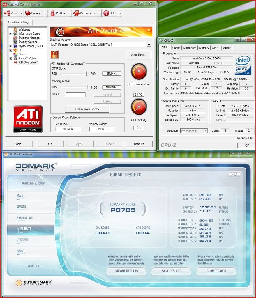

Flashed my new Visiontek hd4870 to the Asus Top bios. Runs fine 3dmark06/Vantage.
Initially wasn't impressed as my 8800gts 512mb @ 800/2000 scored 15022 and the hd4870 Top bios scored 15331 - thought it would be higher.
However, then ran Vantage. OC'ed 8800gts 512mb P6307 with game fps 16 and 17. Asus Top hd4870 scored P8357 with game fps 24 and 25.
Here is a screenie after the autotune in catalyst. Failed 3dmark06 but passed Vantage though a little choppy at times. What an oven and what a card!
http://i246.photobucket.com/albums/g...uneVantage.jpg
The XFX 8800gts will be going toEbay or here pretty soon, lol. Actually the e8400 too as my e8600 is in the mail =).

Atiwinflashed a couple of times to see which was the best bios for my stock Visiontek HD4870:
Visiontek HD4870, stock cooler. e8600 @ 4.3ghz.
Catalyst 8.8, Futuremark Vantage
Diamond XOC bios 795/1100: P8762 GPU 8783 CPU 8701 1st 2 tests FPS 24.87/26.62 Idle 78c Load 85c
Asustek Top bios 815/925 : P8775 GPU 8838 CPU 8593 1st 2 tests FPS 25.09/26.72 Idle 54c Load 65c
Asus Top autotune: 865/1090
Diamond XOC autotune: 835/1150
Impression: At least on my Visiontek card (stock cooler) the Diamond XOC bios would pass Vantage BUT did not entirely seem stable as would rarely artifact but annoyingly would stutter and jump frames.
On the otherhand, the Asustek Top bios was very smooth and stable. Additionally idle and load temps were much better. Seems to be the better bios with stock cooling.
Additionally from Catalyst 8.7 to 8.8 on the Asus Top bios Vantage scores went from P8357 (24/25) to P8775 (25/26) =)

its not loud at all,the temp are good(44C idle,51c load),I OC limited to 800/1100..I have good air cooling and I want more OC..thats the main reason..
Hatori, Hows the voltage regulator and memory cooling on that card?
Just wondering because it seem's some have good gpu cooling but they don't put anything on the memory or VRM's and that's not good.
the voltage regulator and memory cooling are good,anyone can help with my problem please?

I have the Asus 4870x2 and installed the latest drivers but the default speed for overclocking is 800 and 1000....I'm confused.:confused::confused::confused::confused:: confused:
Im trying..I understand that you suggesting OC from a software,I just installed the new catalyst 8.11..are you know a software that support overclocking with this driver? cause RT 2.11 doesnt..
b.t.w
I know that on motherboards for example some bioses better to get more performance,Im just thinking that this is the same on GPU...in CCC I can OC the GPU max to 800MHZ and I see people here get better results..in my case,my current default bios that came with the card can limit me to OC from a software to those results?
EDIT:
ok,I uninstall the new driver and reinstall 8.10(non hotfix),now riva tuner 2.11 work perfectly.Im now 850/1100..there is a tool that find automatic the best clocks for GPU & memory? and how I check stability?
