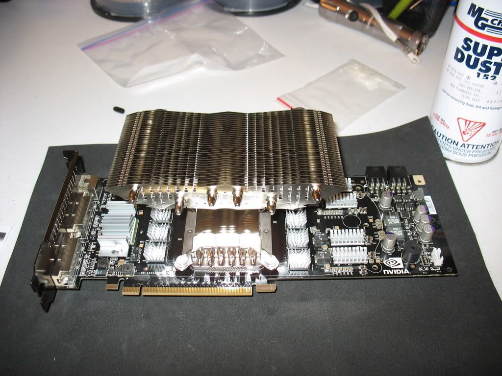

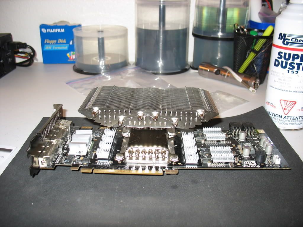

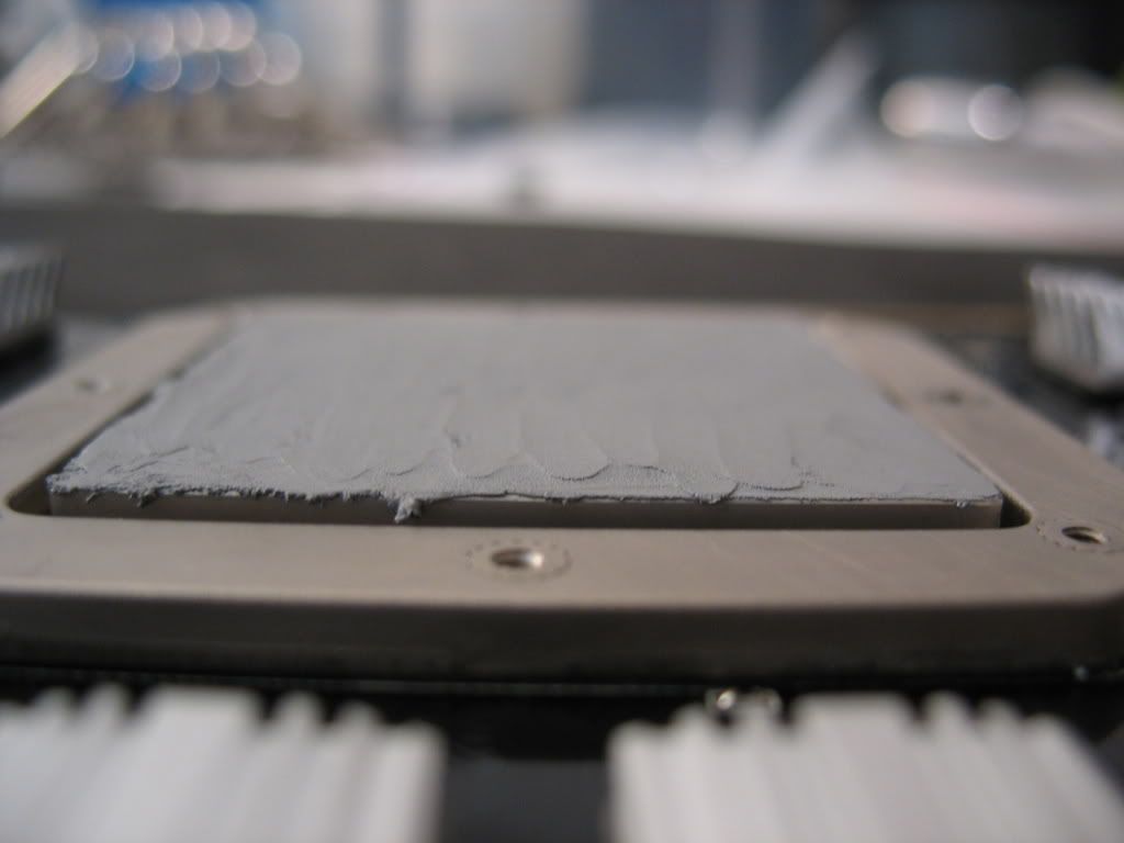

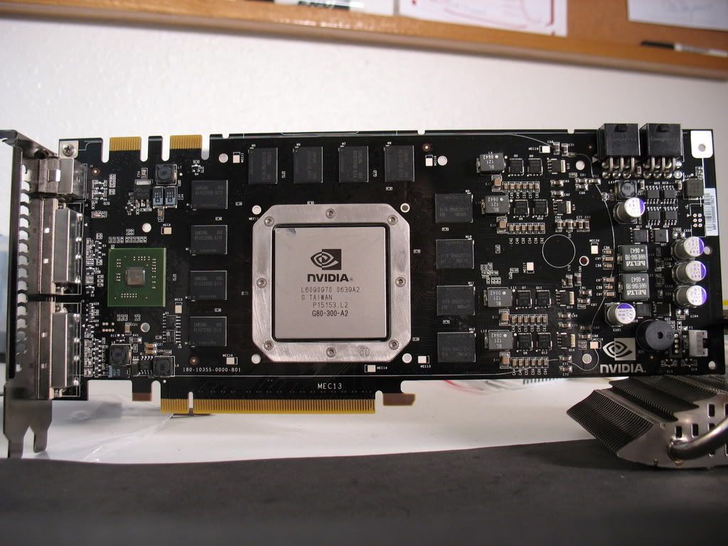

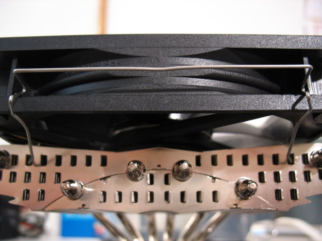

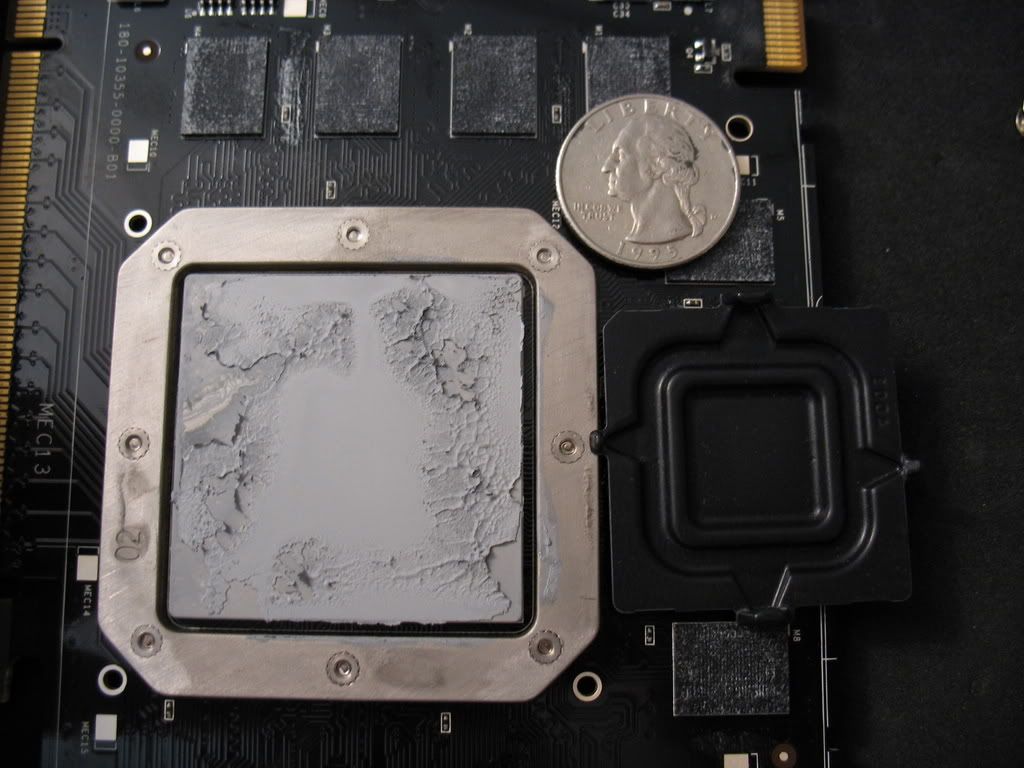

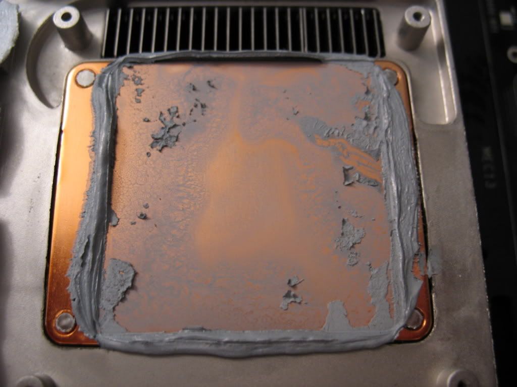

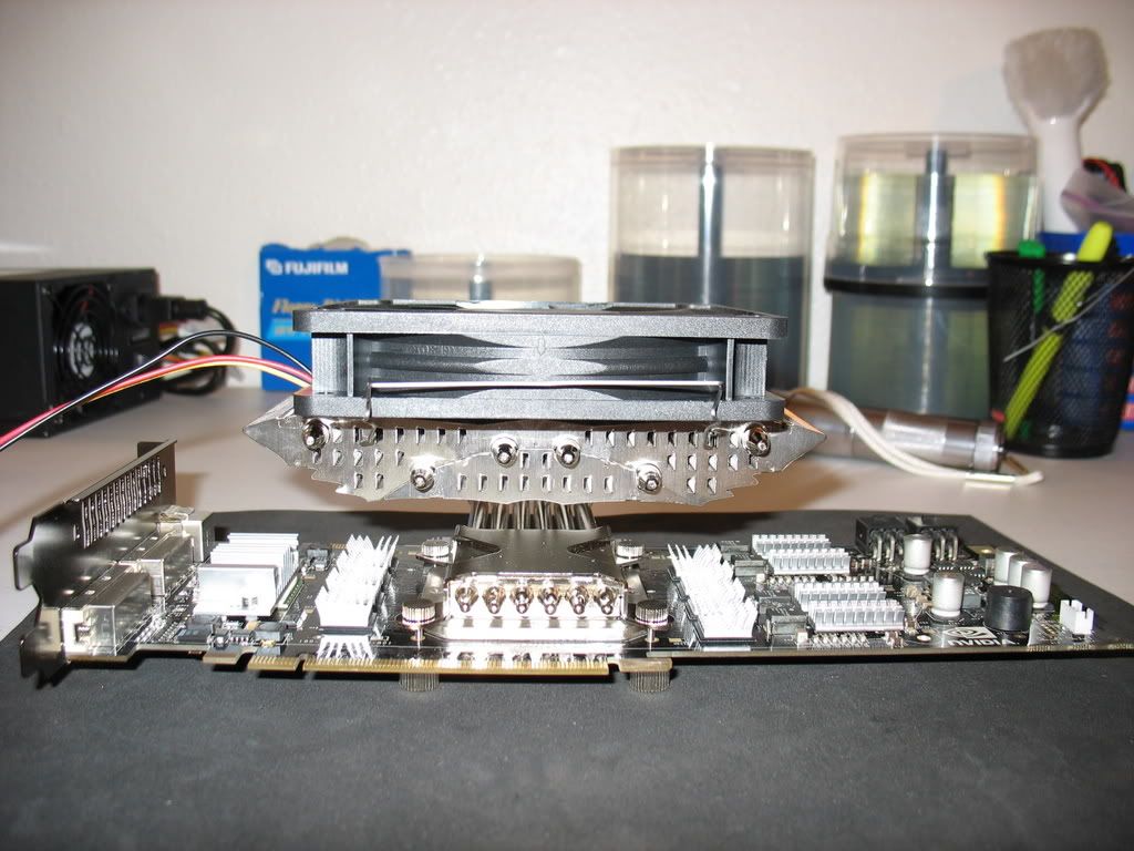

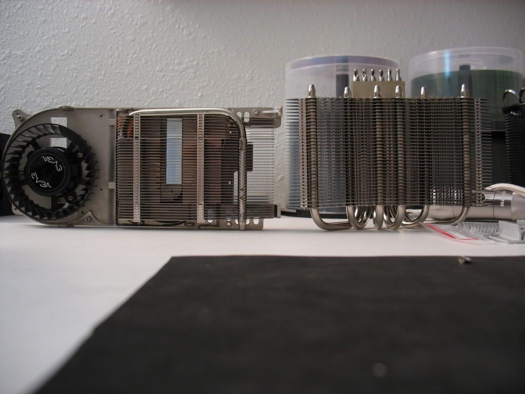

Here's some pics mounted on a Leadtek 8800gts.
I cooled the hsi (until the replacement ships) with a copper monstersink ziptied around the pcb and some AS ceramique.
load temps dropped quite a bit and arctic silver is still setting in.
here are the pics. I mounted it upside down but I dont see a problem in temps. I didn't gain any mhz in o/c though :(
I mounted a 120mm Late Yoon fan with some zip ties. I must say it's a lot quieter now.
http://www.xtremesystems.org/forums/...1&d=1173407664
http://www.xtremesystems.org/forums/...1&d=1173407596
it measures exactly 3.5 in. from bottom of pcb to top of the 120mm fan. (stacked config)

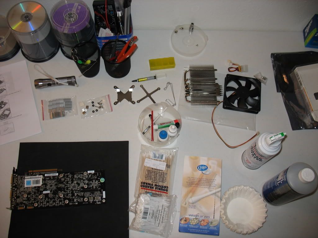

here's a few pics of the install.... then onto test results.
Couple of pictures of the heatsink just out of the box
http://img159.imagevenue.com/loc458/..._122_458lo.jpg http://img162.imagevenue.com/loc423/..._122_423lo.jpg http://img152.imagevenue.com/loc399/..._122_399lo.jpg http://img104.imagevenue.com/loc953/..._122_953lo.jpg
The new moddified HSI chip
http://img148.imagevenue.com/loc561/..._122_561lo.jpg

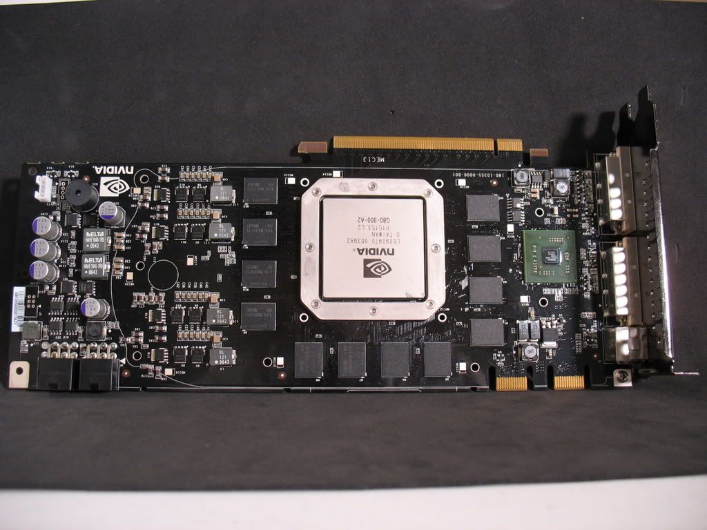

Front and back of the card / original cooler
http://img160.imagevenue.com/loc338/..._122_338lo.jpg http://img20.imagevenue.com/loc1070/...122_1070lo.jpg

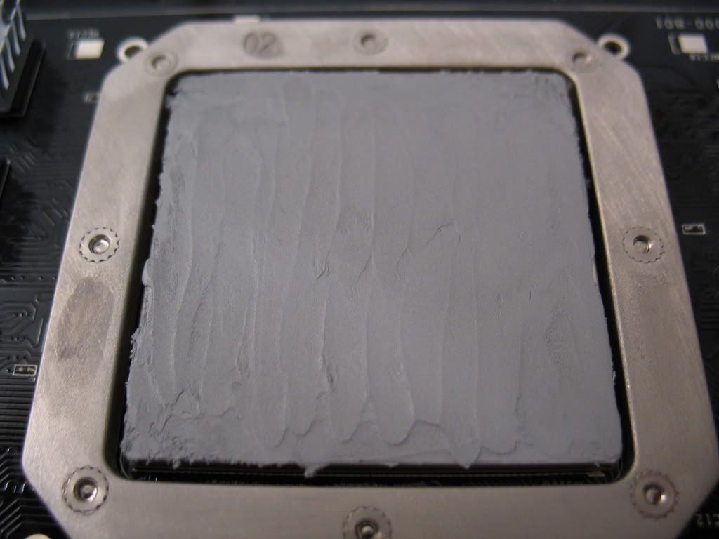

I cant get over why companys use this crap on there cards
http://img138.imagevenue.com/loc446/..._122_446lo.jpg
Naked :stick:
http://img168.imagevenue.com/loc408/..._122_408lo.jpg

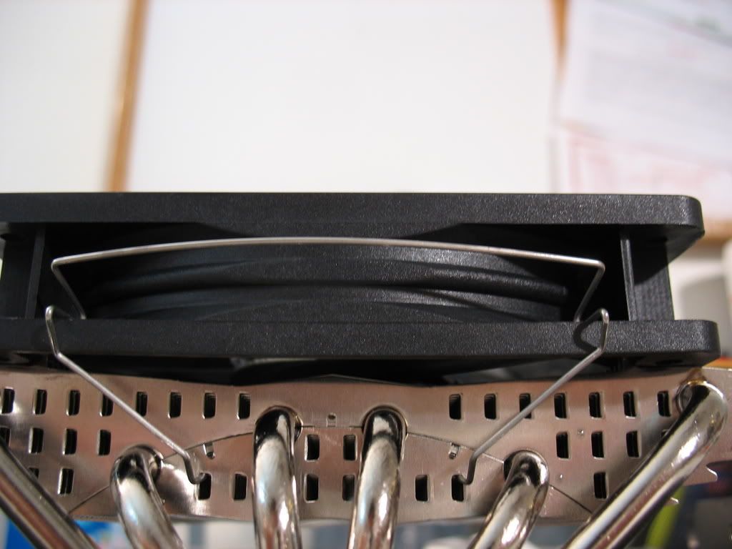

This is how the beast looks attached to the card (with 120mm fan)
http://img160.imagevenue.com/loc384/..._122_384lo.jpg
The guide says to use these thumb screw like ... er .. screws on the other side but so i could fit the card in with my NB cooler i switched sides.
http://img139.imagevenue.com/loc342/..._122_342lo.jpg

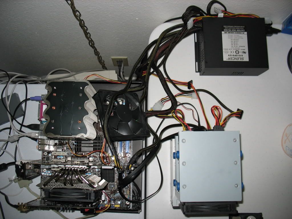

This is the beasty mounted in my poor little case
http://img171.imagevenue.com/loc445/..._122_445lo.jpg

Alright, I caved.
8800GTX 630/2000
158.19
HR-03 Plus
Scythe SFLEX E 1200RPM
AC MX-1 TIM
Room temp: 25C
Idle 45C
ATI Tool + RTHDRIBL 57C
In general the overall "heat pileup" w/ the stock cooler's gone. I made sure to press the little sinks on tough and none have fallen off. The only :banana::banana::banana::banana::banana: I have...the HSI gets pretty hot and the little flat RAM jobbies get EXTREMELY HOT!! I sure wish TR would design a solution to angle up so we can use the normal RAM sinks. The true test will be finding out of RAM OC's still stable. Pics tomorrow...
EDIT: Just ran 3D2K6 and it tops out @ 56C, lol. That's almost a 30C drop from stock!
EDIT2: pics!!

Apparently there's some lame sticky thermal pads. I used 99.9% alc from fry's and pressed them on for a good 20-30 seconds each. Then I let em sit for awhile...no rush. Not a single one has ever fallen out and I've been to 2-3 LAN parties since installing it a few months ago.
I'll tell you what, tho, that video I/O and the little bitty sinks get REALLLY hot! I would have loved to seen a bigger I/O sink and a curved pipe so the 3 ram chips in the middle could have normal sized sinks.
Aside from that, it idles around 50C and loads maybe 65C here in sunny AZ!
at first i was a bit worried as the sticky tape on the back of the VREG (c heatsinks) was not very tacky and came off with the slightest knock. After a bif of a burn in the tape bonded to the vreg's and now is on quite secure.
you could replace some of the heatsinks for the ram but the ones under the heatpipes you will not be able to replace so easly.

Here's a heads up... the Asus p5K-D P35 I have (and I assume all P35's) are not at all friendly to this card in conjunction with a sound card... the bottom of the 92mm fan nearly SITS on top of my X-fi Platinum... as it stands, I'm going to sell this on ebay and get a better solution...
I'm getting either an Abit P35 or a Gigabyte P35, can you post pictures to show what the problem is?
And thanks for the quick response guys.
That's MX-1.
The Asus Commando also had a lower 1st PCIe slot that gave me very little room when using a 120 on top (er bottom?) of HSF. I wound up w/ the DFI and there's almost an inch or two of space for air to move.
See here... I have to have some rubber separating the Fan from the sound card...
http://i144.photobucket.com/albums/r...e/P1010019.jpg
It is nearly pointless to have the HR-03 in this configuration... Idle is 54c at stock clocks and an ambient of 25c. On my P5B-D, unimpeded idle was 44c
A thought strikes me, and that thought is: why don't you just put that the other way 'round? All that'll do is take up space over your PCI-E 1x, which you aren't using anyway.
