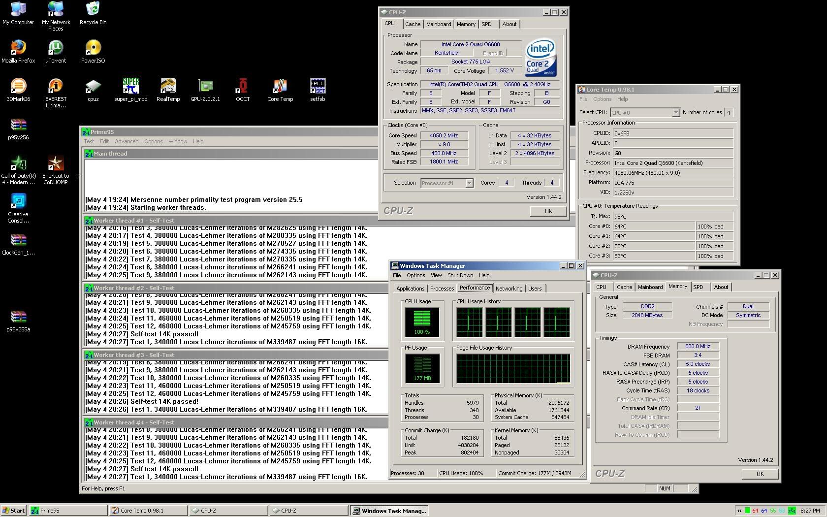

http://i48.photobucket.com/albums/f2...2976/prime.jpg
you want settings now or shall i prime longer? :shrug:
this is on bios 0308 btw. i get lower latency and slightly better bandwidth with this bios. i could let it prime for days, the temp wont budge :yepp:
you NEED to hook up that other rad somehow! mount it on top of case mabye? one on back on on top?
*im rather disappointed in myself as ive forgotten which bios version i had when i could do the same speed prime stable on 1.52v :( *
