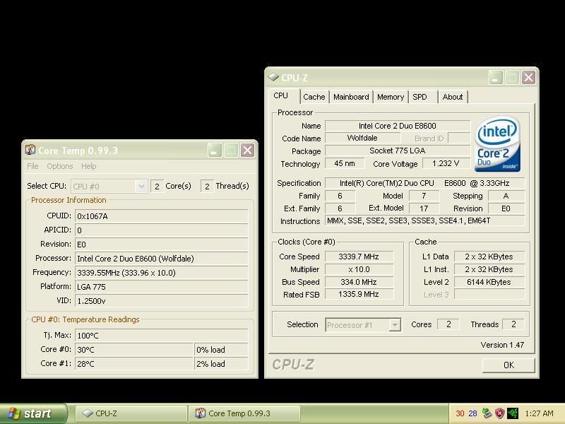

sorry for delay, mine is finally up and running... still didn't have time to tweak anything so results still at stock: batch Q820A604 - purchased from the egg on aug 27
(unlapped TRUE with 1 extra washer, unlapped IHS, mx2, ambient temp in the low 20s)
http://i41.photobucket.com/albums/e2...untitled-2.jpg
I also tested with real temp with 100c tjunction and got the same resuts
please let me know if I forgot to post any important info :)
