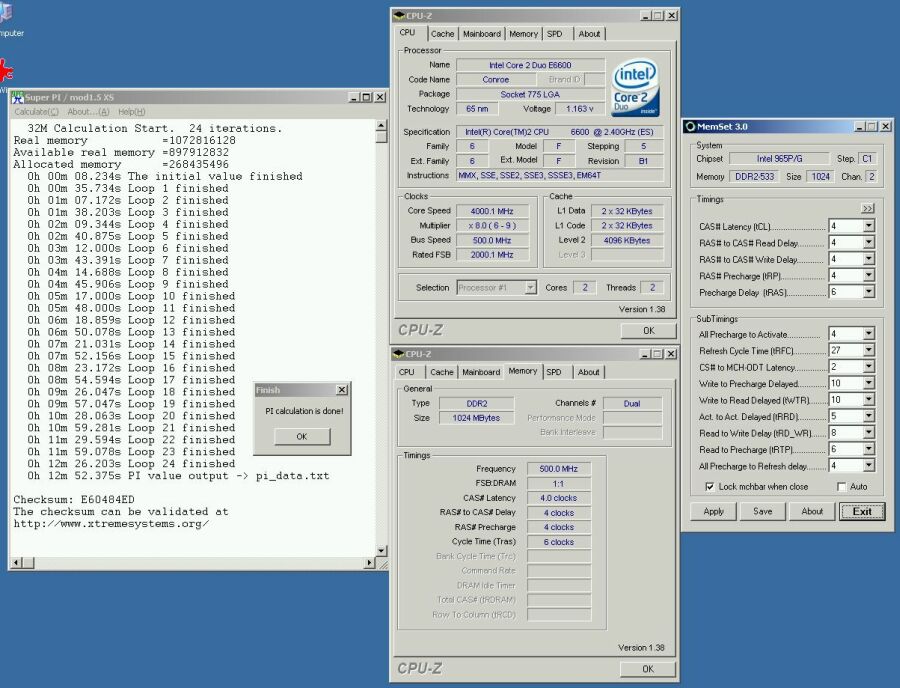

Phew! what a relief it is to come to the end of this thread, that sucker took some reading, thanks to freecableguy for getting the ball rolling and to everyone for taking the time to post up their findings :clap:
Try to play with timings, especially Trfc. It helped me a lot.Quote:
Originally Posted by ooztuncer
Board shouldnt have any problem at all to do 500 with the settings youve tried. Could be your cpu's max on air though.Quote:
32M 500MHz on 1066-strap, with 1,86V Vmch. :)
http://666kb.com/i/al0cfqlnl4evq4urm.jpg

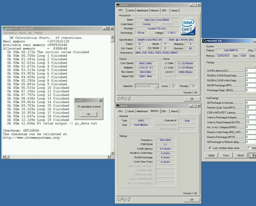

Nice one m8. Could you please run 1M for me at those settings? Thanks.
Thank you! It was bad 12.715s, don't know why. Before i managed to do 12.688s with 9 x 450, but with 4-4-3-6 and 2GB of ram. It seems that only 1GB affects 1M too, not just the bigger calculations.. With 2GB my 32M at this settings should be < 13m.. :(
Really need some of that new D9 stuff soon!
2GB wil help 1M as wel. To compare, this is 1333 strap:
http://img.photobucket.com/albums/v2.../8x487boot.jpg
Just look at the thread with 1M at ~ 4000MHz for comparable results. Imho u have already posted in. :)
Installed new windows, the other one was for 3D, not SuperPi.
http://666kb.com/i/al0fsc7cnqevt9xhe.jpg
http://666kb.com/i/al0fsgrl0y5s8dpky.jpg
With 2GB it should be something like 12m 3X.XXXs. :)
