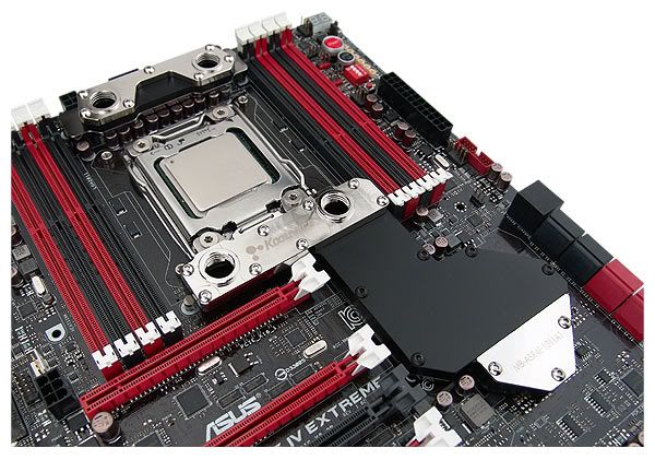

My RE4 is on order, and I'm trying to pick a MB waterblock. It seems that currently there are two companies making them. Koolance #MBASR44 and EK #FB KIT RE4. There are a couple of posts in this thread regarding the Koolance block, but nothing (that I saw) on the EK. Any advice on which is better? I'm concerned about cooling performance and about the location of the rear port on the X79 portion of block. The port seems very close to the top PCI slot and may cause clearance issuse between the compression fitting and the first graphics card. I don't know which one has more clearance. Im new to this forum, so if I'm posting in the wrong place, I appologize in advance and appreciate the appropriate redirection.
Thanks for your help.
You see you're right that SATA connectors are very attached to the graphics, so I suggest you connect the cables before installing the graphics card, then you easier access to connections.
With respect to the block EK, the problem that arises is that not all MOSFET cooling, so it is more advisable to Koolance.
A greeting.
I cannot say which block is best as I only have the Koolance. I can confirm that there are no serious clearance issue on the Koolance and it does a good job keeping temps in line....especially the VRM area that otherwise needs active cooling to overclock into the higher ranges. I will post up some clearance pics later tonight.
Currently do not have liquid cooling block, but I think the EK has committed a serious mistake not to include all component, to the left of the lower block.
http://i239.photobucket.com/albums/f...eEKmontado.jpg
While the Koolance covers everything.
http://i239.photobucket.com/albums/f...ceMB-ASR4E.jpg
Inexpliclable the EK block.
A greeting.
Thanks for the comparative pics. I never noticed before that the EK block does not cover the same area as the Koolance. I was leaning towards EK, now you have given me reason to rethink my choice. I wonder if anyone from EK would be able to post a response as to why that area is not covered.
There isn't anything to cool for the lower block except for the PCH. That's all the Koolance does, is "cover" more from view. It's up to you which one you prefer. The only thing that you can argue is that the original cooler blows some cold air onto the other components around it. Then again, you have the option to disable the fan. As long as the PCH doesn't overheat you're fine.

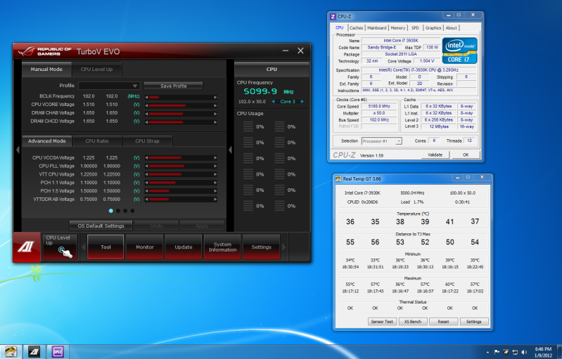

Trying some 3dmark today, 5250mhz tops on water cooling.
http://img100.imageshack.us/img100/8...nshot004sp.jpg
Uploaded with ImageShack.us
http://img831.imageshack.us/img831/1...nshot005br.jpg
I like the koolance block more (and I have it) because its aligned easier with the VRM block and doesn't interfere with the CPU.
https://lh6.googleusercontent.com/-T...0/IMG_3494.JPG
https://lh3.googleusercontent.com/-K...0/IMG_3514.JPG
Maybe the hardware below the EK block doesn't need cooling?
Slightly off topic, but looking at those 2 pictures made me wonder why not try to incorporate a cpu block and the motherboard block all in one peice? With the new X79 board layout, this should be pretty doable. It would surely help cut down on cluttered tubing runs.
EK block cools as much heat generating components as stock cooler. So does Koolance's block. The other part of the waterblock is just hanging in 'air'. There is nothing there to be cooled as I have said numerous time before.
Nothing to be cooled or not - whatever. Koolance looks better, because it's nicely surrounding the socket -> I'm getting Koolance :)
nice u are getting koolance, but tiborr is 200% right, no need cool where don't need coolig, maybe koolance only copy R4E stock cooling and thought need to be cool all the parts asus put a hs haha.BTW i think the EK plexy or nickel must be :banana::banana::banana::banana::banana:cat :D
