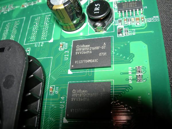

Started a vmod thread in the vmod section for the asus card, with all the information I could get and the best picture I could get.
http://www.xtremesystems.org/forums/...d.php?t=176410
/Grau
Whats the stenciled text on those two large IC's grau so we can have a stab? The pictures are, umm, not too good to be honest.
Regards
Andy
Sorry, a bit drunk ! Just seen the Anpec unit. You need to measure resistance pin 4 to 7, it will likely be between 500 and 2000. Then set pot to 20x. Measure voltage before and after and you should see a small jump if it is successful. Then slowly wind down the resistance on the pot.

If you can snap a better picture of that IC on the top right of the card near that choke and those ICs left of the choke on the bottom left of the card.

Top one, RT9232 is pin 5 FB and pin 7 ground. Cannot read the writing on the bottome one, what does it say?

anyone with experience that could help me in this thread? found some new stuff regarding the vmem mod on the asus card, I don't know if its useful or not :)

It's the same as this EVGA I have here, only difference is the EVGA has 275MHz rated Infineon :rofl:
http://img.photobucket.com/albums/v31/canny/evga_c.jpg
http://img.photobucket.com/albums/v31/canny/evga_b.jpg
