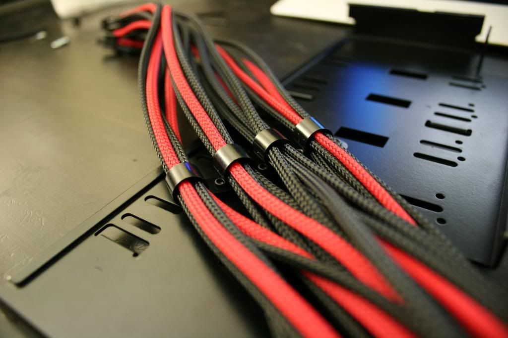

wiii, sleeved my headset + a 24pin extension, and some of the pci-ex cables for the HX 1000W.
http://i48.tinypic.com/33ehc2s.jpg
http://i48.tinypic.com/dq1344.jpg
http://i45.tinypic.com/hv8lfp.jpg
http://i46.tinypic.com/2lkfc4n.jpg
http://i50.tinypic.com/dx0lsw.jpg
Some of theese shots were my first try at macro photos :p:

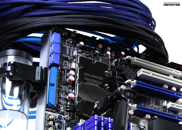

Here's my two cents from me current rig before I start tackling the full sleeving job to come:
http://lh6.ggpht.com/_QLiEm5wyerY/Sy...083cropped.jpg
http://lh5.ggpht.com/_QLiEm5wyerY/Sz...0/IMG_4285.jpg

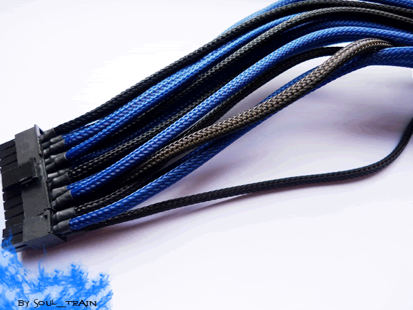

http://i989.photobucket.com/albums/a...tos/sleeve.gif
http://i989.photobucket.com/albums/a...os/sleeve1.gif
http://i989.photobucket.com/albums/a...s/24pinos2.gif
More incoming :D
Cumpz Carlos

@CptDreadFlint: Looks great! I love the grand bleu and black combination. I also see a little hint of aquamarine in the back ;)

@Soul_train: Second pic looks nice. :) Next time don't compress the image so much though ;)
