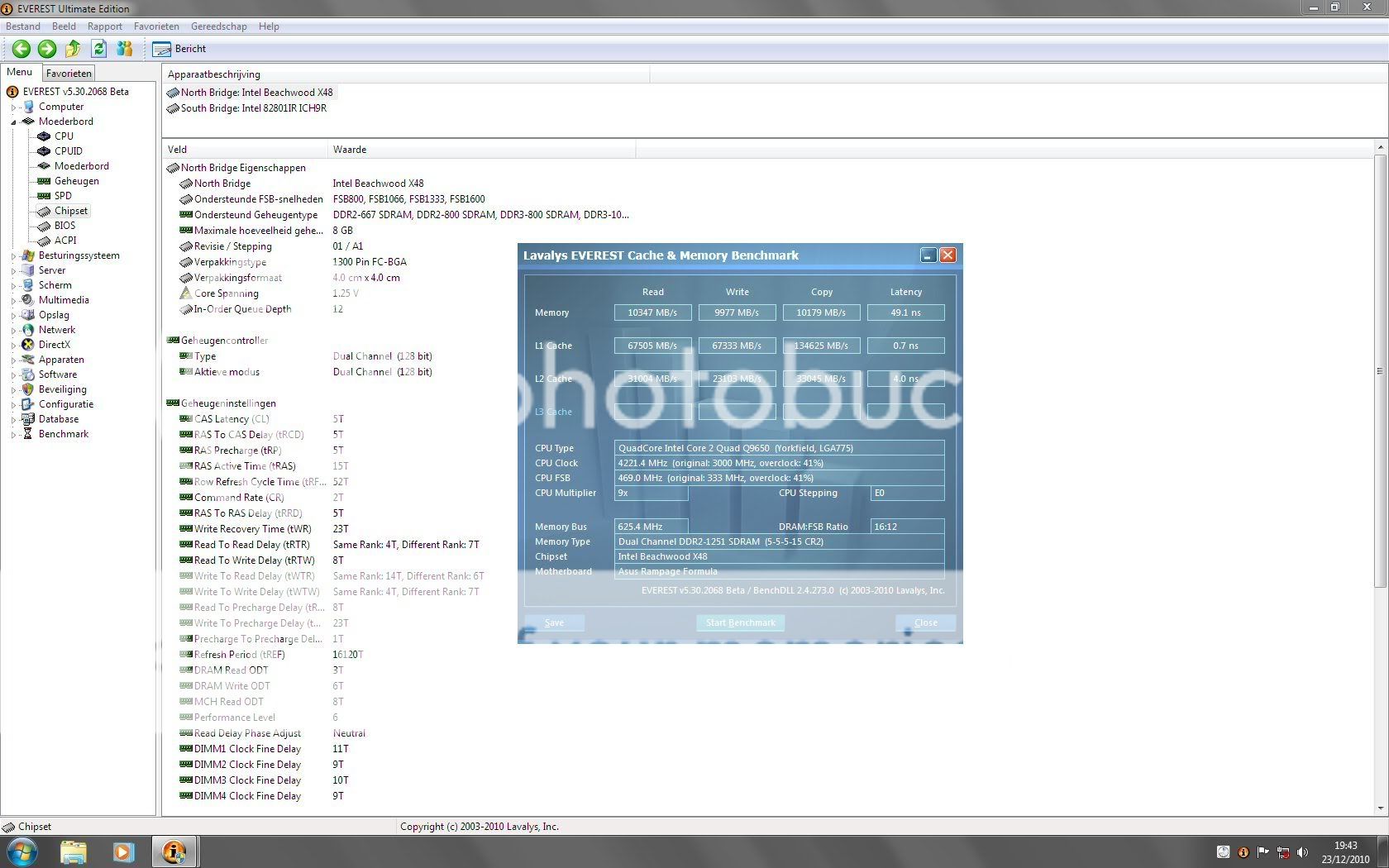

Alien Grey i took your advise about ram settings and now here is my best 460fsb settings:
Ai Overclock Tuner [Manual]
CPU Ratio Setting [9.0]
FSB Strap to North Bridge [Auto]
FSB Frequency [460MHz]
PCIE Frequency [100MHz]
DRAM Frequency [1226MHz]
DRAM Command Rate [2N]
DRAM CLK Skew on Channel A [Auto]
DRAM CLK Skew on Channel B [Auto]
DRAM TimingControl [Manual]
1st Information : 5 - 5 - 5 - 15 - 5 - 52 - 12 - 6
2nd Information : 8 - 6 - 6 - 4 - 7 - 4 - 7
3rd Information : 23 - 8 - 1 - 6 - 6
Refresh Period [16120T]
DRAM Static Read Control [Disabled]
Ai Clock Twister [Lighter]
Ai Transaction Booster [Manual]
Common Performance Level [06]
Pull-In of CH A/B all disabled
CPU Voltage [1.31875V] real 1.304Vload, 1.29Vidle
CPU PLL Voltage [1.50V]
North Bridge Voltage [1.41V] real 1.392V
DRAM Voltage [2.00V]
FSB Termination Voltage [1.28V] real 1.184V
South Bridge Voltage [1.05V]
SB 1.5V Voltage [1.50V]
Loadline Calibration [Enable]
CPU GTL Voltage Reference [0.62X]
NB GTL Voltage Reference [0.67X]
DRAM Controller Voltage REF [Auto]
DRAM Channel A/B Voltage REF [Auto]
CPU Spread Spectrum [Disabled]
PCIE Spread Spectrum [Disabled]
CPU Clock Skew [Delay 300ps]
NB Clock Skew [Delay 200ps]
What i said about skews was bs. The problem i have with l2 cache has to do with my corrupted os. I did some benches with my backup win7-harddrive and i got the right numbers :)

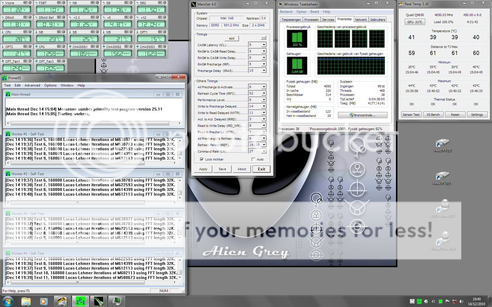

Well its good for atleast 4 hours of stress testing. Still no problems yet though, i'll run it over night before i post the settings.
http://i31.photobucket.com/albums/c3...stresstest.png
That also counts for me. I'm trying the CPU Clock Skew 300ps and NB Clock Skew 200ps at FSB 469MHz and I've got it running but I still have to find out if it's stable enough.
I think that when you can do 25 passes IBT or LinX without problems it should be enough and then you should try to run Prime95 for a few hours. Nice overclock with that Q9550. :up:
