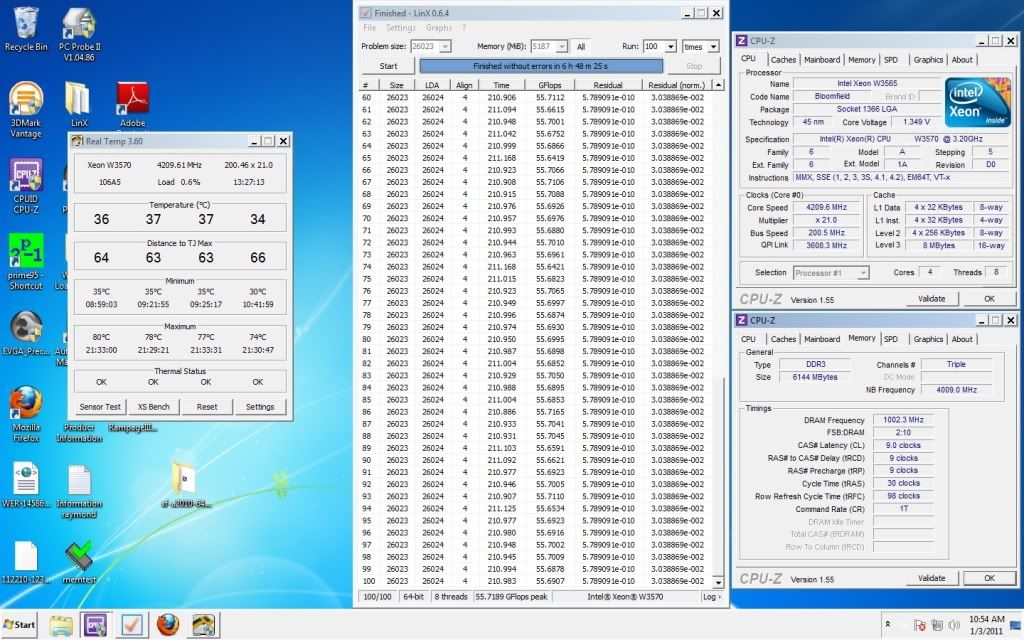

when testing in LinX, what i have learned to do is try and set the lowest
stable point for QPI, then i run LinX/IBT all threads and i begin with lets say 128Mb---> then i increase to 256MB--->512MB so on and on untill system
start crashing or stops on error, depending on the crash (BSOD) 124/101 i
adjust untill i make it all the way to lets say 4GB, after i can run 10/20 passes
on 4GB then i try and go for testing under full stress.

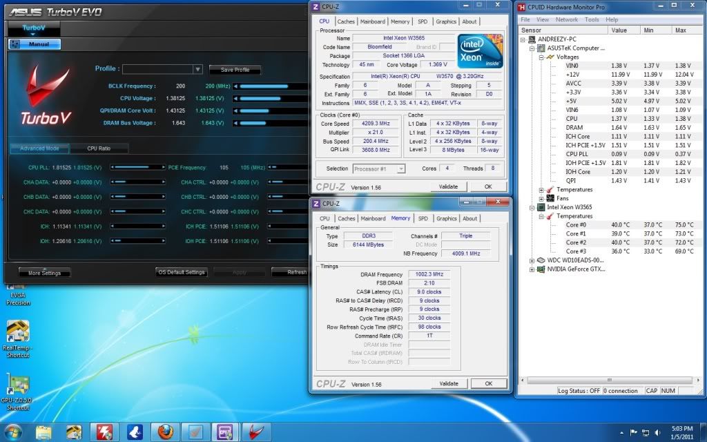

to get back on topic, i too have a xeon on this board and only thing i can tell you is, be carefull when using T-Balance/X-Power distribution profiles if you dont have your MOLEX CPU Cable plugged in..
i O'C to 4.2Ghz and then was trying to up it and while doing that i changed the profile from T-Balance to X-Power and it brought nothing but headaches for me since i dont have that Molex plugged in. if you do good for you.

i am using the 1102 bios, and i meant the molex plug called "EZ Plug" which i
believe supplies power to cpu.
but if its no difference for you between T/X power balance then good.
in my case if i go from T_Balance to X_Power i would get bad memory residuals in Linx no matter what qpi/dram voltage used, if i set it to T balance then everything is good.....:up:
maybe i should just plug that darn ez_plug myself...:yepp:
i cant hump over 4333mhz.....bad memory residuals if i go over that:down:
