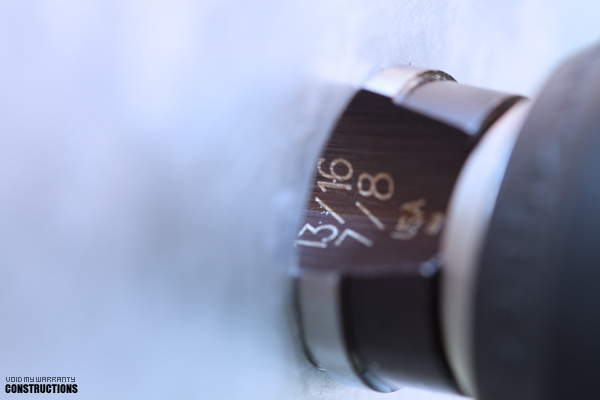

First, I drill down to 13/16 (one step down to 7/8" works too) using my trusty unibit who I call Chuck (Yes I name my bits. Yes I am aware how completely weird that is).
A 7/8" holesaw will also work.
http://lh5.ggpht.com/_QLiEm5wyerY/S1...0/IMG_4534.jpg

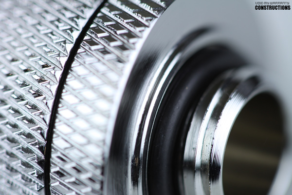

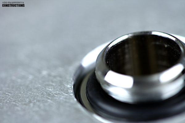

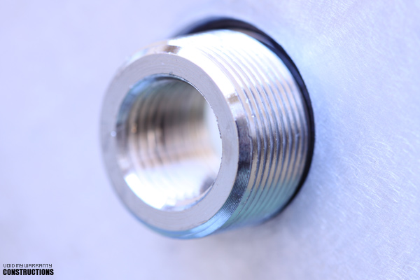

I step drill to 3/4". This size hole is big enough to clear the o-ring and the little ridge that surrounds it - the "lip" thingy and small enough that the fittings won't go through the hole.
You can use any size compression fittings since the diameters of the o-rings and the ridge are the same.
I tested that the 3/4" hole works on a 5/8" compression fittings.

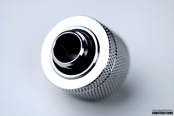

Here's a close up of the male threads of a 1/2" compression fitting showing the ridge lip thingy sitting just outside the o-ring:
http://lh4.ggpht.com/_QLiEm5wyerY/S1...0/IMG_4572.jpg
Same fitting different angle:
http://lh3.ggpht.com/_QLiEm5wyerY/S1...0/IMG_4648.jpg

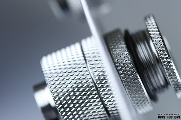

After I insert the threaded end into the 3/4" hole, I wiggle it to make certain that the o-ring and the "lip" thingy isnt sitting on the panel but making complete hole clearance.
The compression fitting must sit flush against the panel:
http://lh4.ggpht.com/_QLiEm5wyerY/S1...0/IMG_4573.jpg

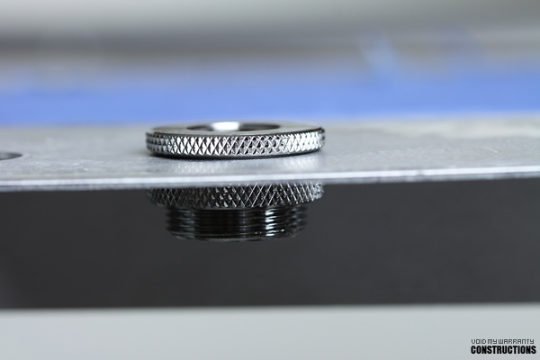

Then I connect the pass-through male-side in:
http://lh4.ggpht.com/_QLiEm5wyerY/S1...0/IMG_4577.jpg
Twist and secure:
http://lh6.ggpht.com/_QLiEm5wyerY/S1...0/IMG_4579.jpg
The image below shows the o-ring that come with the pass-throughs on the wrong side.
Although I didn't personally have leaks this way, I suggest placing it between the panel and the middle ring.
I then twist the middle ring until its securely flush with the panel.
This holds it securely in place.:
http://lh5.ggpht.com/_QLiEm5wyerY/S1...0/IMG_4583.jpg

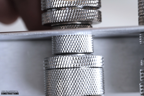

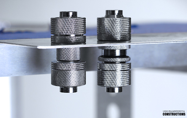

In the image below, the situation on the left shows the compression fittings being fitted by a "Multi-Transfer Base" or a female to female coupler.
I call them "Lezlies".
This method works with no leaks as well.
The situation on the right shows my finished pirate method:
http://lh4.ggpht.com/_QLiEm5wyerY/S1...0/IMG_4498.jpg
Although the Lezlies work leak-free, they're not held secure to the panel, unlike the other pass-through pirate method:
http://lh3.ggpht.com/_QLiEm5wyerY/S1...0/IMG_4507.jpg

Capt: The wide o-ring on the pass-thru doesn't do any sealing, what it does is anti-twist to prevent the pass-thru from spinning round-n-round in the hole that you/Chuck made.
I was originally concerned about aluminum contact if you're double-sealing against the panel (and I have no such grasp of the English language to make sense of such a worry in WERDS, only in PICTARS which I have no such drawing ability to create...so you see my problem here...), but now I can see that's not the case. Good on ya!

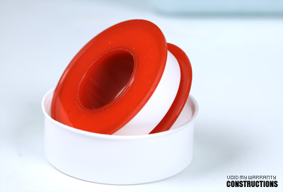

Just to be safe in regards to leaks, why not pick up that plumbers vinyl tape and use it? Erm.. what I'm talking about is a roll of thin, white (usually), vinyl that you wrap around the threads before you screw the "nut" onto the "bolt" (lezlie and compression in this case -- I think??). Wrap it around whatever you're screwing into the pass-through, so that's compression on one side and something on the other.

Yes and thanks, Antioch :up:. Was playing around with it over the weekend.

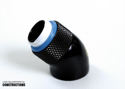

Manage to do some testing with it on a couple of 45 rotes.
http://lh3.ggpht.com/_QLiEm5wyerY/S1...0/IMG_4682.jpg
It almost feel like silly string but not.
http://lh6.ggpht.com/_QLiEm5wyerY/S1...0/IMG_4683.jpg
Yeah, it's great stuff - and cheap too! :)

Actually PTFE tape is a nono on BSPP (parallel) threads, which are denoted by "G" as in G1/4, G3/8, etc. :sofa:
Excellent work Captain.
I do agree that the thread tape in not needed on straight theads as the O-ring is the sealing part not the thread.
When your using tapered thread like you get with plumbing fittings then thread tape is a must, as the thread tape is what helps to seal the join as there in no o-ring in the join.

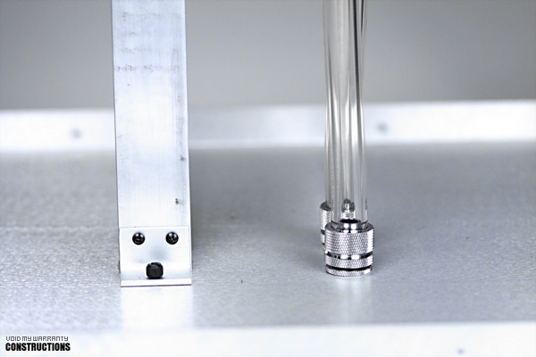

Thought I'd share some pics before I'm off to go man scan Best Buy's camera section. My tripod broke :(

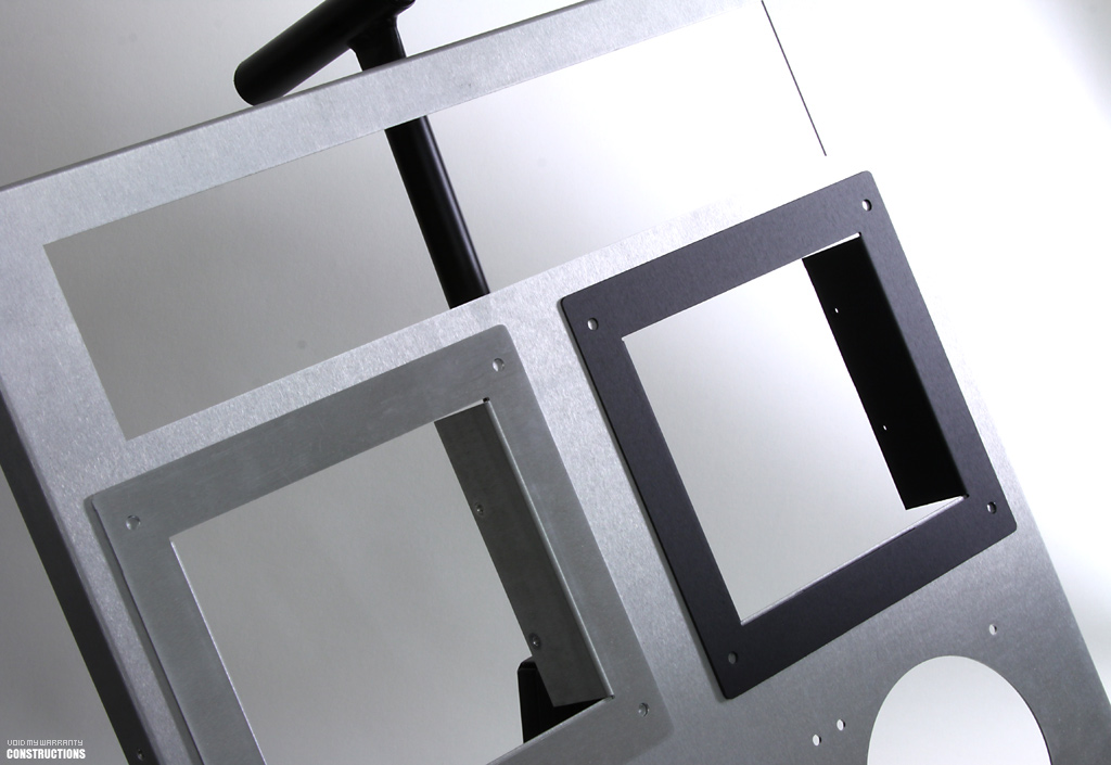

Custom front panel I ordered from Ben (Mountain Mods head honcho):
http://lh6.ggpht.com/_QLiEm5wyerY/S1...4/IMG_4591.jpg

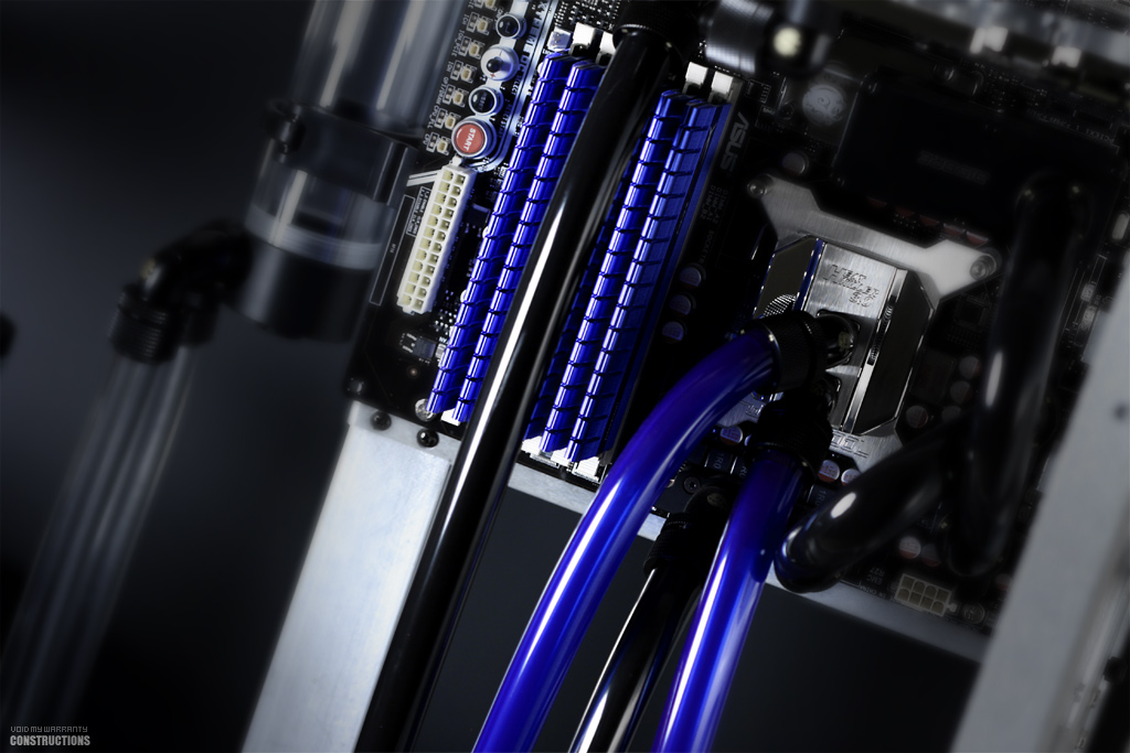

Filled and drained the GPU loop a couple of times. I'm looking for a way to route the tubing in a visually appealing configuration.
I have few ideas in mind.
http://lh6.ggpht.com/_QLiEm5wyerY/S1...4/IMG_4619.jpg
http://lh4.ggpht.com/_QLiEm5wyerY/S1...4/IMG_4545.jpg

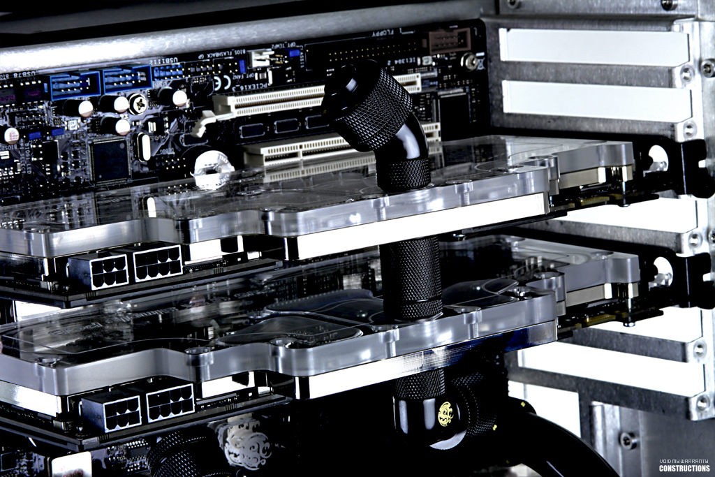

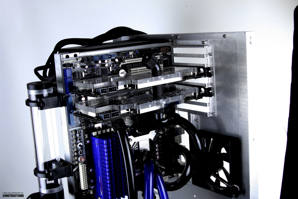

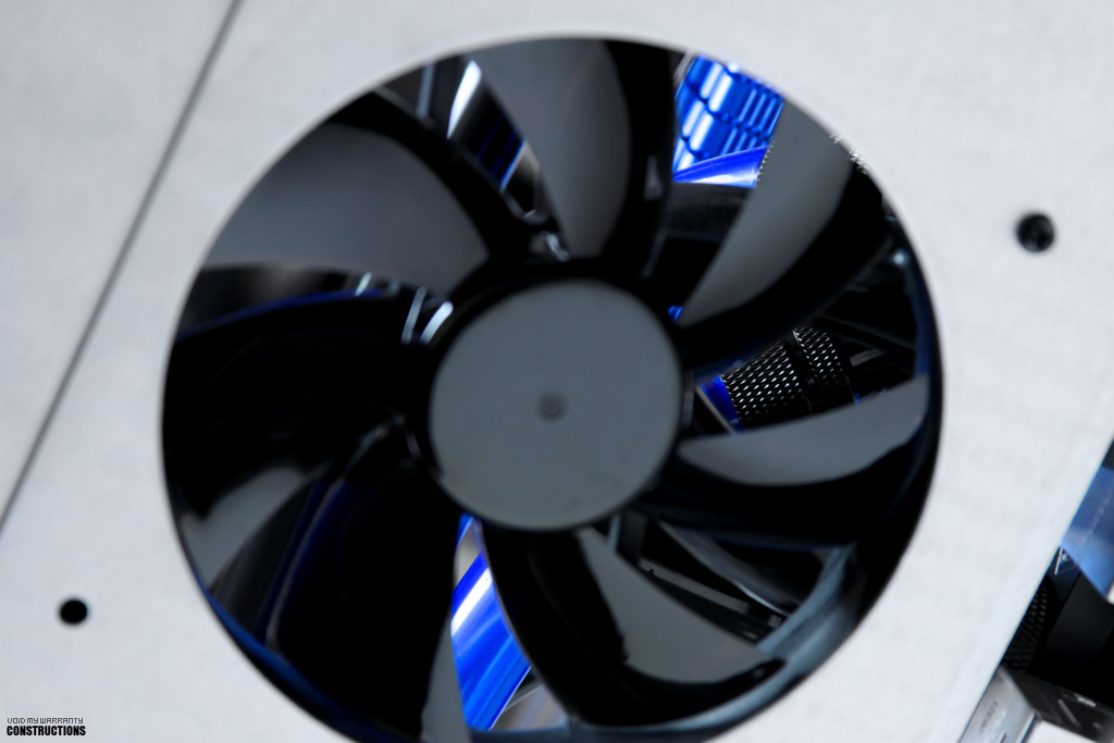

Here's the rig in its current state:
http://lh6.ggpht.com/_QLiEm5wyerY/S1...4/IMG_4618.jpg
http://lh6.ggpht.com/_QLiEm5wyerY/S1...4/IMG_4639.jpg

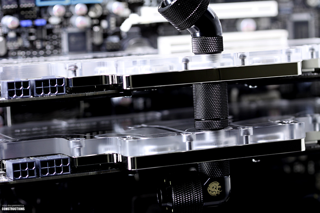

Here's my artsy-fartsy attempt.
http://lh3.ggpht.com/_QLiEm5wyerY/S1...4/IMG_4561.jpg
As always thanks for checking in all!
Those shots are just gorgeous!!!! brings a tear to my eye, mostly due to sadness and disappointment though as i know i'll never be
able to take shots like that :( make me a wallpaper please, anything will do :)
Photo's look sweeeet champ. :up:
Where does that 90 degree fitting go that on the bottom card?
