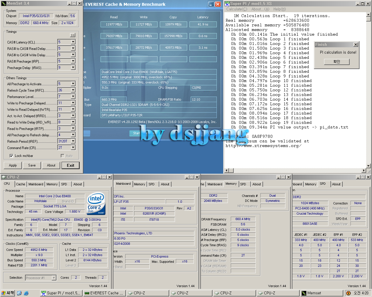

617 fsb on air
hey nikolas61... thats one nice chips you have there... its just begging to be tested with extreme cooling :up:
BTW what bios are you using ?????
