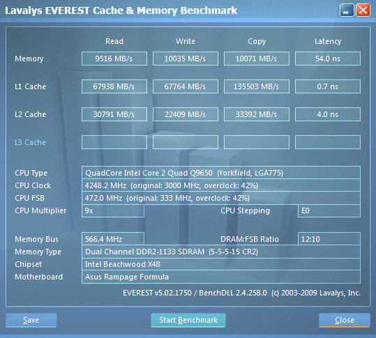

I'm running 467FSB atm currently they score almost identicle, now the rampage is untweaked and the MII was and to keep it fair I'm running PL8 on the rampage so once I drop it to PL7 the rampage will surpass the MIIF in bandwidth
MIIF
http://i237.photobucket.com/albums/f...67FSB_MIIF.jpg
Rampage
http://i237.photobucket.com/albums/f...0_notweaks.png

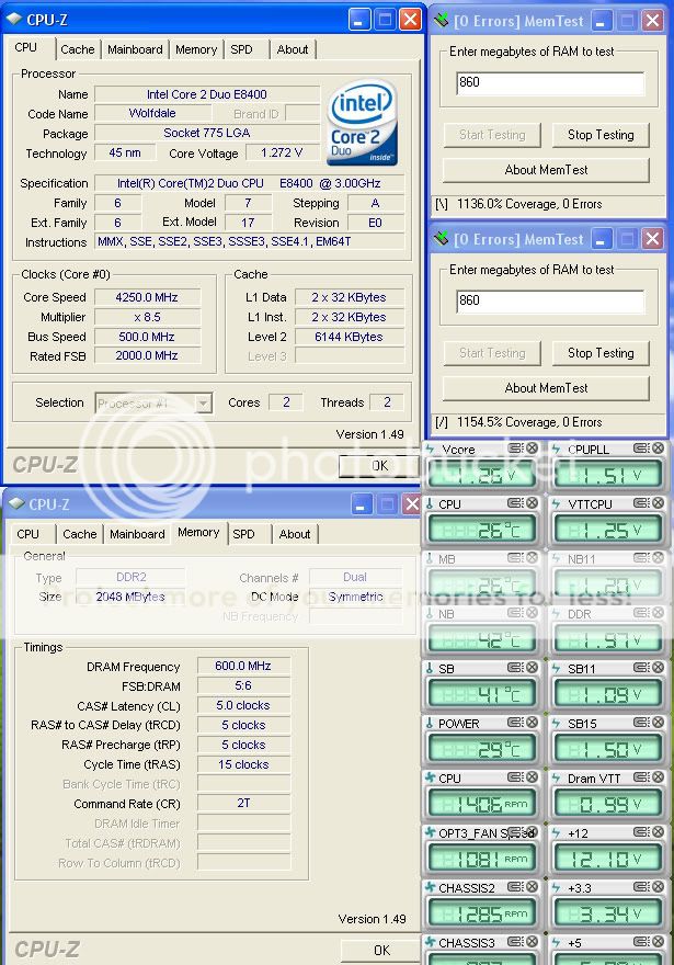

Well I managed to reduce my vNB a little :D Seems stable so far, 1100+ % dual HCI memtest with about as much ram as possible allocated is pretty solid in my experience. I'll have to do some more testing though before I call it anything like stable.
4.25GHz (500 x 8.5) / DDR2-1200 @ 1.97v / PL8 @ 1.20 vNB / 1100% memtest
http://i720.photobucket.com/albums/w...200197v--1.jpg
4.25GHz (500 x 8.5) / DDR2-1200 @ 1.97v / PL8 @ 1.20 vNB / 1hr+ Orthos Small FFT
http://i720.photobucket.com/albums/w...200197v--2.jpg
