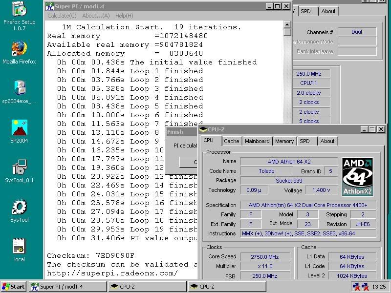

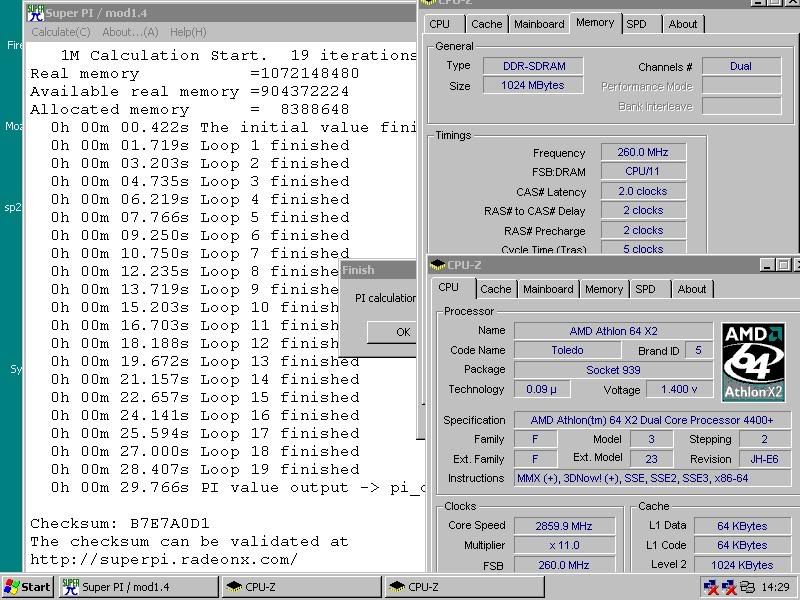

MickeyMouse i have some nice screens running 250mhz 2-2-2-5 512X2 .
http://i3.photobucket.com/albums/y90...pper/31sec.jpg
http://valid.x86-secret.com/show_oc.php?id=45181
now backt to run some more tests

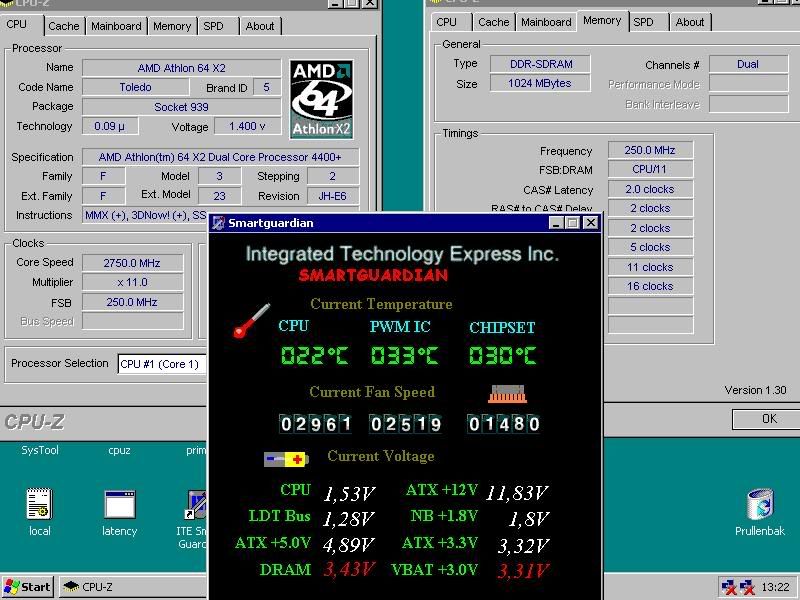

cpu-z reads mij vcore wrong so here a screen withe vcore and stuf , i dont think my cpu temps are right but wen i feel the blok its cold ?
http://i3.photobucket.com/albums/y90/blind_ripper/2.jpg
