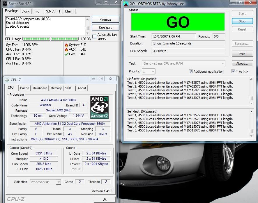

This is my 24/7 clock, 100% stable (orthos and occt)
Im still working hoping for 3.4 stable but orthos is failing about 2 minutes in :mad: my highest so far is 3.48 benchmark stable and i can't find my problem causing me not to boot at 3.5.. yet
X2 5600+ 3.33ghz @ 1.425v (bios)
idle: 27*c
Load: 46*c
Specs in sig

Your Orthos may be failing because it is underpowered/lack of Vcore at 3.3ghz and higher. This can also cause more heat to build when the Cpu dosnt have enuff Vcore to function correctly under load as in Prime/Orthos. The CPU to NB should also be set to 1.3v-1.35v which will help with the MemoryController functions.... The higher your OverClock the more the chip will demand Vcore for the OnChip Memory Controller,Especially if your memory is highly overclocked!..Vcore is what stabalizes the memory controller for the most part when exceeding 3.3ghz..On my first 5600+ i discovered uping the Vcore helps the memory controler be more stable . It also allows the memory to be OverClocked higher when using higher memory dividers too...Just make shure your 9500 can handle the heat...Ive looked into this alot and ive seen 1.56vcore used on 5600+'s with the propper cooling 24/7...
I would suspect HEAT as your main concern if you are going for 3.5GHZ....If you are still running the Zalman 9500 ,the 5600+ will start to max the 9500's 90mn Fan cooling potential @3.4ghz to 3.48ghz...Also if you Lap the Zalman and the IHS ,then maybe use some MX2paste .You will have better odds in your favor. Apply it very thin .. This will help you alot....I used to use (As5 )and now the MX2 is 5c cooler/idle and averaged 10c cooler under load...So i now use MX2 only. The 5600+ @3.3ghz and up requires a verygood cooling solution and the Vcore will most likely scale like this...With MX2 and Thermalright 120x I remounted....10times with Non lapped/IHS/hatsink and 10x with IHS/Heatsink lapped ..Then i did the same for my 6000+ on water and it scaled about the same ,just a lil hotter..
Note:5600+ 89watt and 6000+125watt scale about the same but the 6000+=MoreHeat, even more so with just Aircooling!The temps and Vcore will be a little lower under waterCooling and depends on your overall systemTemp/roomtemp.

No matter the voltage i can't get stable at 3.4, to get 3.48 i need 1.55-75v. Its 100% stable 3330mhz at 1.425v. max temps at 1.55ish volt was about 50c.
With the lock and ht link low, i wouldn't think the nb/sb voltage would be the problem. I lowered the memory to 667 @2.1v so when oc'ed its a little over 800mhz
I don't know why im compaining, alot of people can't get stable over 3.1 :p:
Id suspect heat is starting to give you a problem @3.4ghz and vcore of 1.51v...thats right about where it would be for that high of a Oc depending on the Heat ..
Its probally building heat under load and failing Orthos ecttra...Some how id try and get your temps down some more .... 3.3ghz 24/7 is very respectable....take your time ,check your temps running SuperPi @1m with coretemp open...It should be like 35c-41c with a 9500 while only using 50%core ussage

Cool, thanks for all the info man. If i ever get a WC system i might give it another try. But 46*c load at 3.33ghz @ 1.425v sounds good to me. Im happy with it. :)
Edit: i have tried 12/13/and 14 multi's and with the current clock x13 seems to level everything out nicely
