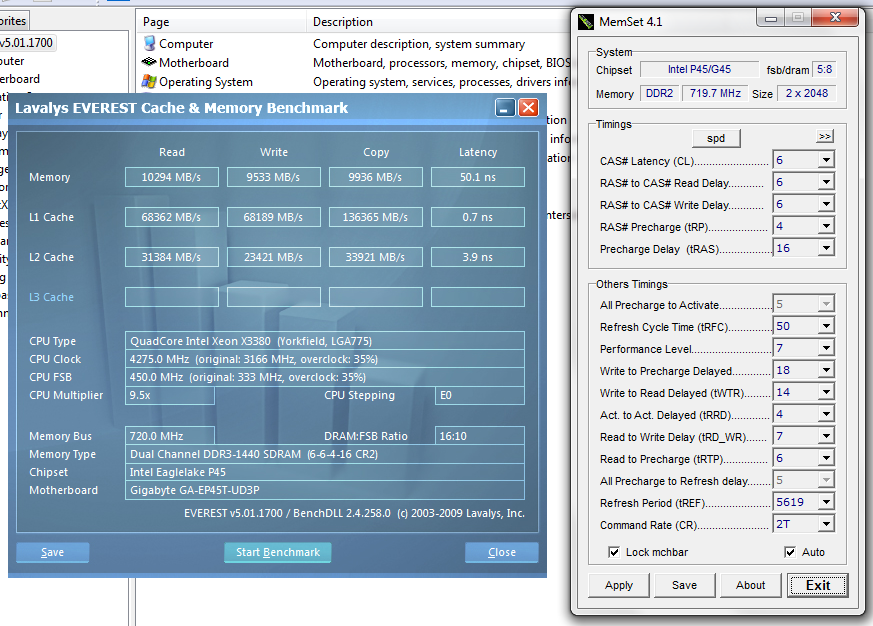

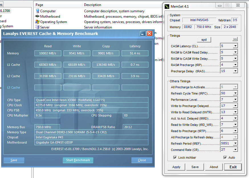

For starters dont bother with the 3.33D, it doesnt run at its rated speed, instead use 3.20B. If you want to see the difference check the bandwidth on each.

Going to 3.20B from 3.33D is by no means lowering your ram settings. Like I said earlier it doesnt run at its rated speed, its bugged and really only a 3.0, so at 450fsb your ram is running at 1350 not 1500. Heres a couple everest benchs for you. :up:
3.33D C5

3.20B C6
http://i131.photobucket.com/albums/p...81/320BPL7.png
Do you really think I can run cas5 if my ram is actually at 1500 and still have lower bandwidth than 1440 cas6. ;)
