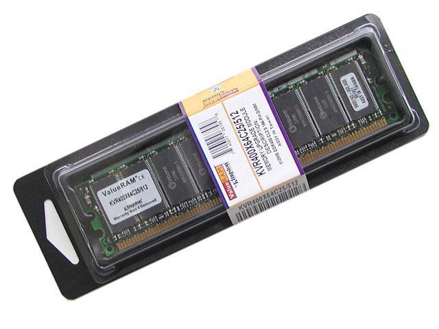

I've heard there are a couple of companies that have that left hole, but maybe I'm wrong. The most convincing marks are the two dimples in the center of the ic.
you are right.. Samsung also has holes on some of their ic'sQuote:

Is it just me or does the 512mb Adata look identical to the VX? I looked at my vx again carefully and the Winbond circles are there. I couldn't see the circles earlier because of the printing left a cloudy film over the circles making them hard to see. Also note the 512mb twinmos is also identical to the vx. These are all Brain Power B6U808 PCB's

If Im out looking for good ram, how exactly do I tell if its a BP pcb. just look for BP then code on the pcb edge ?
I think that the D denote 512m, both the speed premium and regular modules have the AADT. They look to have the same ICsQuote:

TwinMOS 256MB PC3200 non-Speed Premium --- have AADT and look like the same pcb as these (http://www.newegg.com/app/Showimage....218-404-02.jpg) which we know to Brain Power.
Brain Power PCB's typically have less clearance over the TSOPs (i.e. http://www.dfi-street.com/forum/show...&threadid=3213 an example with TCCD chips)
