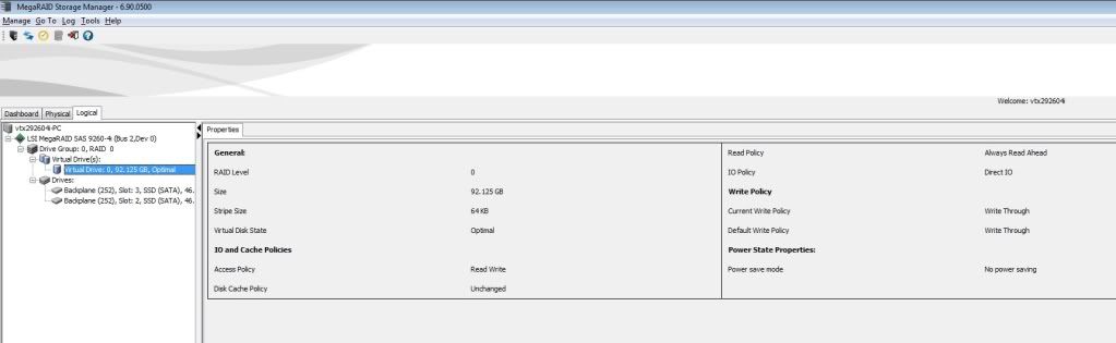

is this any good? I just did the 9260 fw rebooted and set up the raid using the lsi webbios and used the auto config. installed win7 and did the basic intel chipset, ati, then rebooted and switched to ahci in asus bios rebooted and disabled index, dfrag and superfetch I didnt touch anything else.
system is:
core i3 540 @ 3.374gb [ 160x21) qpi 3534.7]
maximus III formula 1156 (1607 bios)
5850(8x) / (lsi 9260-4i 8x) split x16 8x8 (2 pcie x16 populated)

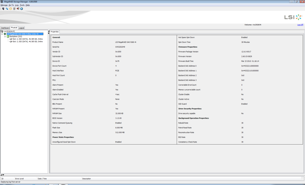

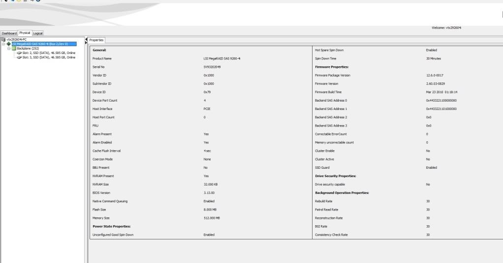

2 x 50 gb ocz vertex raid0 / 64kb stripe using lsi 9260-4i sas/raid card [Driver = Windows 7 (64-bit MegaRAID Release 4.4) 4.24.0.64 06-MAY-10 / FW MegaRAID Firmware
(MegaRAID Release 4.4) 12.6.0-0017(APP-2.60.03-0829) 06-MAY-10
4x2gb elpida hyper @ 1600 / 7-7-7-24-72 1t
these are using lsi webbios AUTO raid0 config (ctrl H) ncq enbled
http://i239.photobucket.com/albums/f...ttodefault.jpg
http://i239.photobucket.com/albums/f...unedefault.jpg
heres the lsi config:
http://i239.photobucket.com/albums/f...licies9260.jpg
http://i239.photobucket.com/albums/f...lt/lsimsm1.jpg
http://i239.photobucket.com/albums/f...lt/lsimsm2.jpg
http://i239.photobucket.com/albums/f...msm3config.jpg

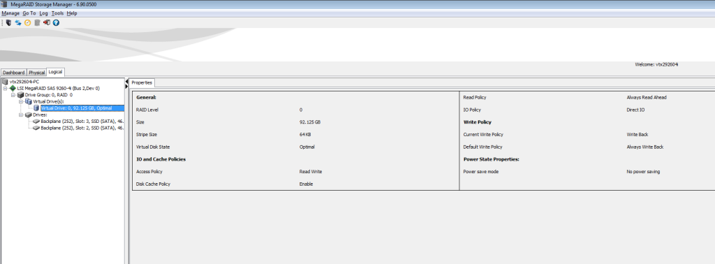

now after going into msm in windows I set the rest like we did on indlinx/barfoot
no option for "adaptive read ahead" so I just used "read ahead" etc.. benched again..
see changes:
http://i239.photobucket.com/albums/f...generalncq.png
http://i239.photobucket.com/albums/f...gs/changes.png
http://i239.photobucket.com/albums/f...tings/atto.png
http://i239.photobucket.com/albums/f...gs/hdtune2.png

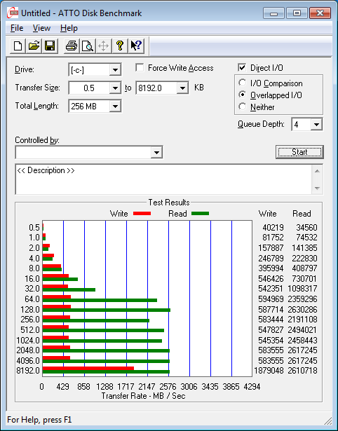

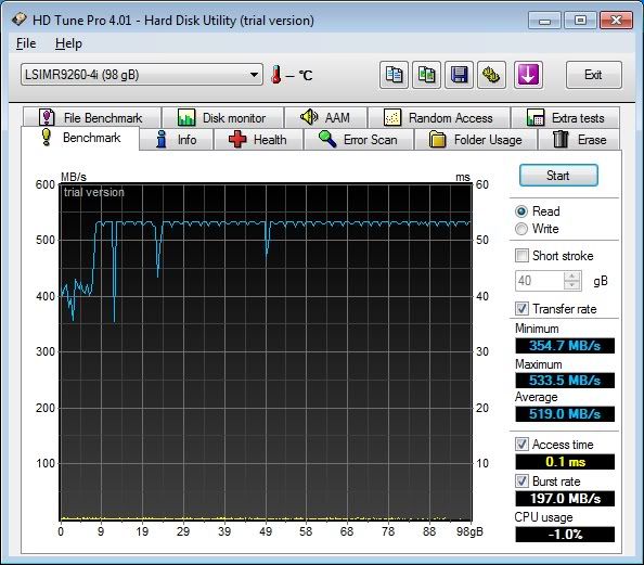

side by side compare after changes. NCQ is still enabled
It would seem you are caching the entire 256MB ATTO test file, or most of it.
Try using a 2GB test file.
Also, AS SSD numbers would be nice.
@trans am...
try using iometer or crystal bench mark. also everest is a pretty good tool for latency testing. also the winsat disk test within windows is about the best imo.
elevate a cmd prompt to admin status. then when cmd box opens up type in:
winsat disk
that will give ya some good numbers there. most of your numbers up there are cache, as gullars points out. atto is trash anyways dont even bother.
Beg to differ, but if you use it for the right purposes and know what you're looking at. It gives you a comprehensive dataset quickly. Just always keep in mind, ATTO usually gives best-case numbers, they are sequential, and default QD is 4, but you can change it.
I like to use ATTO at QD 2 (it annoys me QD 1 is not avalible) to chart sequential read/write scaling by block size, and to look for possible problems (drops or inconsistencies) as more quantitivly suppliment to CDM and AS SSD. IOmeter is ofc more accurate and can give you more extensive data sets, but it's much more work gathering and enterpreting the data there.
atto is the most inconsistent benchmark i have ever seen. run it consecutively a few times under different conditions and you will see. set adaptive read ahead on just about any raid controller and watch those numbers go crazy.
i guess i should refine my statement. for hardware raid cards atto is trash.
