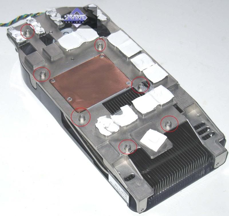

Like this:
http://i133.photobucket.com/albums/q...20-cooler3.jpg
I mean the the things in the red circle's.
These things prevent de card from bending!
