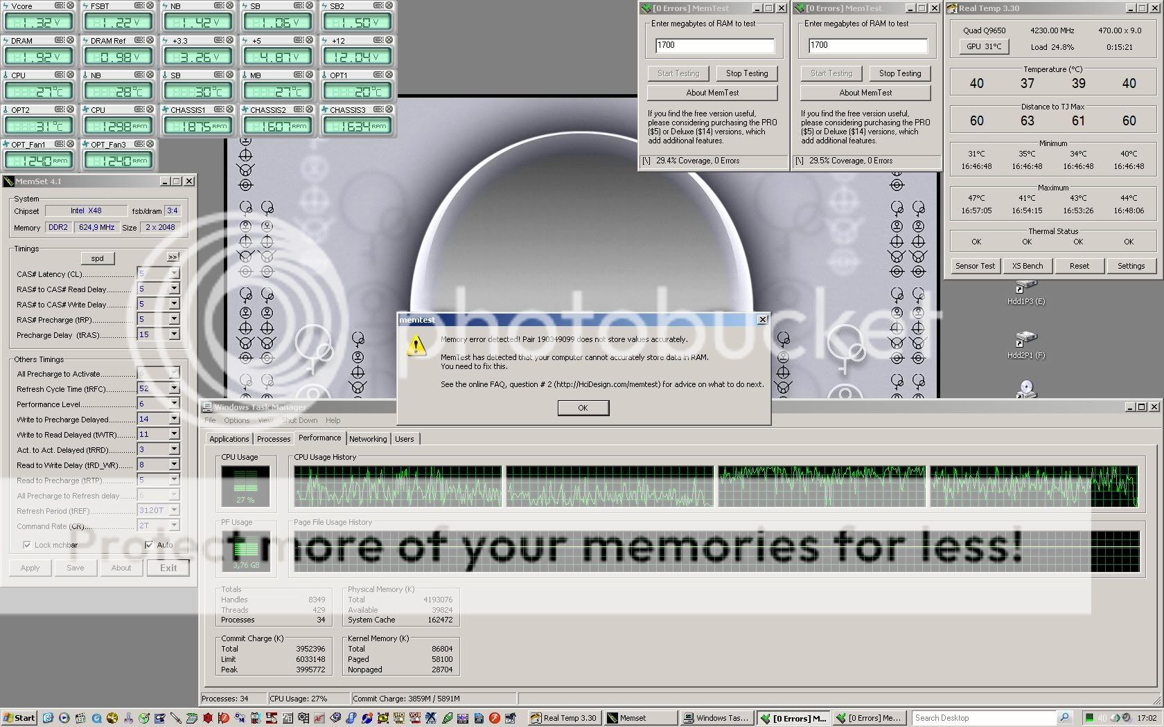

These settings are 50 pass LinX stable and 10hrs smallFFT's stable so i know the CPU voltage is fine.
The problem is that when i ran UT2004+P95 Blend it failed at 1024 or 768 size FFT's after around an hour or so.
So i increased FSB termination voltage to 1.38v and got upto 6hrs UT2004+P95 until i stopped it (it didn't error out).
The wierd thing is that now after making this change LinX is no longer lasting more than 5 passes!!!!!!!:(
I've tried playing with the NB voltage and got no improvement, i"ve set tREF back to 3120T and also got nothing.
So what should i do???
