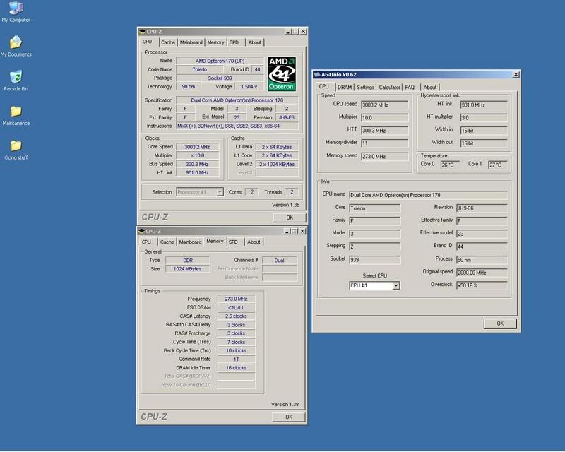

am i blind or i can't see vcore anywhere in the pic. what vcore are you running your opty at 3Ghz? thanks.
I am not sure why it does that. But its set at 1.5 vcore with a Vdimm of 1.6 and a full load temp maximum of 46c on the CPU. Idle its at 30c and below roughly. If I bleed the air out of my water cooling system Im sure I can keep it cooler more easy.
Here is a Screen shot for you.

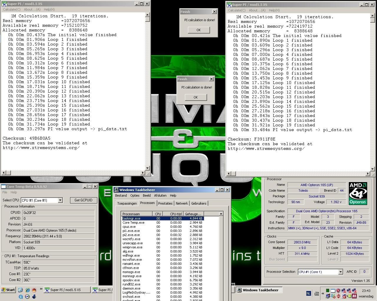

Well yesterday I received my new proc an opteron 165 ccbbe 0615dpmw:woot:
http://i133.photobucket.com/albums/q...o/1024x819.jpg
As you can see there's an wooping 13C diference in temp between cores. But that's not a real problem on load they almost get even at 46 ( as5 needs to settle in more ). The problem is that even at standard speeds my system shuts down when I run Orthos, it never did this before with m 3700+ it's irritating me. Someone got an suggestion.:(
I did have same problem on mine the cure was ihs off and more vcore... that made the temps to go closer.Quote:

Well the temp idle is not the real problem. I wanna know why my system shutsdown with no sign at all. Could it be an driver error because of the dualcore proc?

Mine do 3040mhz+ Super pi1m with 1.52v and air(23c)Quote:
Originally Posted by ashley
And Orthos around 2950-2970mhz 1.52v
24/7 speed 2970mhz+
Ihs of Big Typhoon
Temp mbm5 30-46c
Core Temp
30-53c
30-53c
