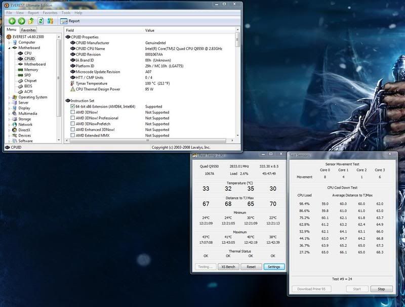

Kashii: When there is a large difference in Movement during the Sensor Movement Test, that's a warning sign of sticking sensors. The CPU Cool Dow Test confirms it. Between the 39% level and Idle, core0 and core1 move about 10 degrees while core2 and core3 only move 1 degree. You can see that both core2 and core3 get stuck at a Distance to TJMax of 63 so neither of those cores can be used for accurate idle temperatures. The first 2 cores look good and should give you reasonably accurate temperatures from Idle to TJMax.

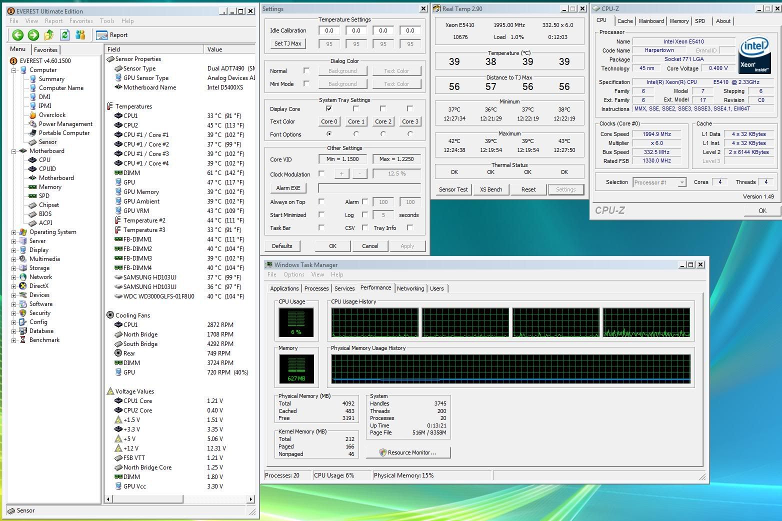

Side case panels removed, 6x333, EIST enabled, default CPU voltage of 1.2250V. The D5400XS BIOS doesn't allow for the voltage to be lowered any further.
Tj Max was set to 95°C for Real Temp as well as Everest.
The ambient room temperature was fairly stable @ 25°C.
My idle degrees above ambient appear to be in the +14°C range.
With the case side panels on, overall cpu/mem temps increase approx. another 6°C.
Alright here is the screen shot!
http://i267.photobucket.com/albums/i...s/Desktop3.jpg
ptelles: It doesn't look like CPU-Z is reading the correct core voltage from your motherboard. Everest showing CPU1 at 1.21 volts is likely correct. Your testing shows that TJMax is not likely 100C. It also looks like Intel's TJ Target of 85C for your CPU would be too low.
Based on your testing, my best guess is that TJMax is likely closest to 90C. Intel says that TJMax is not an exact number but I think using 90C will get you accurate temperatures from idle to TJMax. That would put your reported temperatures above your room temperature at a similar amount to what rge found during his testing. rge tested a Dual Core, but based on power consumption at idle, a Quad would only be about 1C higher during this test. Your additional core voltage might also contribute another degree compared to rge's testing.
9C above your room temperature of 25C equals 34C. If you use TJMax = 90C, your reported idle temperatures are going to be right in the 34C range so I'd go with that.

I took the screenshot before the test was fully done because when I took it, I thought it was already done :)
Besides that, the last two throttling TJMax distance has all the same numbers as the last throttling you see there so it wouldn't really matter anyways even if I run the test again. Unless I put my chip on a pretty good load, the last two core barely moves. For instance, they would be at 31/31/39/37 at idle and right when blend Prime95 starts, it only gets to 38/38/39/37.

2.4GHZ Vcore <1.1V Fan on Full , After Test 6 both cores will stuck on 55 and Core 1 is stuck from the beginning till the end , that CPU used to run for 3 months @ 80+C so i am not surprised if both sensors are damaged
http://i42.tinypic.com/2w6wbo9.jpg
kemo: That test proves it. Both sensors are stuck at a Distance to TJMax of 55 just like you thought.
I don't think that running your CPU at a hot temperature for months damaged anything. These sensors weren't designed to report accurate temperatures from idle to TJMax and it's likely that your sensors perform exactly the same as the day you bought your CPU. At least they're sort of accurate when the Distance to TJMax is 55 or less as long as you correct for the difference in TJMax for each core.

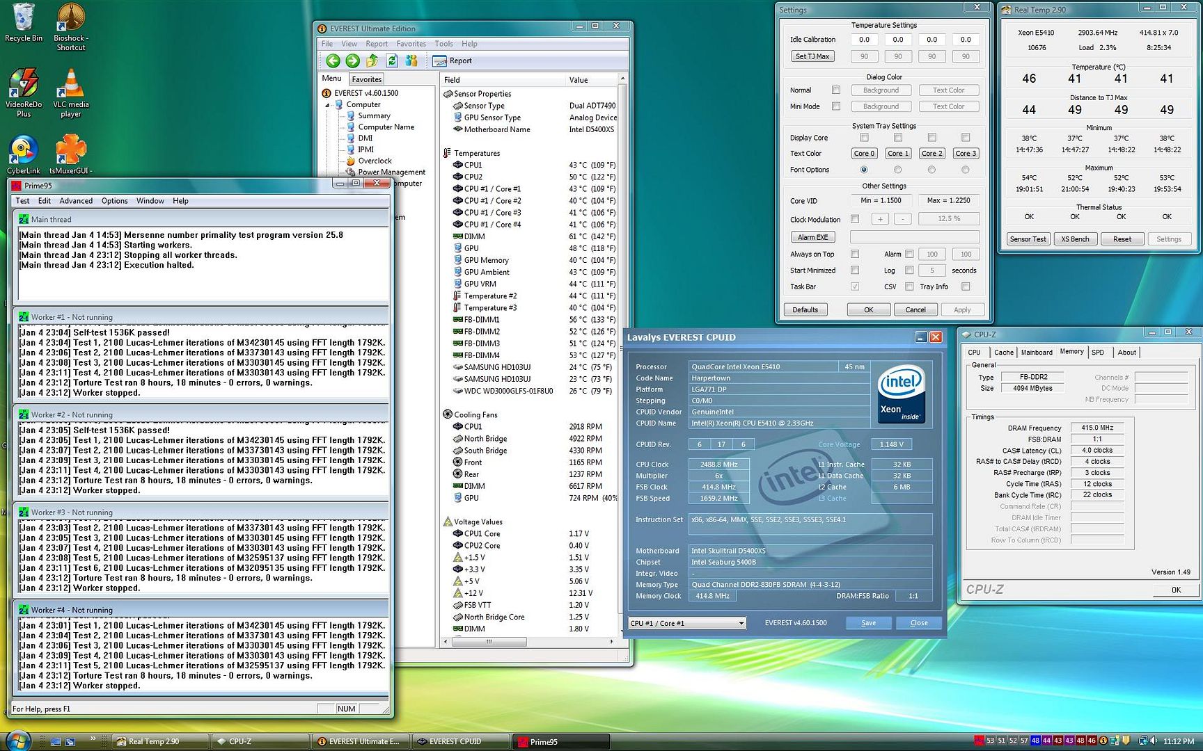

Thanks Uncle. CPU-Z 1.49 apparently mistakes the empty second processor socket's vcore for that of the first processor.
Per your suggestion, I changed Tj Max to 90°C. I also determined that in fact my intake fan did not fail as I had originally thought. With the exception of the CPU cooler, all other fans were under BIOS control. Apparently the BIOS would randomly decide not to start the NB & intake fans at power-on.
I decided to disable BIOS fan control, add 3 exhaust fans to the left side of the case and increase my overclock from 2.83GHz to 2.9GHz. ;)
I ran an eight hour Prime95 blend torture test. Real Temp reported a high of 54°C and a low of 37°C. Ambient room temperature for the duration of the torture test varied between 25.33°C and 27.11°C. Not bad eh? Your thoughts?
http://i236.photobucket.com/albums/f...rime95_8hr.jpg
