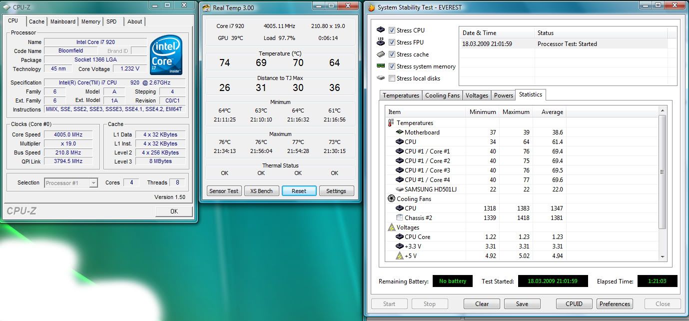

Got a new problem with LinX, actually I donīt know how to use it, I just used all my memory 12gb and then started the app, however, it turned out blue screens so far.
First:
Driver IRQL not less or equal
Second, after raising the DRAM Voltage to 1,7:
system service error
Those are my basic settings:
http://i216.photobucket.com/albums/c...lityTest09.jpg
Where should I start tweaking?
Add some vcore maybe? Isnt 1.23v a little low for 4Ghz HT on?
