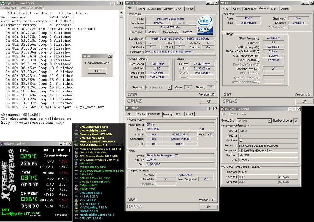

I flashed my spare chip & gave 12/24 a real quick run with my e6850 @ 4GHz DDR 1200 CL5 , I didn't have any issues.
Here are the voltages/settings I used
