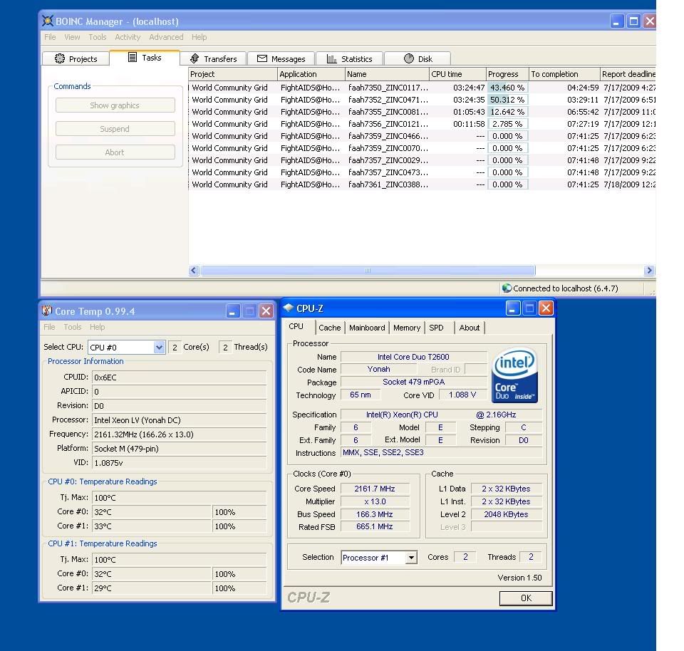

http://img40.imageshack.us/img40/6701/tempserver.th.jpg
is this normal for one core to be higher?
non issue, as it's such a low temp it wouldn't concern me.
These are rated for 100C so 20 anything is cake..
Mine run at up to 40C in a closed case and 34C in an open case..
This is one of those deals where I look at the temps and then look at the X3380 at 57C at 100% load and just smile.:D

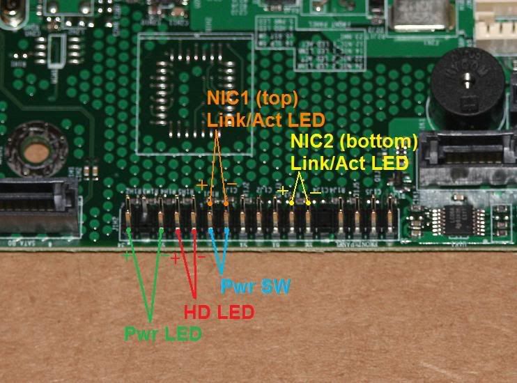

Ok my Sammy(s) build has been forever in the waiting-life has its bumps sometimes. anyways I am setting up the board, drive and PSU on a nice clean shelf so I am going caseless. After doing some reading which metal prongs at the bottom of the board i am supposed to touch together with say, a screwdriver, to jumpstart the board? I tried last night a few times had the lights on the board once I had it plugged in; but the lights seemed to flicker on and off. Now I figure i am doing this all wrong:(. Also I am going to setup another board and all the components just to make sure it is not any of the parts.
Just to double check I have a bunch of 2gb and 1gb for all my boards-if for now I am only placing 2 of each( of course just the same number;)) which slots would they go in?
Thanks guys
I actually have a few floppy drives and disks lying around still so I just did that.
Here this pic should help, I went poking around on the board with switches and LEDs :D
http://i58.photobucket.com/albums/g2...O/sampanel.jpg
According to the manual for this board, you fill from top down. So I'd put two 2GB in the first two slots and the next two slots put the 1GB.

Those 2 power "prongs" worked on the other board I put together,Thanks. I will take the other board apart and resemble it, might of done something wrong along the way!
