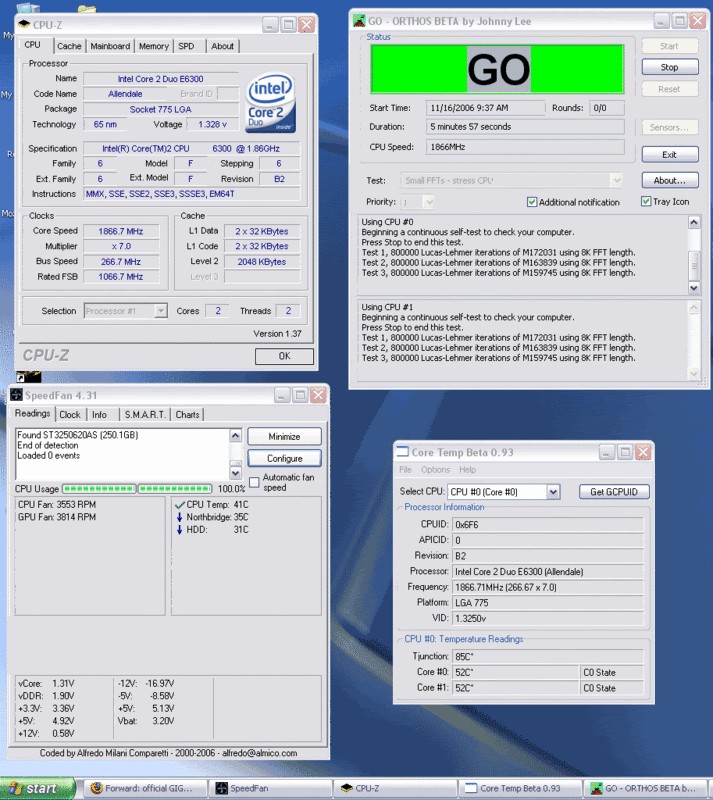

Sorry if I missed it in a previous post, but how are you measuring temps? because there's like a 10 degree difference between what the motherboard reports for CPU temp and what the CPU's internal sensors report, I think Intel would be recommending ~60c as read by the mobo and not the latter... see screenshot (max temp @ max CPU load, stock speeds)Quote:
Originally Posted by markopoleo
http://i12.photobucket.com/albums/a2...stock-load.gif
