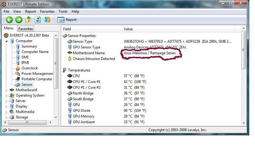

did anyone take notice of what Everest is calling the board?
http://i237.photobucket.com/albums/f...inger/rms2.jpg
Yeah, my Everest has always called it that, since bios MF0505 (or that is when I noticed it...).
everest
