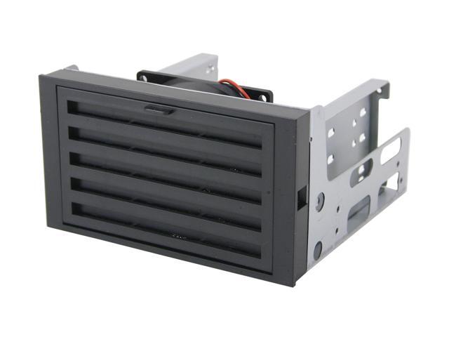

The Falcon SSD drives are supposed to be good value. I'm glad I use low-profile RAM, it gives me more room around the back of the HDDs for cables. My Pioneer DVD drive has to be thrown out the window, it won't fit on the top as it hits the 200mm fan. I'm going to get a Plextor PX-850SA instead. You could also fit a drive bay in the bottom for the hard-drives, I've saw this device used in the Mini P180:
http://c1.neweggimages.com/NeweggIma...999-209-01.jpg
It's called a Heat Terminator, with a 80mm fan on the front. If this is installed on the two bottom 5.25" bays, the top driver cage can be removed completely and an extra fan installed, I'm considering this myself.
