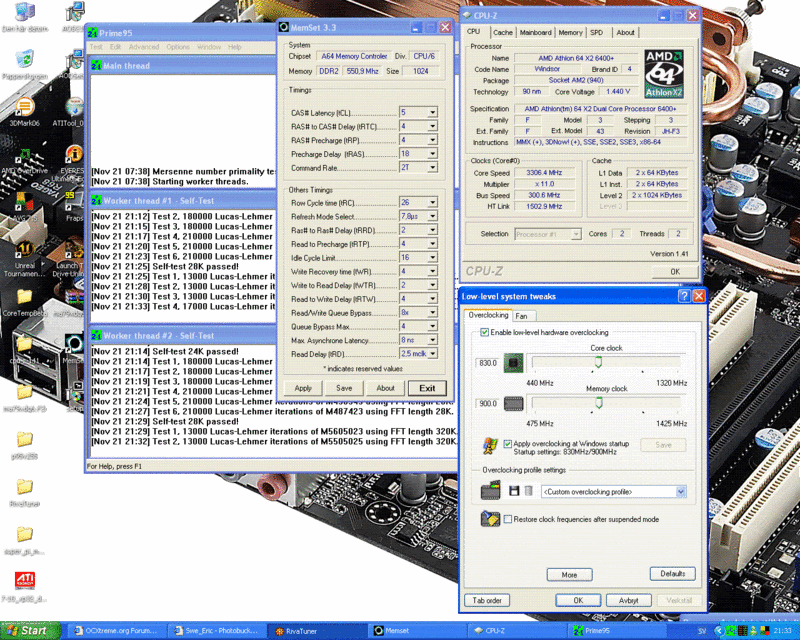

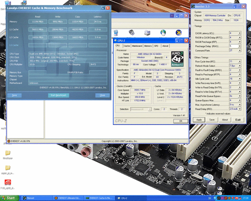

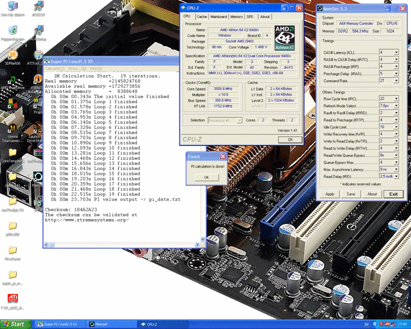

Quick SuperPI 1mb test with new kit of ballistix @ 2,42v
http://i30.photobucket.com/albums/c3...c/yes23sec.gif
Everest :up:
http://i30.photobucket.com/albums/c3..._Eric/4444.gif
24/7 Setting ;)
http://i30.photobucket.com/albums/c3...alySetting.gif
Did tight up my tras to 10 and trc to 11. V-core lowerd to 1,424
