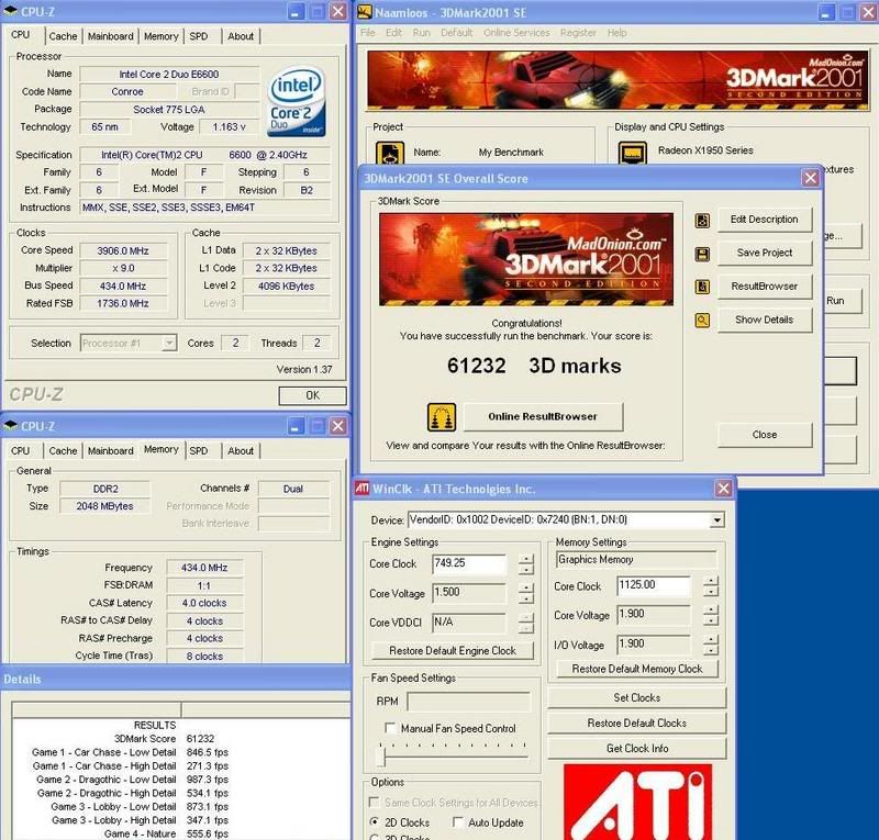

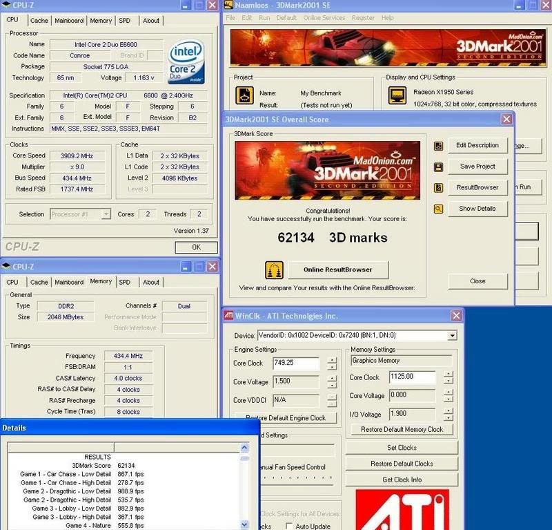

Tried 2001. Though difference would be bigger. All 1:1, same clocks & settings. All air :D
Boot 9x434:
http://img.photobucket.com/albums/v6...oc/boot434.jpg
http://service.futuremark.com/compare?2k1=9071465
Boot 9x400 clockgen 434:
http://img.photobucket.com/albums/v6...ot400cg434.jpg
http://service.futuremark.com/compare?2k1=9071460

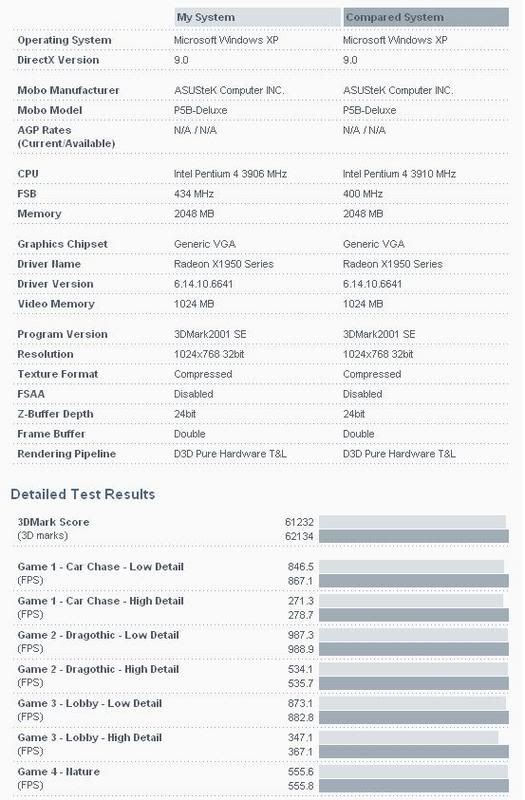

Compare:
http://img.photobucket.com/albums/v636/loc_oc/comp.jpg

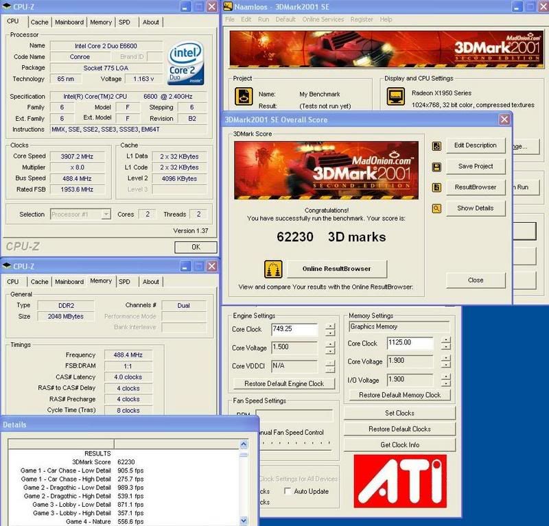

To keep up 8x450 clockgen 488:
http://img.photobucket.com/albums/v636/loc_oc/8x488.jpg
http://service.futuremark.com/compare?2k1=9071448
