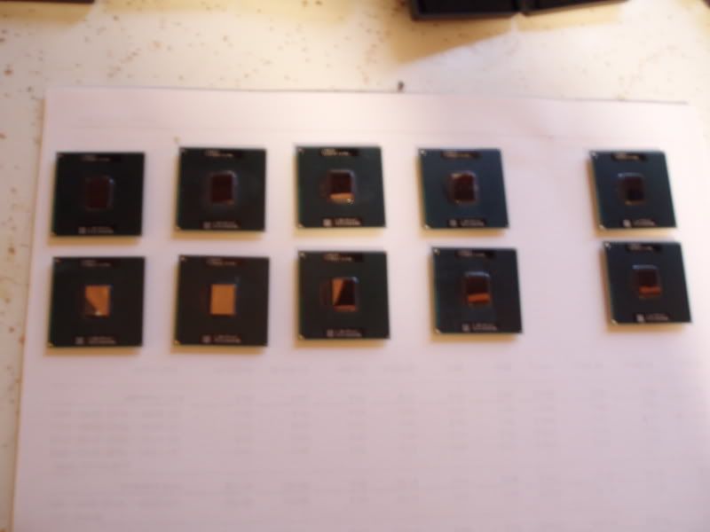

:up:These are it 1 set of SL98Q(on the far right) and 4 set's of SL9HN. If you need a close-up still, well your gonna have to help because I couldn't seem to get a good clear one. I am mad crazy excited about this!!!!

Let's see if I can be of any help here. What you should try and do when taking pictures of hardware is to make sure there's enough light. You don't want to flash, but you want the shutter speed to be high enough so that the picture isn't blurred. That's the most important thing, really.
Also, when doing macro photography, I use manual focus. My Canon A540 point and shoot is still pretty good at that stuff, as shown below. I rarely use it any more though, I've got an EOS400D/Rebel XTi now.
