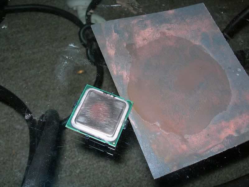

Well, you guys got me so excited by the pretty lapping jobs, I had to try for myself.
Last edited by crazyea; 02-06-2007 at 03:29 PM. Reason: Old pictures ugly, new pictures pretty.

so how uneven was it, im sure you were able to tell during the process? My lappiing kit is on its way, but ill be lapping my old AMD athlon 64, because i wont be buying the new parts for the new rig for some time.
It took me 20-30mins of sanding just to get the inner area at the same level as the outer area. It was like a crater in the center.
