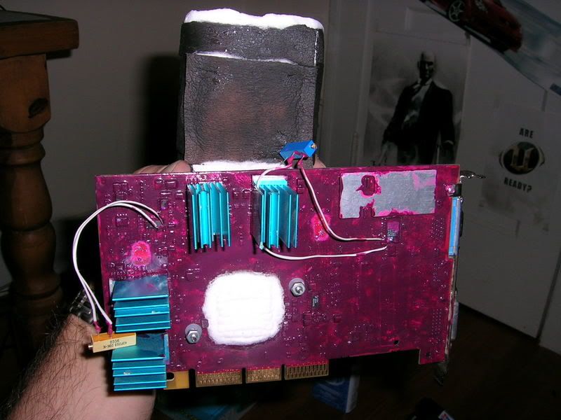

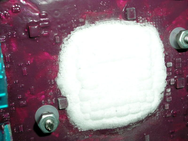

    The nail polish, once it dries, helps insulate. You can see I did the same thing to my 9700 Pro here, and even though it frosted over while benching, I had no probs:

    Some guys, instead of using nail polish, wrap the card/mobo/whatever in saran wrap, which seems to work fine.

    i did like the last way...cause its just for a few hours...and its very easy. i think i ll do that. Thanks a lot man! i m posting pictures in 1 or 2 weeks...wanna find out more information before doing it...here in Argentina playing with a mother or kinda...it s very crazy...150$ Dollars here it s a lot of money.

    But nail polish is easy to clean off, just use Acetone and it comes off no probs.

    Yeah if you're careful and don't splatter it all over the place, the Acetone will take it off just fine. Also try not to get it on any light-colored plastic (like a molex connector), it may stain the plastic. But on a PCB it will be ok.
