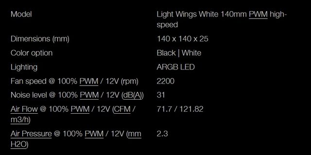

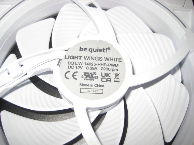

    As for the fans themselves, specifications vary depending on size and configuration. Our 140mm x 140mm x 25mm high-speed review models tout a 2,200RPM top speed, creating 71.7CFM airflow and air pressure of up to 2.3mm/H2O. A 4-pole fan motor and rifle bearing contribute to an estimated lifespan of 60,000 hours.

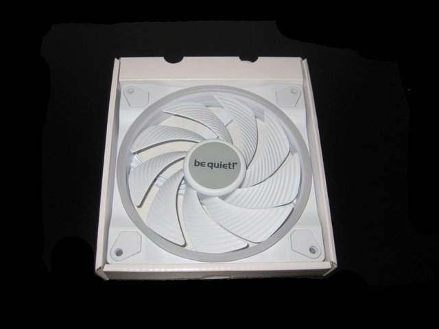

    The interior packaging is certainly of good quality with the fans nicely sandwiched within. It’s a small point, but it always speaks of a quality product when they’re nicely boxed both inside and out.

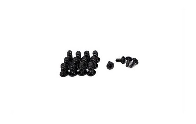

    Included are four classic black self-tapping screws and a quick manual.

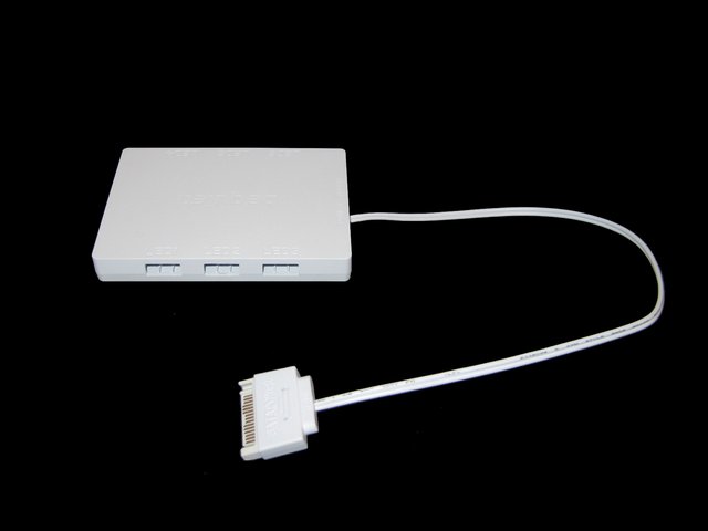

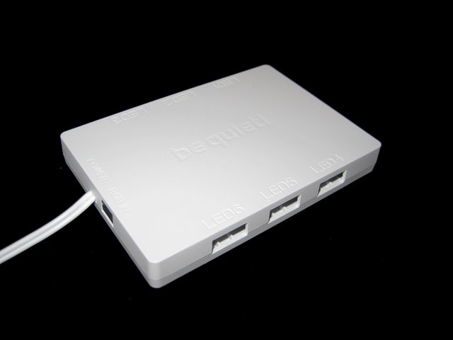

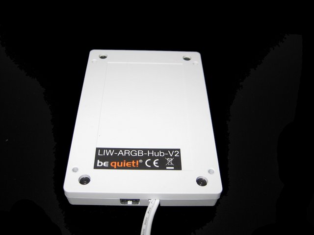

    With all triple packs be quiet! provides an A-RGB HUB to replicate the light effect provided by a 5V A-RGB source on up to six fans. The external measurements are the same as the 2.5″ drives but with a greater thickness (100 x 70 x 13 mm) and, thanks to the holes in the lower shell, it will therefore be possible to mount it on a common 2.5″ drive bay.
    The controller needs to be powered via the cable with sata connector (about 30cm long) already integrated in the HUB.

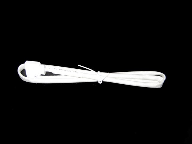

    The input of the light effect is instead provided via a cable about 50 cm long and embellished with a rubberized fabric protection: this must be connected to the HUB on one side and, using the 3-Pin 5V-DG connector on the other ends, to a dedicated A-RGB controller or A-RGB header in motherboards.overloading a single motherboard A-RGB header. Unfortunately, the controller only implements the multiplication function, not allowing the series connection of the devices. It will therefore not be possible to obtain light effects based on sequentiality.
    3M tape is included for sticking the aRGB hub wherever you see fit, and said hub can be screwed into a 2.5in SSD tray if you prefer.

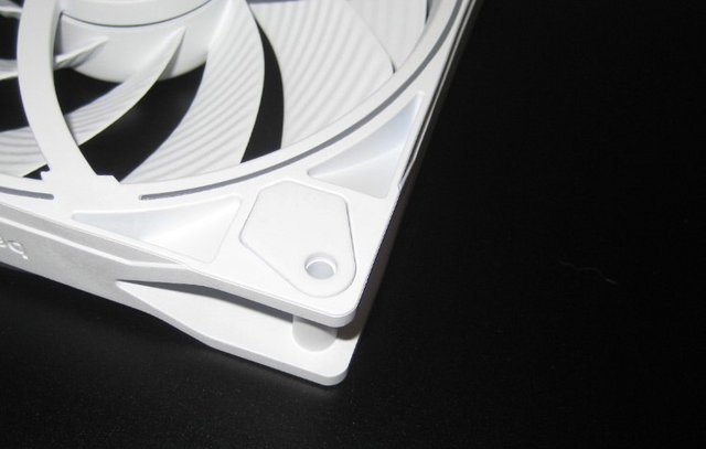

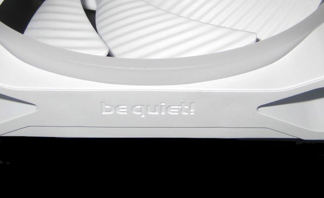

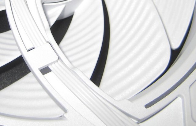

    be quiet! fans are easily disguisable by their unique blade design. Across both surfaces are a series of ribs that claim to increase efficiency and reduce turbulence which are important factors in a silent fan design. More detailed inspection will note a unique blade shape that increases the overall surface area and some interesting compression shapes where the blades come close to the outer ring. While we’re nitpicking, it’s a shame the be quiet! logo on the sides of each fan is in the same orientation, having one side in reverse would have made it easy to ensure upright branding irrespective of mounting position. The PWM High-Speed ​​Series features an impeller with nine closely spaced blades and a longer, inwardly curved design optimized for static pressure. In this version, developed for radiators and coolers, the maximum rotation speed is 2200 RPM.

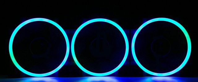

    What distinguishes the Light Wings from other fans be quiet! it is of course the large luminous ring on the front, made of semi-transparent white plastic, in contrast with the black frame and impeller. be quiet! it has even equipped the secondary side with backlighting (albeit more subdued), with a second thinner ring divided into 4 sections. This is a rare feature that will prove appreciable for example in push & pull configurations or for case installations. The lighting has brilliant colors, very bright and uniformly distributed over the entire main ring. Twenty Addressable-RGB LEDs are integrated, which have a maximum absorption of about about 0.64A (3.2W). Although not expressly indicated in the product specifications, the lighting is compatible with MSI Mystic Light Sync, ASRock Polychrome Sync, Asus Aura Sync, Gigabyte RGB Fusion and all devices using the A-RGB 5V standard with 3 connector -Pin 5V-DG.
    The fan frame is particularly robust, thanks to the considerable thickness of the walls of the internal neck (about 7 millimeters), which integrates the LEDs and the related circuitry. A solution that also required a reduction in the diameter of the impeller of about 10 millimeters, compared to the be quiet! models, without LEDs. Also ideal for installing fans on radiators using long screws that cross the frame from side to side.
    At the four corners there are white rubber decoupler pads, while in correspondence with the installation holes.
    The Light Wings adopt a rifle bearing type motor, capable of guaranteeing a minimum life of 60'000 hours.

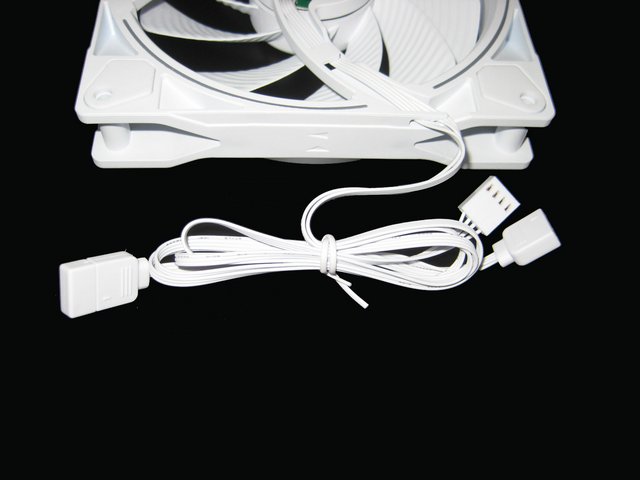

    The product comes with three connectors, the 4pin PWM power supply that is being used to supply power to the rotating fan and two more ports one male and one female 3-pin RGB headers that are being used with Addressable RGB lighting systems.
    The 3-pin header, which is 5V, can also be referred to as the “digital RGB header”, or “addressable RGB header” (DRGB, ARGB). This header uses separate pins for power, data and ground. ... When you send information through this pin, the first LED uses the first part of the data, then passes the right along and so on. Your motherboard should have 3 pin headers to use this kind of RGB.

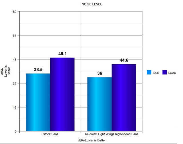

    Here are the results.
    The numbers are pretty much self-explanatory. be quiet! has delivered in plain and simple words.
    The system with the Stock fans on MasterLiquid Pro is evident. Switching the fans from the Stock fans to be quiet! Light Wings White 140mm PWM high-speed fans lowers noise output another notch.
