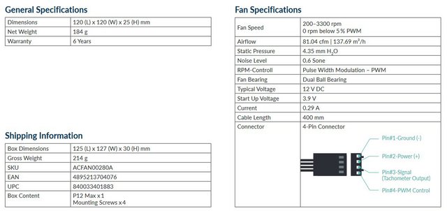

Arctic presented a successor to the P12 fan, or perhaps more likely a higher-end model of it, as the P12 Max is a bit more expensive. That’s because it has a significantly more sophisticated design that addresses the shortcomings of the P12. It discards RGB lighting and aesthetic content to focus purely and exclusively on giving us the highest performance. In particular, the P12 Max has stiffened blades to counteract the high vibration of Arctic’s 5-blade rotors, and also, it will be one of the most powerful 120mm fans due to its significantly increased speed. Offering PWM control for your dual ball bearing motor, they support up to 3300 RPM and zero RPM mode.
The airflow is supposed to be 137.69 m³/h. The stated static pressure is also high – 4.35 mm H20. These parameters, of course, correspond to the maximum speed at 3300 rpm.

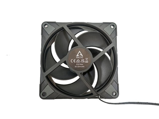

We start from a robust rigid plastic chassis with square frames in which the corners and retaining ring are integrated, all in black. The size of course is 120mm × 120mm × 25mm. It weighs 184g. The 40 cm cable has the typical plastic coating. Terminates in a 4-pin PWM connector. A sticker with the manufacturer's logo in the center of the rotor. The fan offers a total of five particularly wide and curved blades. It has a ring, meaning that the five blades that make up the fan are attached around it with the intention of better directing the air flow in the axial direction.
At the rear, clamping area consists of 4 small poles, and on one of them the cable is routed discreetly and almost invisibly until it exits around a corner. A sticker with the brand logo covering the rear of the rotor tells us that it works at 12V and 0.29A.
The corners have integrated rubber to dampen vibrations.
