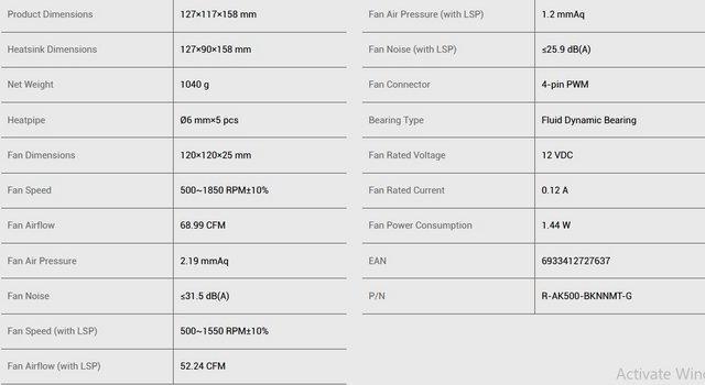

Here are the AK500’s specifications from DeepCool. Supporting platforms include AMD’s AM4 and AM5 while Intel’s are LGA20xx, 1200, 115x, and 1700.

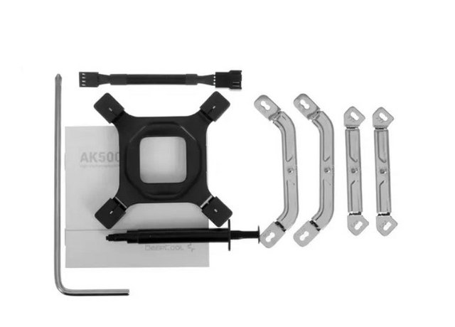

The kit includes a long Phillips screwdriver, four metal brackets, a set of socket screws, a reinforcing plate, a step-down fan adapter, a tube of thermal paste, and instructions with a diagram for assembling. While the AK500 only includes one fan, DeepCool has included an extra pair of fan clips for enthusiasts who want to add a second fan for maximum cooling performance.

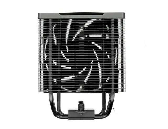

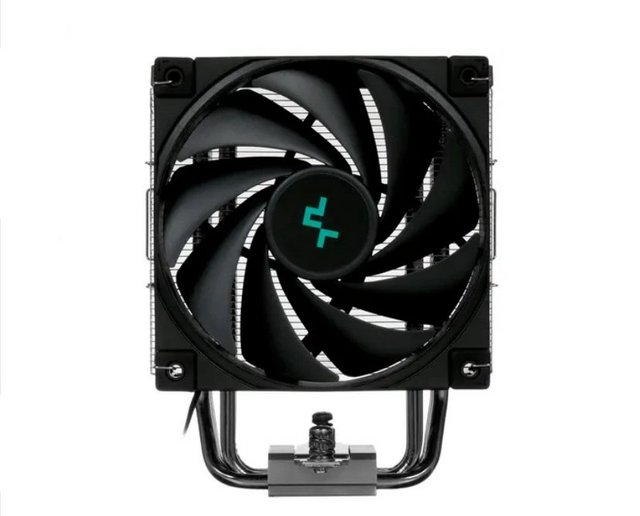

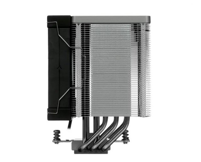

The overall side view of the radiator. Looking at it, you can see that the width is quite thick, and the depth of removing the fan cooling fins reaches 90mm. The side adopts the buckle fin process and the folding fin process to form a certain guarantee in terms of firmness and anti-deformation.
The front of the radiator body is flat design.

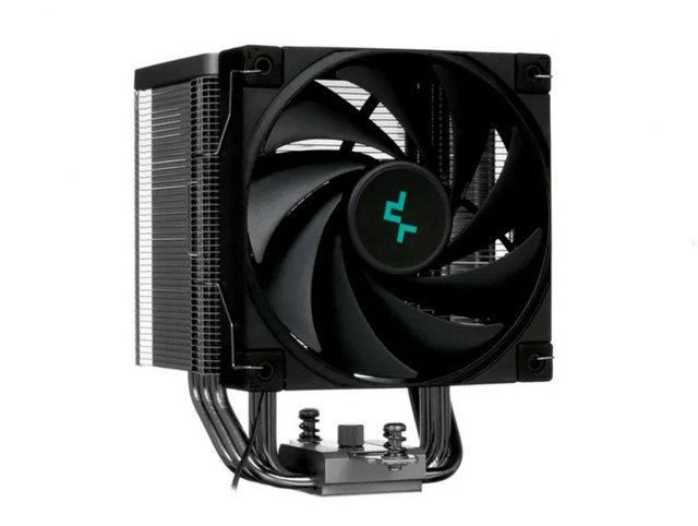

AK500 measures 127mm (W) × 117mm (D) × 158mm (H) and weighs a considerable 1,040g. The angled offset heat pipe design allows clear access to the DIMM slots for better compatibility. There are five 6mm composite heat pipes.
On one side, the edge of the plates is even, on the other side with cutouts in a checkerboard pattern. This reduces the resistance to air flow, increases the efficiency of blowing and reduces noise.

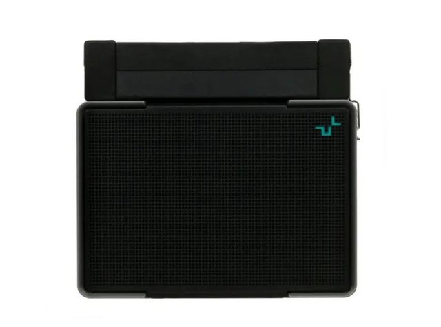

The top plate has a pattern reminiscent of a checkerboard with the DeepCool logo on the bottom right. Much like the overall design, it is simple, clean, and somewhat elegant. You won't find ARGB lighting or anything of the sort here. Only the DeepCool logo in teal adds a touch of color to an otherwise neutral aesthetic.
The decorative plate is detachable.

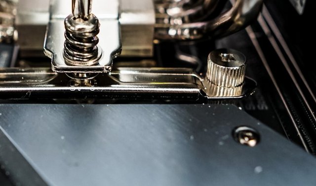

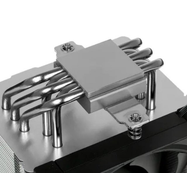

Removing the decorative panel consisting of a silver base. It expose a hidden channel used during installation to tighten one of the spring-loaded screws.
Copper nickel-plated tubes are distributed along the entire width of the contact plate. The included metal mounting bracket has been optimized to ensure proper contact on the latest Intel and AMD platforms. Here the base is an all-metal sole. Its surface is smooth and well polished.

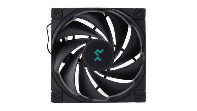

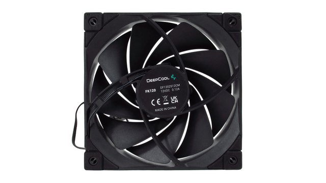

The fan used for the AK500 is DeepCool's FK120 with model number DF1202512CM. It has a PWM RPM range of 500–1850 with a CFM rating of 68.99.

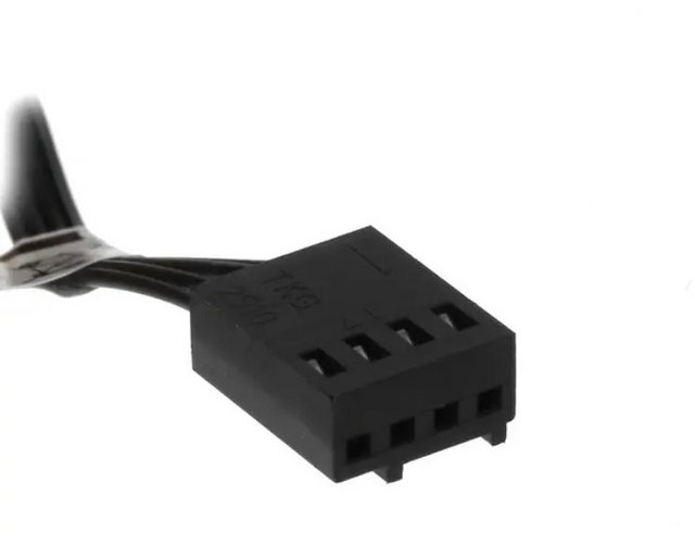

The 4-pin fan header connects to the connector on the motherboard. If for some reason you can’t hook the fan to a PWM header, an included low-speed adapter lowers airflow to 52.24CFM.
As for the design itself, it uses a solid square frame with the hub of 9 fan blades, and FDB bearings are used.
Its body is made of black plastic with a matte finish. Vibration-dampening rubber corners around the edges.

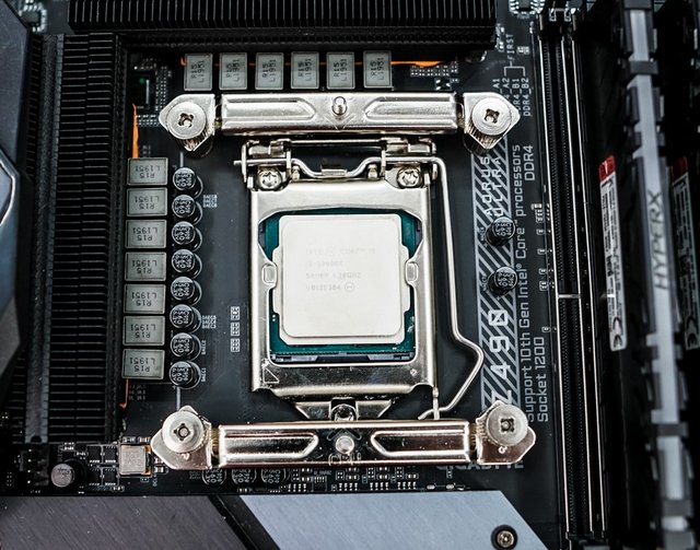

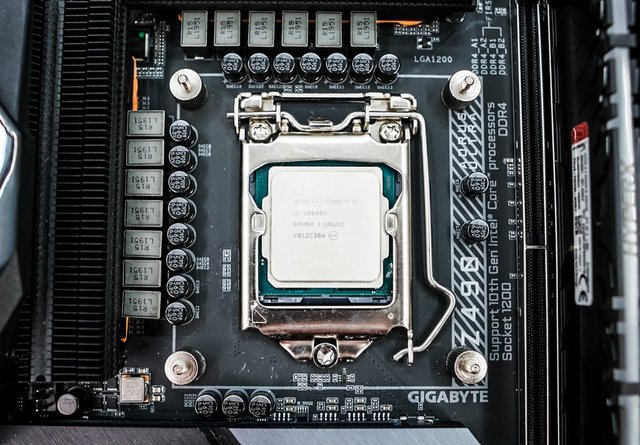

Installation of this cooler is pretty easy and I have to say the instructions DeepCool provides are some of the easiest to understand and follow. We will be doing our installation on an Intel Z490 system so this installation would be pretty much the same for Intel LGA 1200, 1150, 1151, and 1155 sockets. The first thing you are going to want to do is find the Intel backplate and attach it through the backside of your motherboard holding it into place with the included Intel standoffs. Here is the backplate on the back of the motherboard. The 4 corners can be adjusted to be compatible with the sockets of Intel CPUs in various ways by adjusting the locks on all 4 corners.
Next install the Intel mounting bars, securing them in place with the included thumbscrews.
These bars need to be installed on the top and bottom of the socket if you want air coming in from the front of your case and being exhausted out of the back.

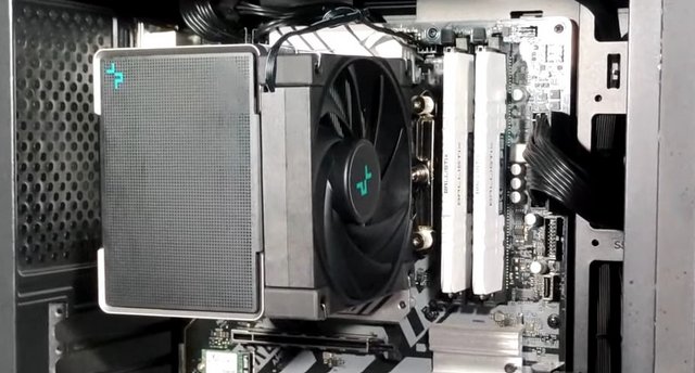

Now reinstall your fan. It can easily be installed from the top of the cooler if you happened to install the cooler while your system was in a case. You can see that even with the fan installed we still have clearance for normal-sized memory.
With our system back in our case we can see that the cooler does have a pretty big footprint, but as I said earlier it is not massive. There still is more than enough clearance for our graphics card and at only 158mm tall the cooler should not interfere with side panels on most cases.

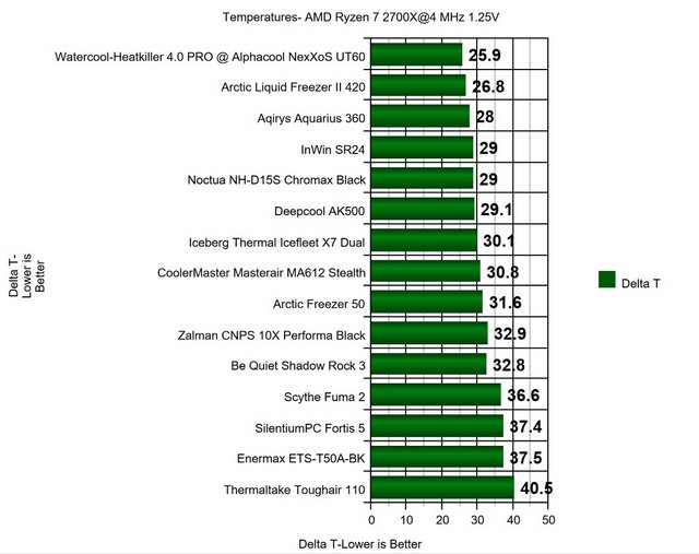

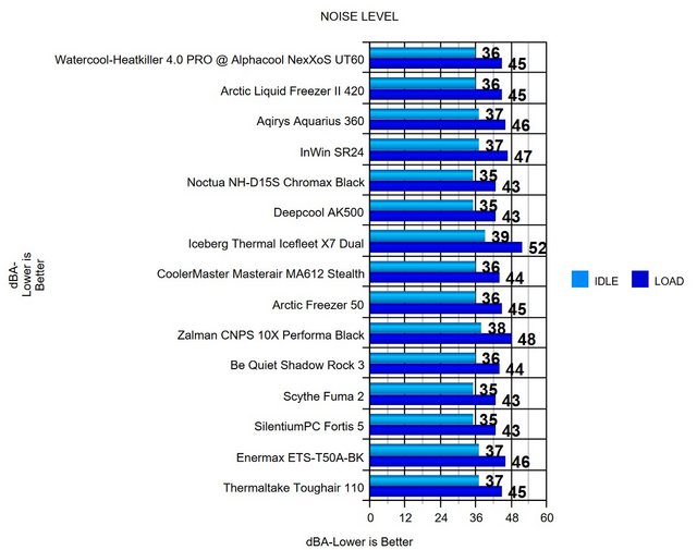

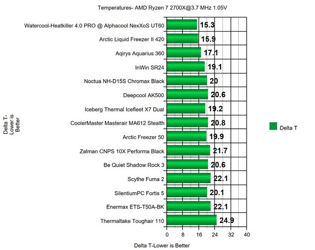

The tests are carried out with an AMD Ryzen 7 2700X processor installed on an ASUS TUF Gaming B550M-PLUS (WI-FI) motherboard . The processor is locked at 3700 MHz on all its cores with a Vcore at 1.05 V at first, then it goes to 4000 MHz / 1.25 V and finally 4200 MHz / 1.35 V. Temperatures are retrieved with HWiNFO , while the processor is loaded with RealBench for thirty minutes. Finally, the noise pollution measurement is taken 12 cm behind the radiator in a room measured at 29.6 dB(A).
Right out of the gates, Deepcool moves towards the front of the field. At 20.6 Delta, it lands Deepcool and the AK500 in eighth place overall, yet it is one of the top air cooling solution in the chart. With a 0.6 degree gap to the NH-D15S, it isn't the largest of margins. While not amazingly better, comparing MSRPs puts Deepcool well into the lead over Cooler Master and Noctua.
Adding more speed and voltage, delivering more heat to the AK500 was of little consequence regarding how well it performs. Still landing in six seems as if it could have been better, but again, Deepcool takes top honors for air cooling of a CPU in our charts. The difference to the big-named options increased slightly, favoring Deepcool and this AK500 over many high-end, high-priced solutions.
This is where the Deepcool AK500 performs impressively. That it beats the Arctic Freezer 50 is no surprise, but it even beats the much more expensive Cooler Master MasterAir MA612 Stealth performance-wise while remaining decently quiet at medium fan speeds.
This fan at stock levels is some of the most silent fan I have used with a 35dB rating at roughly 500 RPM. I had to take the reading a couple of times and I even changed the battery of the measuring device to be sure the 35dB rating I was getting was in fact correct for this fan. Even with full power to the FK120 PWM fan, it is barely audible, and you have to be within a foot or two to even hear it.
