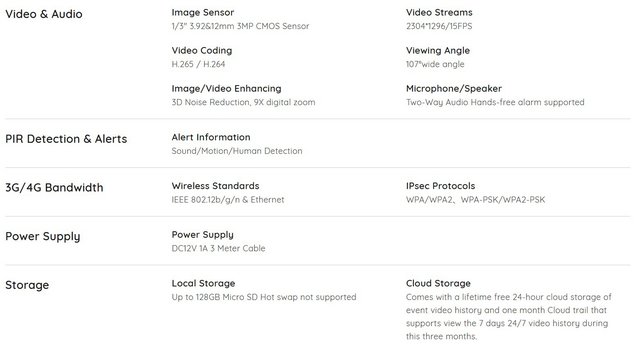

    Let’s start with the bare data of the Blurams S21C:

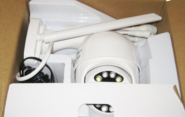

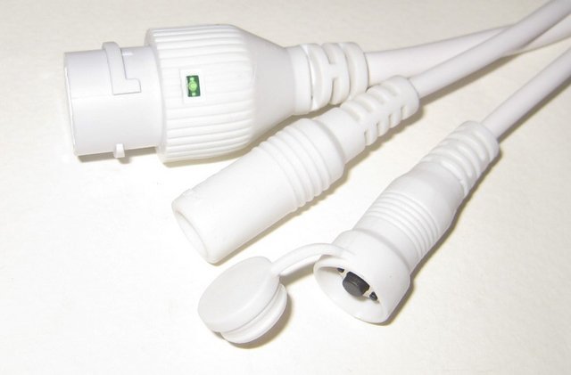

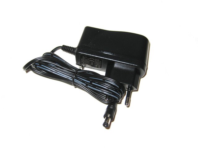

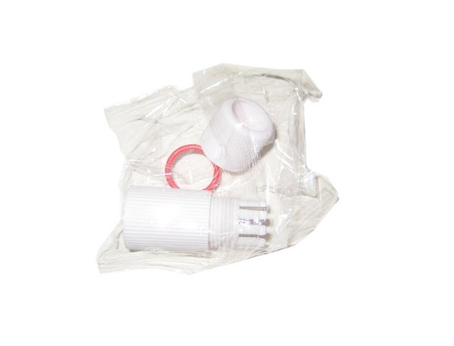

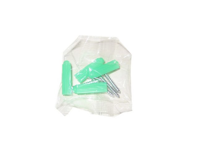

    Inside the box, you will find a power adapter, a waterproof cover for the ethernet cable, user manual, installation precautions leaflet, screws, and dowels. To record footage without the use the paid Cloud subscription, you’ll need to purchase a micro SD card in addition to the package shown above.

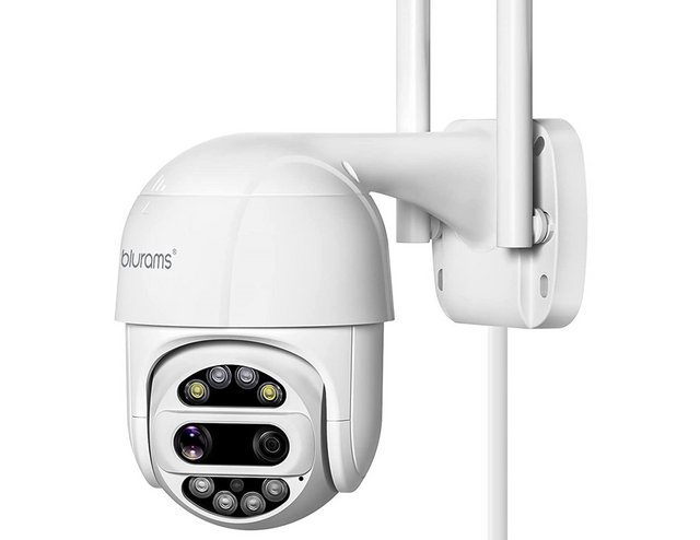

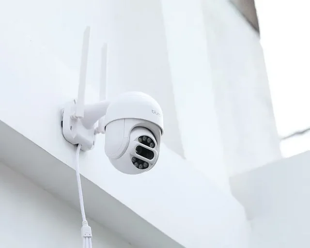

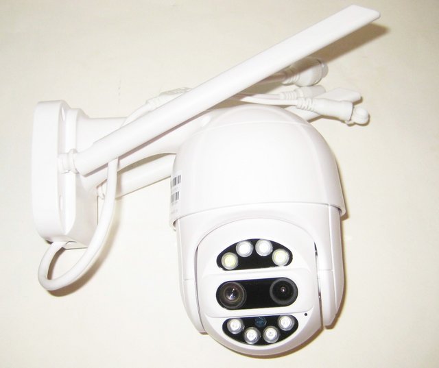

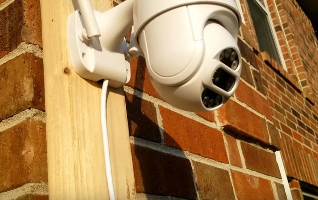

    The Blurams S21C has a futuristic appearance, which is the first thing we noticed about it. It looks like it could be a droid from one of the Star Wars movies. The housing is coated in white, which makes it easy to spot even from a distance. This high-visibility design is meant to deter potential burglars before they strike. It is a large camera in dimensions. On the front of the camera is a blurams logo. The Blurams PTZ Dual-Lens Outdoor Cam attaches to the side of your home with two antennas and must be constantly plugged into power, as is the case with most DVR-style security cameras. It sports an IP66 weather-resistant frame that helps it survive the elements.
    You can also use the camera with Wi-Fi or Ethernet for an internet connection.
    The lens housing itself is egg-shaped, and hangs down from the end of the wall bracket. It’s positioned within a motorized bracket that allows it to swivel and pivot. It moves its head horizontally (360º) and vertically (107º) to monitor everything around the premises.

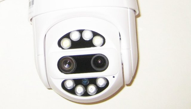

    It has a round camera module, with the lens surrounded by two white and six IR LEDs to work during the night. You can choose which one you want to use to illuminate dark areas. The White LEDs illuminate the area with visible light, which is very useful to scare people who approach your premises, while the IR LEDs work with a spectrum of light that is not visible to the naked eye, so only the camera can see in the dark.

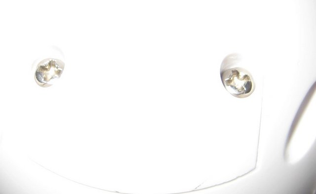

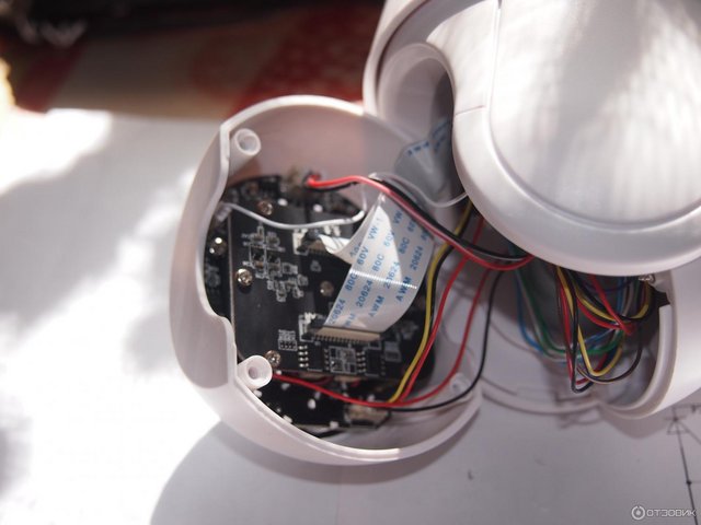

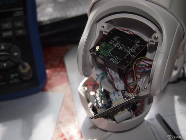

    The boards are assembled with high quality, there are almost no traces of flux.

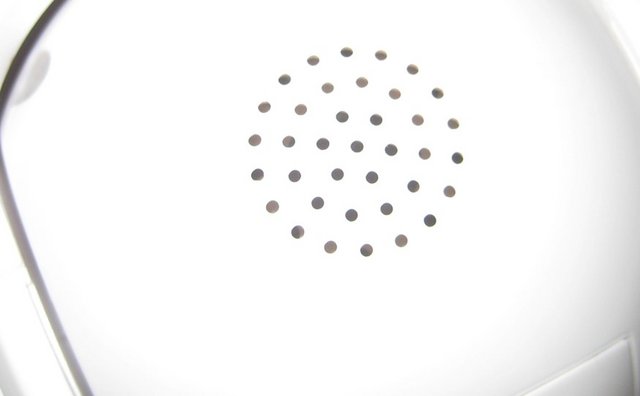

    The camera has a microphone and a speaker to allow bi-directional audio communication, so it's possible to hear the sounds around the camera and speak to someone close to it.

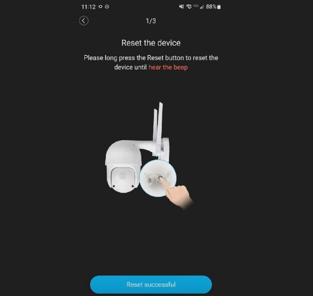

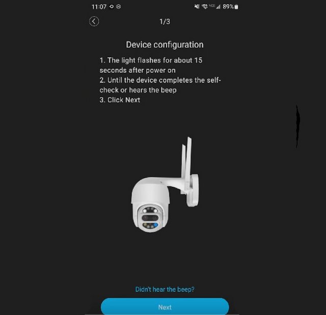

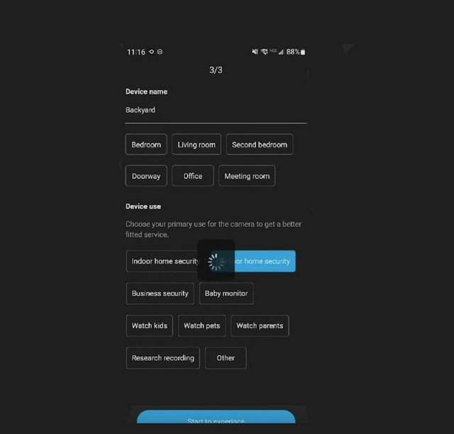

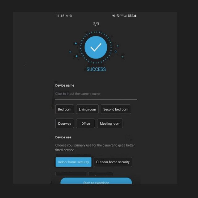

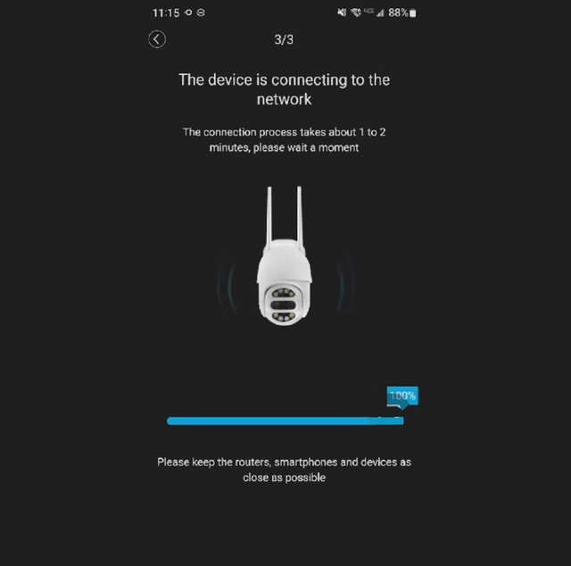

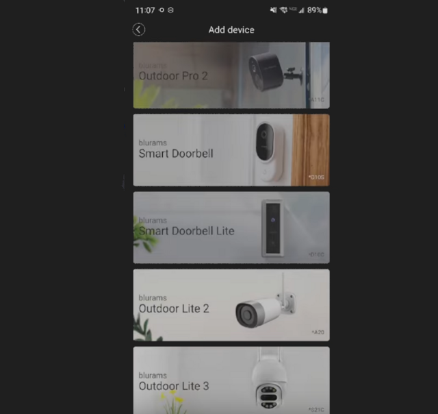

    The setup is simple. The camera depends on a wire for power, so placement will be dictated by access to an electrical outlet. It comes with a six-foot cord, so you have some flexibility. The setup isn’t difficult: You register a new account or log in to an existing one, and then tap a plus-sign icon to add the camera.
    You’ll be prompted to login to your Wi-Fi, then point an onscreen QR code at the camera’s lens for scanning. Even with a required firmware update, I had the S21C connected in just a few minutes.

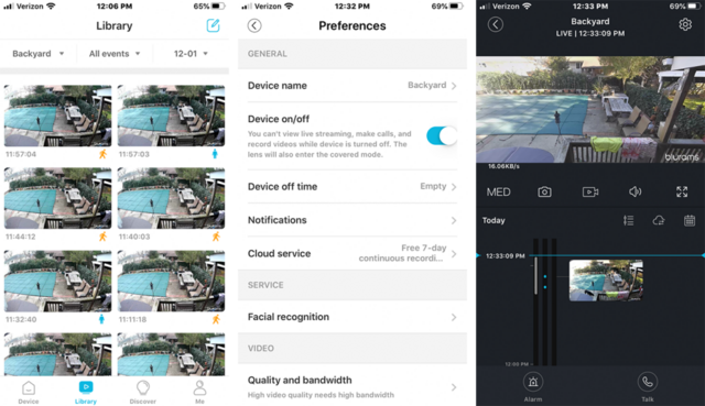

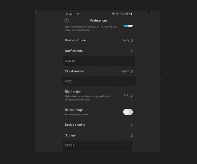

    You can manage its preferences.

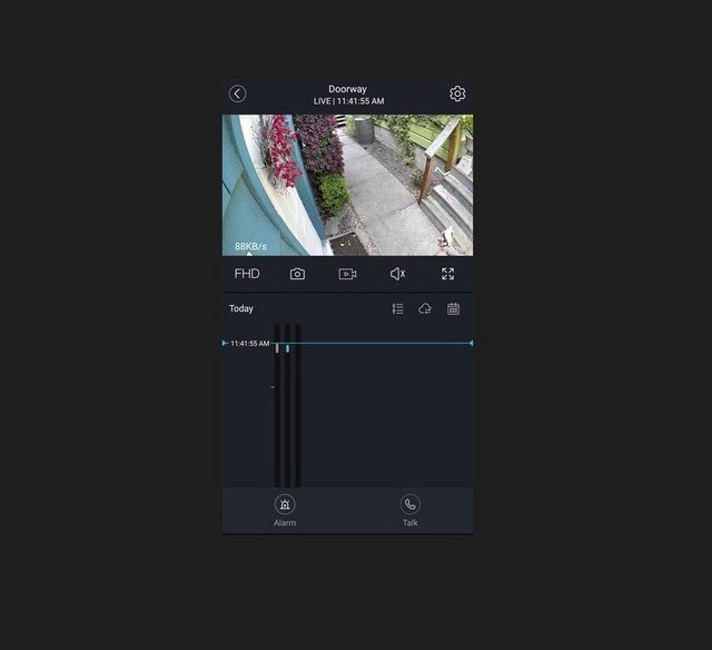

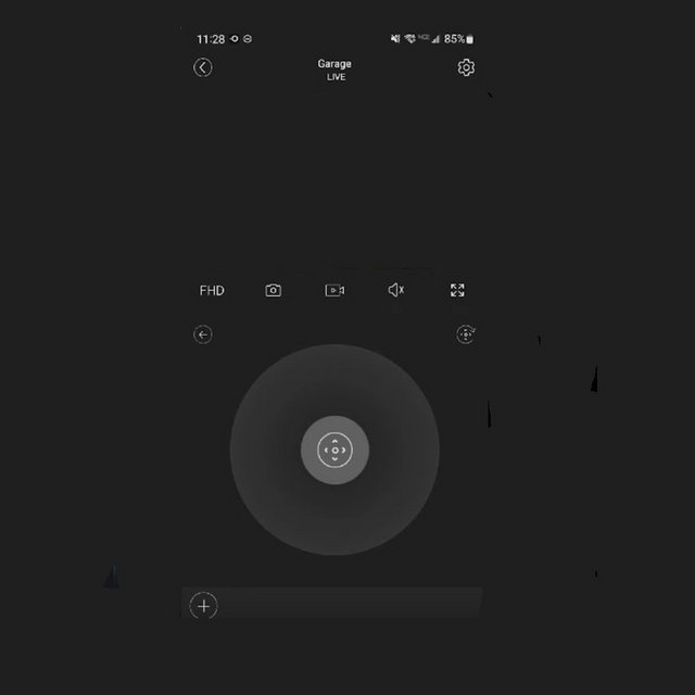

    The app provides basic camera controls from the live feed screen. Here you can record video on demand, take screenshots, use two-way talk and trigger the siren-and-light alarm. It also lets you easily switch between videos stored locally and in the cloud.
    The 4 arrows for controlling the pan/tilt characteristic are self-explanatory, however you’ll want to determine what the remainder of the icons do by yourself.

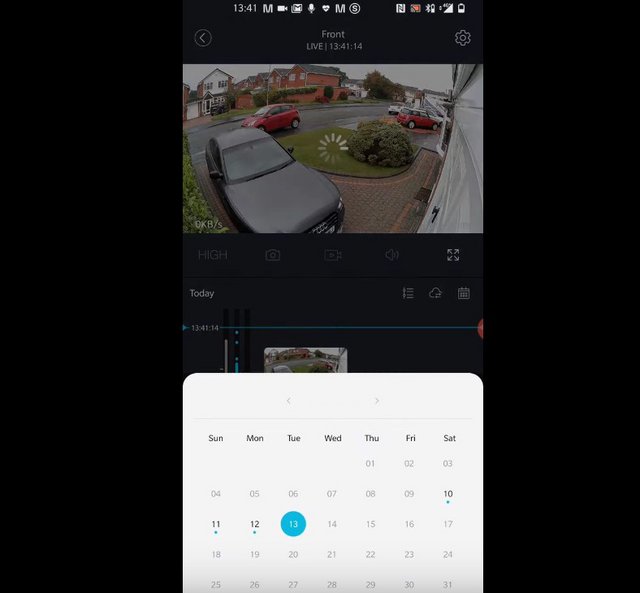

    Below the live stream panel is a scrolling timeline of all recorded events with video thumbnails. Scroll down to find a video for a specific time period. You can also use the calendar function to find videos from specific days. At the very bottom of the screen are Alarm and Talk buttons. Tapping the Alarm button sets off the siren and the flashing strobe light, and tapping the Talk button initiates two-way audio.

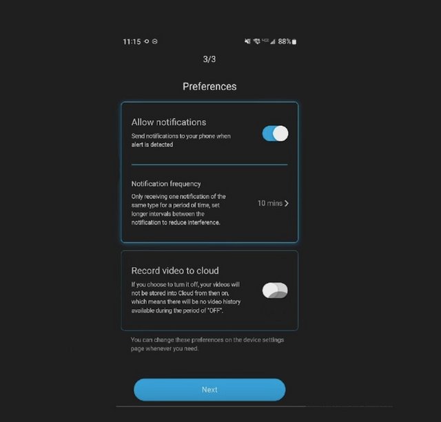

    To access all of your recorded videos, tap the Library button at the bottom of the home screen. Here you’ll find thumbnails of all video clips by date. Tap a thumbnail to view the video, share it, save it, or download it. Motion detection can be further customized by masking in activity zones for the camera to monitor exclusively. Beyond these individual settings, you can reduce alert frequency universally by customizing the delivery intervals—you can receive notifications of a similar type anywhere from one minute to one hour apart—or schedule a time block during which the camera won’t send you any notifications at all.

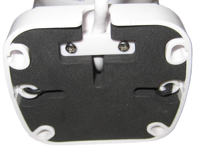

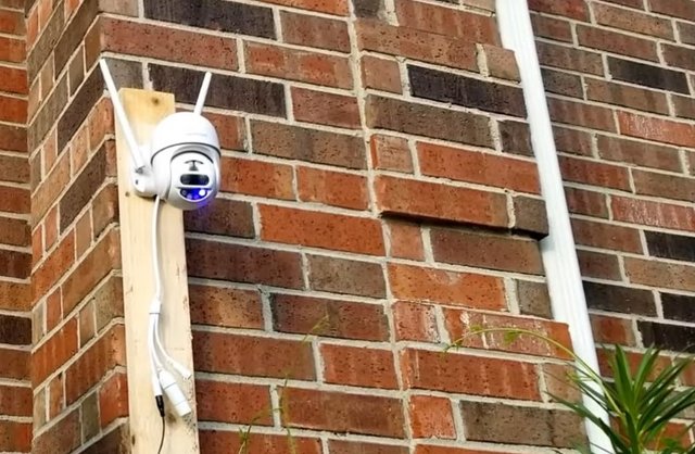

    Installation of this camera was what I expected, 4 screws into a wall or other solid surface and a power (+ ethernet connection if not using WiFi) then you’re done.

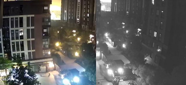

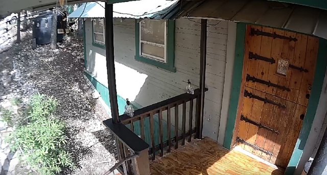

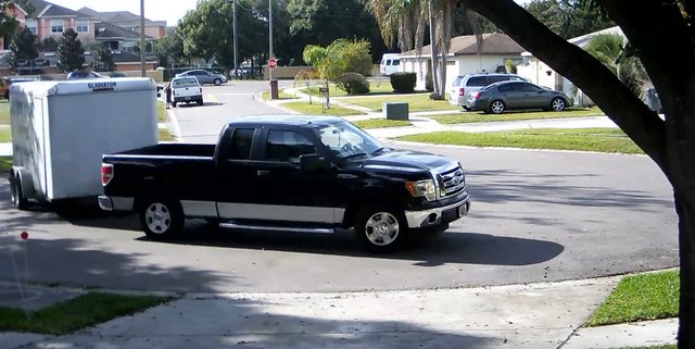

    With any security camera, video quality is an overriding concern. At the end of the day, nothing else matters if you can’t actually see. As a result, this is a major factor in finding the best camera. The Blurams S21C does not disappoint in this regard. It records in 2K, both by day and by night. Admittedly, this isn’t quite as impressive as the 4K performance of some security cameras. But for most purposes, that isn’t necessary. 2K is far crisper than 1080p security footage, and makes it easy to identify people. Unless you need to read a license plate at very long range, 4K just doesn’t add much value.
    The most attractive feature of the S21C is the ability to pivot and swivel the camera. The housing can rotate 360 degrees horizontally and 107 degrees vertically. Considering the fact that it’s presumably mounted on a wall, it will have total coverage of the area. This is a huge benefit, since you can use a single camera to monitor a larger area. Of course, you’ll only be able to look in one direction at a time, so the applications are somewhat limited.
    PTZ works on third-party programs. In addition to being able to pan and swivel the camera, it also supports 9x digital zoom. This is not the same as a true optical zoom. The resolution will not improve as you zoom in. That said, it does make the video look bigger on your screen. Again, the applications are somewhat limited, but it’s better to have zoom than not.
    At night, the infrared bulbs will illuminate up to 32 feet. The 2-color bulbs are invisible to the naked eye, but are highly effective for the camera’s purposes. Even in total darkness, you’ll get full color video that’s far superior to most night vision systems. The built-in motion sensor uses passive infrared technology to reduce false alarms. This technology will only pick up large objects in motion, within a 107-degree area. It will spot people just fine, but it won’t trigger because of pets or blowing debris. This is a huge benefit, since the S21C works based on motion detection. It saves batteries and storage space by only recording when the motion detector is tripped. The more accurate the motion detection, the better results you’ll get, and the motion detection is excellent.
