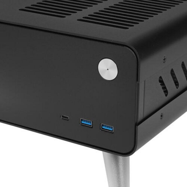

    Τhe height of the stand is 64 mm, which is higher than the existing cases. There is enough space to slide the keyboard in like a monitor stand, and it is designed to allow smooth airflow through perforations in several parts of the chassis. It has a large round power button with led on it to the front right top and beneath that there are 2 USB 3.0 (USB 3.2 Gen 1) and 1 USB 3.0 (USB 3.2 Gen 1) Type C ports. I was really happy to see the Type-C connection, not enough cases are including them. The Raijintek logo etched into it in the bottom left corner. Unfortunately there isn't any audio port in the front.

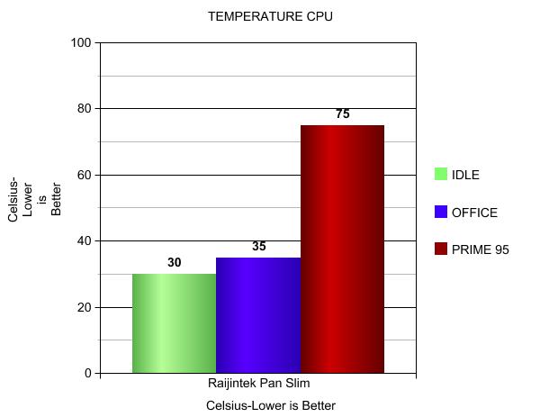

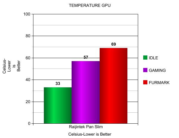

    We use Prime95 to determine the temperature of the processor. We let the CPU load tool run for 15 minutes. We monitor the values ​​of the individual sensors via HWinfo64.
    Performance
    Putting our components into Pan Slim was easy enough, but the real question is whether or not the fanless chassis can cool our hardware during demanding workloads. Our AMD RYZEN 5 3600 cpu kicks out plenty of heat, but in partnership with an 240mm AIO, Pan Slim has no trouble keeping core temperature to an acceptable level. There is a good airflow in the case. This is attested by the temperatures, which are a maximum of 75C.
    The GeForce GTX1060 was always going to pose the bigger challenge, but Pan Slim once again does quite well for a fanless solution and the GPU didn't exceed 57C when gaming. The graphics card area seems to be adequately supplied with air.
