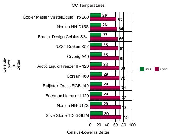

    Our first test will be Stock Idle test. This is taken on the Windows desktop an hour after initial boot up. During the idle tests, the Arctic Liquid Freezer II - 120 proved to be very efficient. While things do get a little warmer when overclocked the Arctic Liquid Freezer II - 120 again performs excellently well. It does admittedly struggle a little more than it does when under a standard processor setting, but even so, this cooler proves itself more than competent at overclocking and even capable of competing with much more expensive 240mm AIO cooler options.
    Once the cooler was placed under OC, the Liquid Freezer II - 120 began to show its Arctic heritage. Arctic's Liquid Freezer II - 120 doesn't deliver the lowest temperature, but that's no bad thing as the it strikes an admirable balance between heat and noise. If we look at these results the Liquid Freezer II - 120 is pretty much on par with Cryorig's A40, which is a 240 mm cooler.
