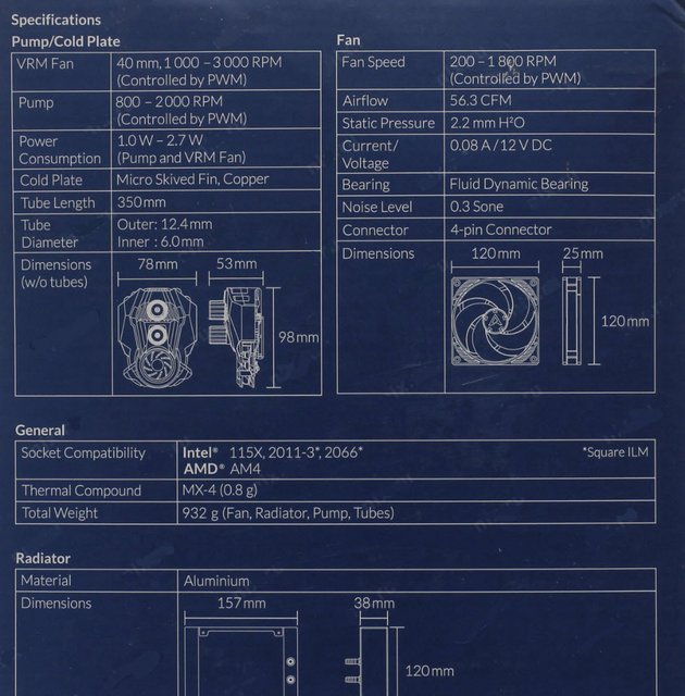

    The left-hand side of the box shows what Arctic call a function diagram detailing the various components of the cooler, with full specification and dimensions above.

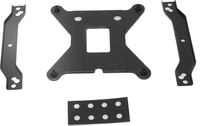

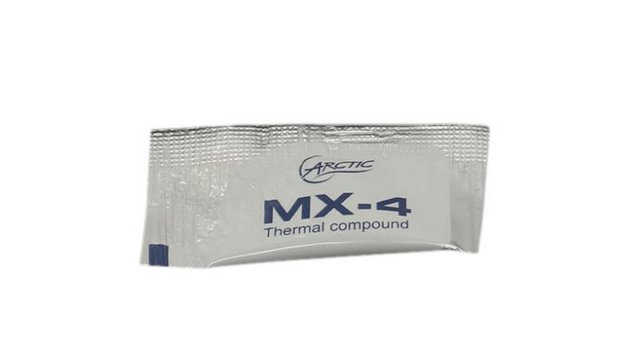

    The scope of delivery also includes backplate, two metal plates, screws for mounting on an Intel/AMD and some MX4 thermal paste.

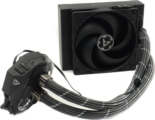

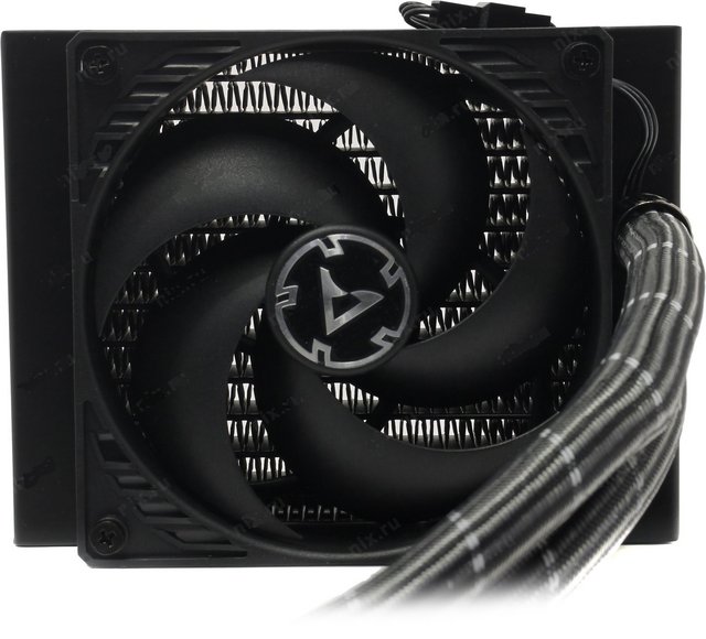

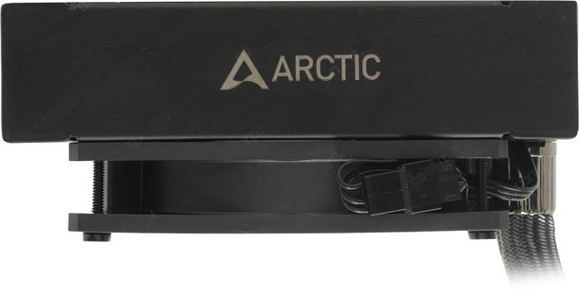

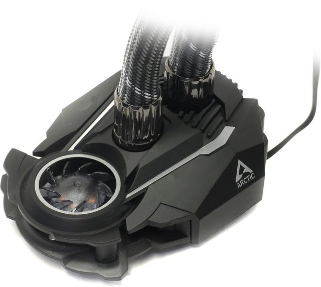

    The Liquid Freezer II cooler come with an almost all-black design and a radiator with a clean "square" design. The overall design of the pump/block/fan combo looks like batmobile. The fan arrive pre-installed to the radiator in a push configuration so will save the end-user time during installation if this is their desired configuration. It comes filled with coolant from the factory so even those with the most basic skills needn't fuss with initial setup. Essentially all one needs to do to install is mount the radiator and cooler and plug in. The system, with this configuration, does not require maintenance by the user and is guaranteed for a total of 2 years.

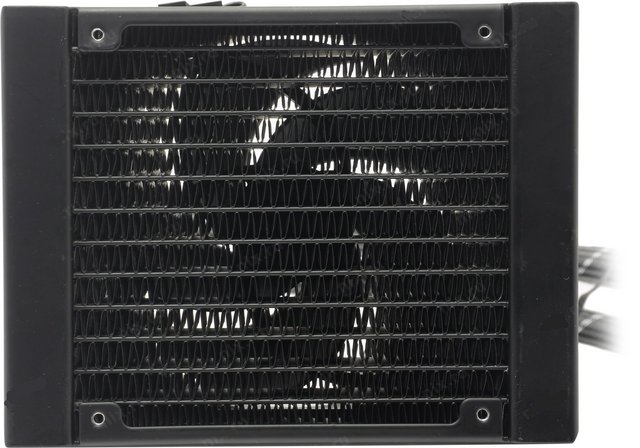

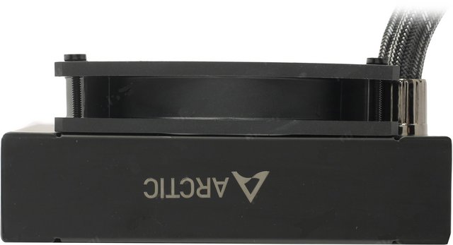

    The radiator is 38 mm thick. This additional thickness does improve the cooling potential of the AIO.
    An Arctic A logo is applied the top and bottom edges of the radiator.

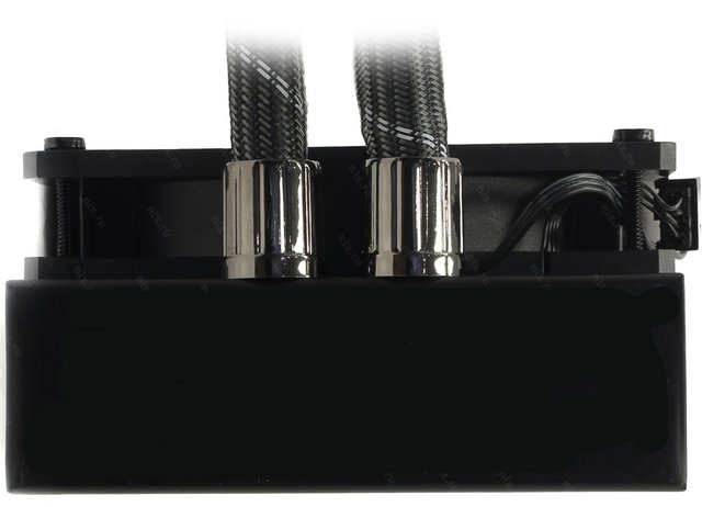

    The radiator's tubing is approximately 450 mm long. The outer diameter of the tubes is 12.4mm, the inner diameter is 6mm. The braided coolant hoses to the CPU block come with silver striping. On either ends of the tubing are high-quality metal fittings with a black chrome look.
    The Arctic P12 120mm fan on the unit come with PWM control, which allows it to run at speeds down to just 200 RPM, and all the way up to 1800 RPM when required.

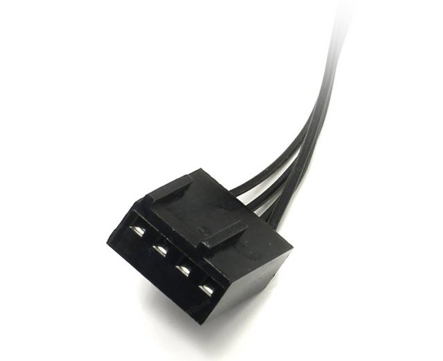

    The PWM-cable of the fan is integrated into the sleeveless tubing. Here is the single 4-pin cable from the pump which must be connected to the motherboard fan header.
    The Liquid Freezer II Series features an all-new, in-house developed PWM-controlled pump for improved efficiency, low power usage, and quiet operation. Unlike most pumps, which run at full load even when idle, ARCTIC's pump is able to slow down and reduce noise even further when not under heavy loads. The CPU block is made of plastic, and there's the manufacturer's logo on it. The pump has a working frequency between 800 and 2000rpm. Most notably, however, the CPU block comes with a small 40mm fan, which will provide some airflow to the components surrounding the CPU socket. This fan can spin at speeds between 1000 and 3000 RPM through PWM control. This area typically sees very little airflow on other liquid cooling systems. Cooling to this area isn't strictly necessary, as case airflow and passive convection for heat dissipation is often just enough. Any motherboard that generates too much heat in the VRM areas will often come with some small heatsinks to aid this process. Nevertheless, some added cooling here certainly can't hurt anything aside from noise levels.

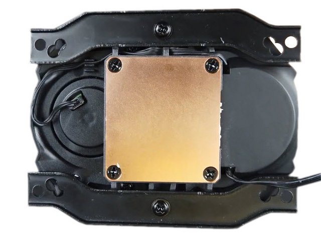

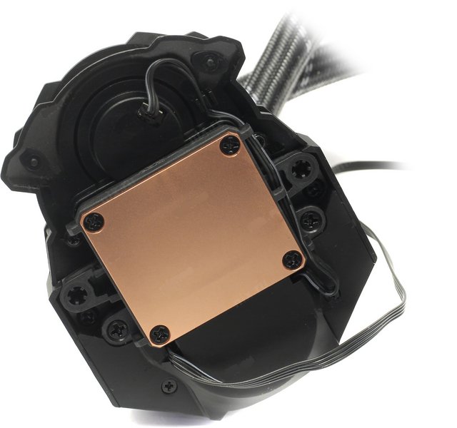

    The water block has a copper base, with dimensions of 98 mm (L) x 78 mm (W) x 53 mm (H). The base of the block does not have a mirror finish.

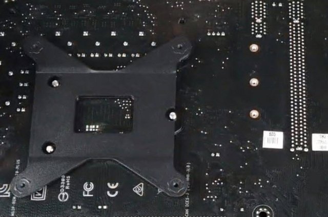

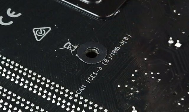

    When installing the Liquid Freezer II, users will need to first prepare the backplate. Slide the screws into the right slot on the backplate to then use the washers to secure them. At this point, you can position the backplate on the motherboard.
    Next, use the washers and standoffs to secure the backplate to the motherboard.
    Then secure the mounting arms to the standoffs.

    The final and easy bit is to plug it into the fan header. That's it, all done.

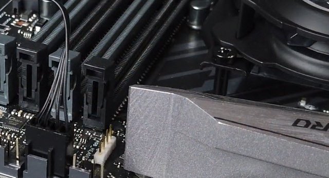

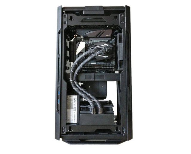

    Thanks to its flat design and compact pump, the Liquid Freezer II fits into many cases and offers optimal RAM compatibility, even for modules with larger heatsinks.

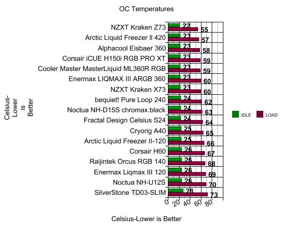

    Temperature

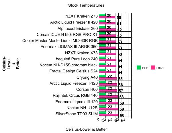

    Our first test will be Stock Idle test. This is taken on the Windows desktop an hour after initial boot up. During the idle tests, the Arctic Liquid Freezer II - 120 proved to be very efficient. While things do get a little warmer when overclocked the Arctic Liquid Freezer II - 120 again performs excellently well. It does admittedly struggle a little more than it does when under a standard processor setting, but even so, this cooler proves itself more than competent at overclocking and even capable of competing with much more expensive 240mm AIO cooler options.
    Once the cooler was placed under OC, the Liquid Freezer II - 120 began to show its Arctic heritage. Arctic's Liquid Freezer II - 120 doesn't deliver the lowest temperature, but that's no bad thing as the it strikes an admirable balance between heat and noise. If we look at these results the Liquid Freezer II - 120 is pretty much on par with Cryorig's A40, which is a 240 mm cooler.
    Noise Level

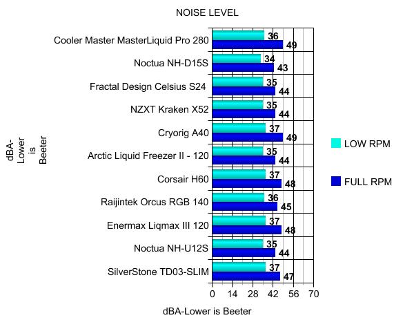

    I couldn't do all of this testing without taking a look at the overall noise output of each of the coolers right? The Liquid Freezer II - 120 combines cool temperatures and low noise.

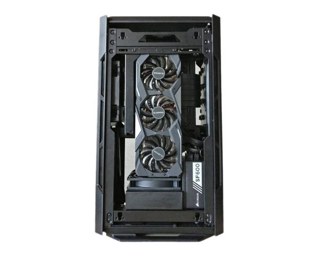

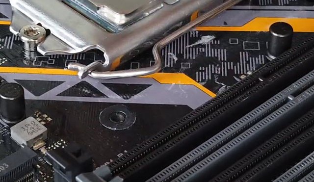

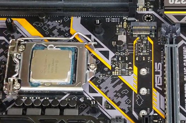

    I really can't tell from your pics what the actual orientation of your case is but if the normal orientation is like the top pic or even the bottom pic it may impact results. If thats the top view in pic 1 also may impact results.

    The Chassis on test is Dimastech Bench Table Easy V2.5.
    The pic on Phanteks Evolv Shift Air Mini ITX Tower Case was taken in order to see that it fit on mini-ITX cases without clearance problems.
