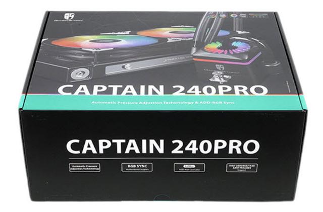

    The Deepcool Gamer Storm Captain 240 Pro ships in a dark box with unmissable RGB accents - welcome to 2019! The front of the box showcases a large image of the cooler and its unique pump.

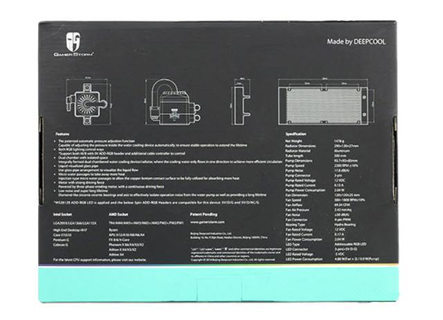

    The back has a diagram showing the pump and the radiator measurements so users can assess whether it will fit in their system.
    The left side shows a few of the cooler's features, such as its 120,000 MTBF, FDB fan bearings and powerful motors. The right side is the same as the left. The bottom is much the same as the right and left sides. It's not until you get to the top of the box that you find a short list of the cooler's features and some more specifications.

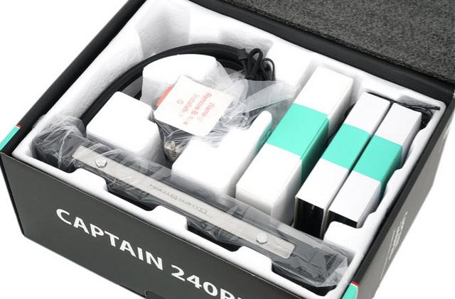

    Inside, the contents of the package are compartmentalized in a recycled cardboard cradle and further wrapped in plastic individually. Suffice it to say that Deepcool's packaging is, once again, more than adequate as it does provide the necessary protection the product needs.

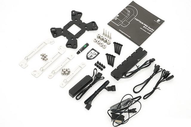

    Components include: 8 long screws for fixing the fan, 8 case fixing screws, 4 back plate, 4 fixing screws, nut A 4, nut B 4, thermal compound, ADD-RGB Controller, ADD-RGB extension cable Type-A, ADD-RGB extension cable Type-B, RGB hub, cooling fan hub, fan extension line, 3 brackets, 4 LGA 20xx bolts and 4 TR4 bolts. There are quite a few cables for connecting and controlling the fans, and CPU blocks LEDs.The Gamer Storm Captain 240 Pro also boasts support for all major motherboard lighting software packs, Asus Aura Sync, Gigabyte RGB fusion, MSI's Mystic lighting Sync, and ASRock's Polychrome Sync. Deepcool comes with a new built-in PWM fan hub. The size has been changed to be slimmer than the existing hub. RGB hubs are also built in to allow connection of up to five ADD RGB pinheaders.

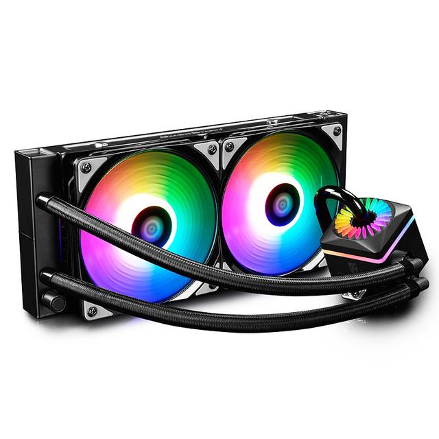

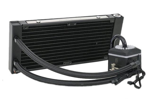

    The 240mm standard radiator is made of aluminum. The integrated dual-chamber water cooling device/radiator is where cooling water flows in only one direction to achieve more efficient circulation. The tube is made of fluorinated ethylene propylene material to enhance the durability. The expander that surrounds the tube is finely finished so that the inside does not shine through the triple coating.

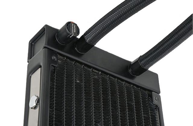

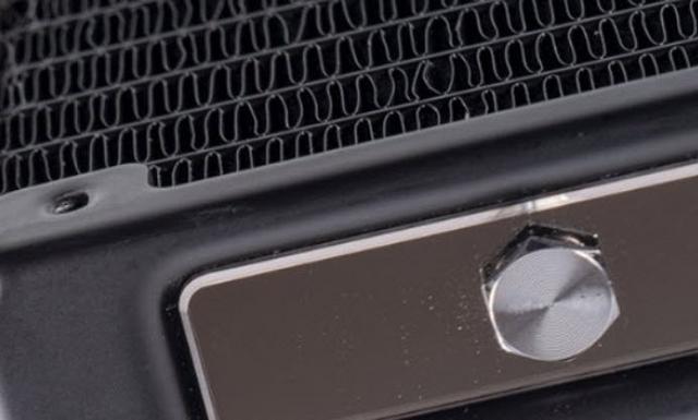

    The Gamer Storm Captain 240 PRO's shape and design are mostly integrated into the previous generation's captain 240RGB, but a pressure relief valve and a metal nameplate have been added to the cold row.
    The automatic pressure relief valve, which is one of the biggest upgrade highlights of the Captain 240PRO, incorporates a patented automatic pressure regulation technology that claims to achieve zero leakage. The pressure valve may be the gas that evaporates from the original water-cooled liquid, which may be seen in the split water cooling.
    Inside the radiator, an elastic pressure-relief bag will be added with one side exposed to the air and the other side dipped in the coolant. When the internal pressure exceeds atmospheric pressures, the bag will be squeezed and thereby increases the system’s internal volume. As a result, the increased pressure is released and the risk of leakage is avoided.
    Although the liquid cooling radiator features low noise, high radiation efficiency and other advantages, its potential safety hazards shouldn’t be ignored. While the cooler is working, the coolant’s temperature rises, so will the volume expand. Sometimes gas can be generated within the system, which will further increase the system’s pressure. When the pressure exceeds the system’s critical levels, a leakage will occur.
    The pressure-relief bag is made of premium EPDM material produced by DuPont ( E. I. du Pont de Nemours and Company ).The material possesses properties such as elasticity, anti-corrosion, resistance to ageing and resistance to the impact of high/low loading.
    The cold fins are designed with a flap to increase the area of the fins and the heat transfer effect, and improve the heat dissipation efficiency.
    The side of the radiator has a big stainless steel plate with the GamerStorm logo cut into it.
    The Gamer Storm Captain 240 PRO has rubber tubing that is sleeved for a cleaner look. You would have nothing to fear from pinching here and the length should be more than acceptable for any system build. Fittings can obviously not be changed since this is a closed-loop cooler.

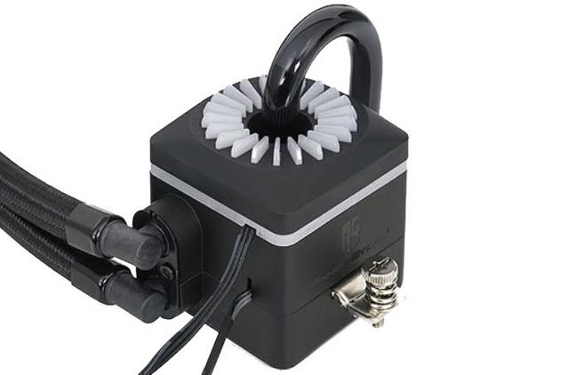

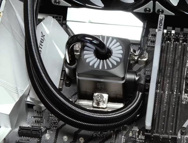

    The pump block unit stands 85mm tall, with a clear hard tube visibly moving the coolant from the bottom to the top compartment. On the other side, the two tubes act as the intake and the other taking the fluid through the radiator assembly. The cabling for the RGB LED of the reactor and the pump power is also located on the same side as the tubes.
    The "Visual Liquid Flow Design", as Deepcool calls it, further adds to the cooler's appearance, that's the glass tube coming out the top for those wondering. Meanwhile, the fittings on the pump have an okay range of motion. The three-stage induction motor in the sealed impeller quickly circulates the cooling water, and the zirconia ceramic bearing guarantees a lifetime of 120,000 hours.
    The water-cooled head has two connecting lines, one is the 3Pin interface for power supply and speed, and the other is the 3PinRGB data line for RGB light control. In addition to being controlled by RGB lighting controllers, the Gamer Storm Captain 240 PRO also supports the RGB interface lighting effects synchronization of MSI, ASUS, Gigabyte and ASRock motherboards.

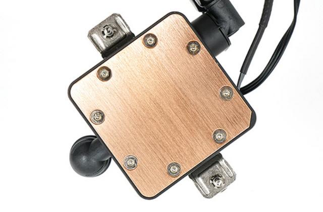

    When it comes to the base, it's smooth to the touch and clear of any serious machining marks. The contact plate is a nice large size (compatible with the AMD Ryzen Threadripper TR4 socket), and with the squared profile, which should extend beyond the edge of your processor comfortably, coverage is no issue.
    Also included are 2 Deepcool 120 x 120 x 25 mm fans with PWM control (4-pin connector) that offer addressable RGB LED lighting on the blades, so we can generate powerful lighting effects on them. They are generating a sound of low decibels. This is, in part, thanks to the anti vibration system mounted by each of the fans and the graphite bearings, which generates less friction and vibration when working at maximum performance.

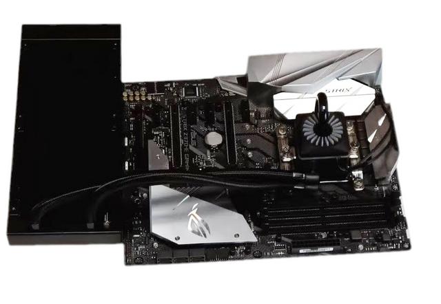

    Installation Process

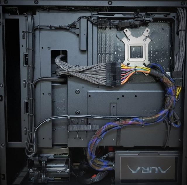

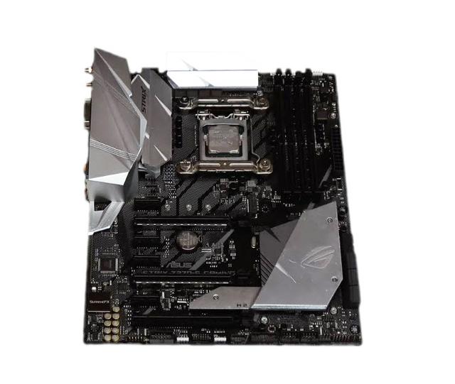

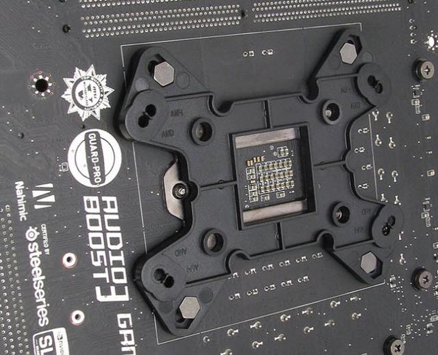

    Installation is quite simple. First, position the backplate on the motherboard with the proper screws.
    Then, using the provided pillars, secure the backplate to the board. With that done, secure the mounting arms to the pillars.
    Next, apply some thermal paste and secure the pump block to the mounting arms.
    Finally, install the fans to the radiator and plug the fans and pump into their proper motherboard headers.
    Once done, connect the RGB wires to the controller or proper motherboard header and you are done.

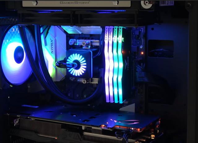

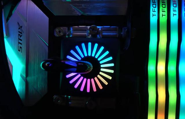

    Once physically installed in your case, you can plug in the fans, using the included fan splitter hub, and choose the correct adapter for connecting the RGB LEDs.
    Plugging the fans on the in-line controller provides seven color options which can be set to alternate quickly or in breathing mode. The speed which the LED behaviour changes can be adjusted with the controller as well. Plugging the pump block LED directly on the motherboard header opens up greater customization options.
    With the cooler's LEDs powered up, you get a much better idea of why the addressable RGB LEDs are something to shout about. Standard pulsing on and off, and static colour modes are also available through the controller, but one of the better-looking options is the rainbow spiral effect which transitions through colours incredibly smoothly. The lighting is not just on the pair of 120mm fans (each having 6 LED pieces), but on the pump-block as well.
    Installed - Memory Clearance
    As with pretty much every closed-loop liquid cooler, clearance is more than adequate. There are no obstructions around the socket to speak of. System memory is not limited by height, nor is the choice of GPU on Mini-ITX systems.

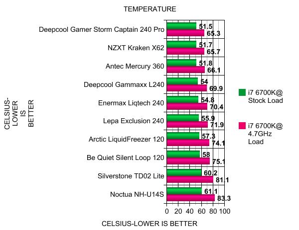

    Test System & Methology
    Test System:
    Cpu:Intel- Core i7-6700K Stock and OC@4.7GHz
    Motherboard:Asus Z170 Pro Gaming
    Memory:G. Skill Trident Z RGB F4 - 3866 C 18 Q - 32 GTZR
    Graphics Card: Sapphire HD 6970
    Power Supply: Antec HCG 750W
    Boot Drive: Ocz Vector 480GB
    Software:
    Prime 95
    CPUID HW Monitor 1.23
    CPUID CPU-Z 1.65
    Prime 95 and is run for 10 minutes and then the average maximum temperatures as recorded by CPUID HWMonitor are noted.The average temperature across the four cores is taken on our quad core processor.Celsius temperatures are used and i keep the ambient at 22 (+/- 1) degrees for all testing.Celsius temperatures should correct for any marginal ambient differences between 21-23 degrees.Acoustic measurements are taken 10cm horizontally away from the CPU cooler with the VGA fan disabled,hard drive in idle and power supply isolated. These are taken at desktop idle and Prime95 load.Voltages are fixed to prevent inaccuracy between comparisons. Each test is repeated 3 times with 3 remounts for consistency of results.
    Temperature
    There is nothing to worry about at Stock Load test.
    The overclocking results for the Captain 240 Pro are simply just exceptionally impressive. When you remember that this is only a 240mm cooler, it’s remarkable that it beats some of it’s larger ‘high-performance’ rivals.

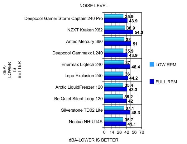

    Noise Level
    The noise levels for this cooler are simply amazing. Deepcool says that the fans are designed for minimal noise output and they were not kidding. To say it’s silent would be an exaggeration, but honestly, between the other ambient noises of a standard PC system, I’m not convinced these fans added anything to it!
