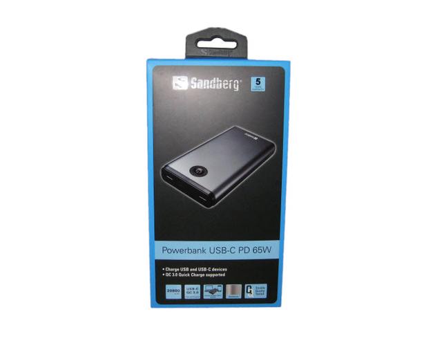

    The Sandberg Powerbank USB-C PD 65W 20800 comes in a nice retail box. On the front there is a large photo of the unit.
    At the rear of the box we see a description of the product printed in many languages right above the contents and specifications lists.

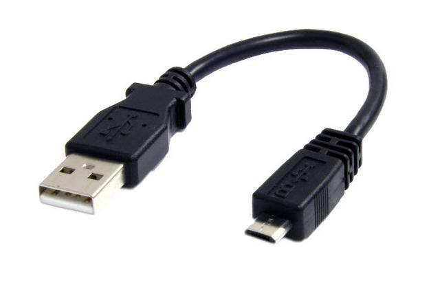

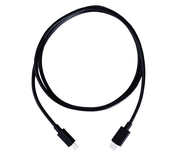

    In the box you'll get a micro USB charging cable and a 0 cm USB-C Cable. Of course Sandberg does not provide a charger with the delivery. If you have a Quick Charge enabled smartphone, chances are good that it already had a suitable Quick Charge compatible charger included.

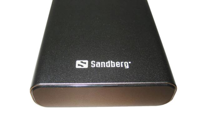

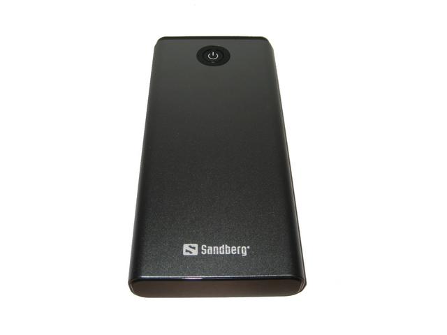

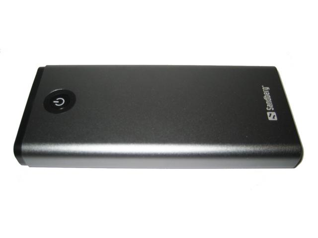

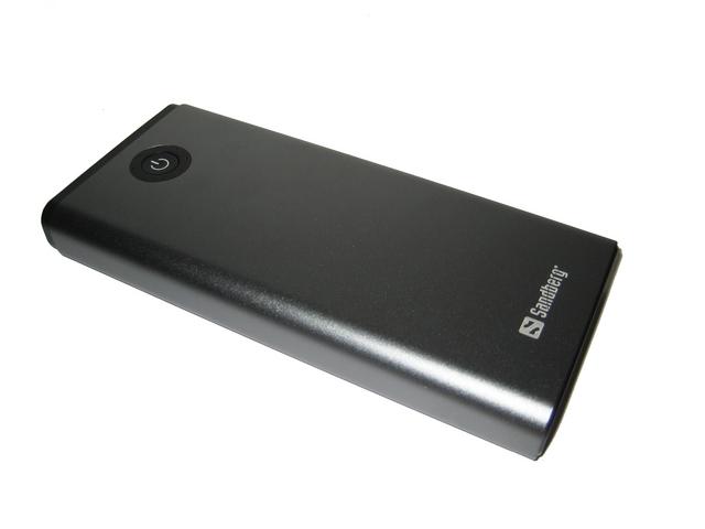

    From a visual point of view, there is not much to say about the Sandberg Powerbank USB-C PD 65W 20800. A simple aluminum power bank with plastic end caps in which the connections are embedded. Overall, the Sandberg Powerbank's build is structurally strong and doesn't have any pieces that will easily become loose and fall.
    The weight, is fine for an large capacity Powerbank with about 450 grams. So it's heavy but it's actually relatively lighter than other portable chargers of its size. Most portable chargers with its capacity weigh a full 500gr or more. So with its dimensions and weight, it's not the best option to hold it in your hand. However, it's best to use this portable charger in a not so portable way by setting it down and using it. Considering that you can charge 3 devices at the same time, the charger is really meant to be used as a charging hub. Portable chargers like these are still portable but more in relation to long distance traveling. Use it as a wall charger but it gives you a lot more freedom of where you can place your charger and the fact that you can have your devices right next to you.

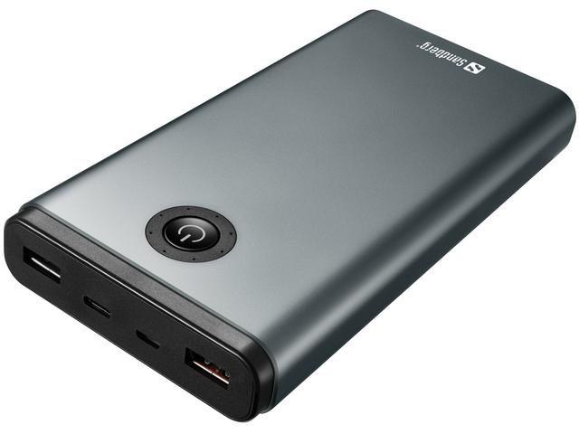

    On the top of the power bank is a concaved button that activates the battery indicator. The LED lights will glow for a few seconds. Each one represents a remaining charge.

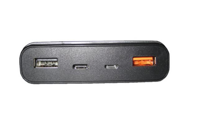

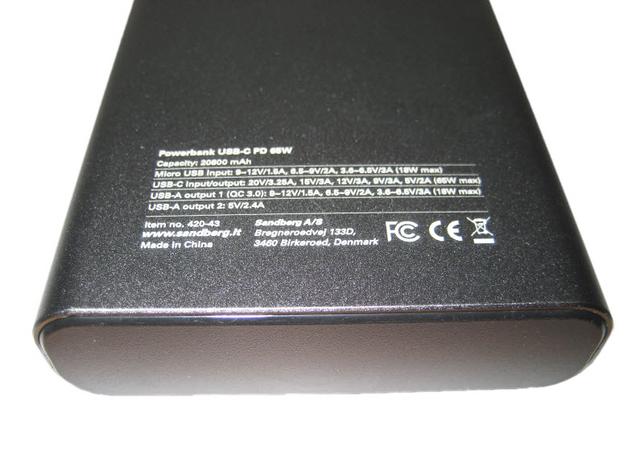

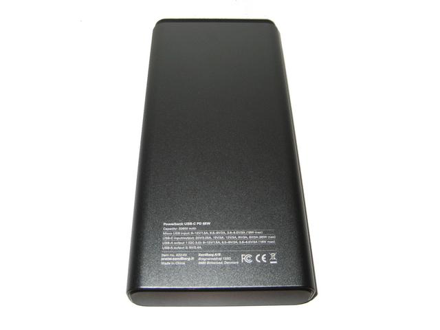

    The Sandberg has a total of four ports, of which three are outputs and two are inputs. "But that would be five ports" No two of the outputs are regular USB ports, the third is a USB C port. This can serve both for charging the power bank itself as well as for connecting other devices. But you are not completely dependent on this USB C connection to recharge the power bank. In addition, there is still a normal microUSB port available. The two USB outputs are a "regular" 2.4A iSmart port and a Quick Charge 3.0 capable port. QuickCharge 3.0 has only a slightly increased load speed compared to 2.0, but the efficiency has increased a good deal. If you charge a smartphone with 1000mAh, that does not mean that these 1000mAh end up in the battery. As with unloading the power bank itself, there is also a loss of energy when charging your smartphone battery. And Qualcomm would like to reduce this with Quick Charge 3.0, which is why this technology makes sense in a power bank. Incidentally, there is no problem with a Quick Charge 3.0 capable charger loading a Quick Charge 2.0 or even a non-Quick Charge capable device.

    First we start with the capacity. This is stated by Sandberg with 20800mAh, I could measure 19537mAh or 72.288Wh. This corresponds to a very good 94% of the manufacturer's specification. Why are 94% good? The manufacturer's specification does not refer to the ultimately usable capacity but to the capacity of the internal built-in battery cells. This not only makes Sandberg so, but pretty much all power bank manufacturers. Since the Sandberg Powerbank USB-C PD 65W 20800 is relatively easy to open, I checked it out. Inside there are in fact eight 2600mAh cells, which corresponds to the specified 20800mAh. These are even good Samsung battery cells! Samsung belongs together with LG, Sony and Panasonic to the better battery manufacturers. Discharging the battery cells and converting the voltage from 3.7V to 5V is not 100% efficient. Therefore, 94% is a very good value! The Sandberg Powerbank USB-C PD 65W 20800 ports are very different, 1x USB C, 1x USB A "2,4A", and 1x QC3.0. Accordingly, the charging speed is very different depending on the port and depending on the smartphone. Let's start with some Apple devices. The Apple iPad Pro achieves a good 2.51A on the USB C port (via the Apple USB C to Lightning cable), on the normal USB port 2.02A and on the Quick Charge Port 0.98A. The iPhone 7 Plus can not charge via the USB C adapter cable, but achieves a good speed on the normal 1.51A USB port and 0.98A on the Quick Charge Port. Apple devices often load suboptimal on Quick Charge connections. In case of emergency, if the normal 2,4A port is occupied, you can load your iPhone also at the Quick Charge Port, it only takes longer. Let's continue with Android devices and the Samsung Galaxy S8 Plus here. This unfortunately did not like the USB C port, nor the normal USB port very much. On both ports, I could only reach a charging speed of 0.48A. On the Quick Charge 3.0 port, however, the S8 + reached a good loading speed of 1.45A and 9V. As a second Android smartphone I tested the Google Pixel XL. This reached the USB C port 2.22A, the normal USB port 0.98A and also the Quick Charge Port 0.98A. What do we learn from these values? It was possible to load all tested devices at the Sandberg Powerbank USB-C PD 65W 20800 at a very tempo. However, this may require a lot of experimenting which port charges which device the fastest. What about the recharge of the powerbank itself? Here I could reach 1.8A, an acceptable recharge speed.
