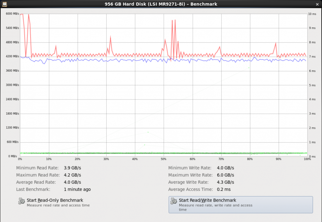

    Here is the Gnome Disk Utility Benchmark results for a 256K stripe 8 SSD RAID0 configuration:
