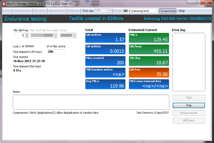

    13
    Thanked 35 Times in 20 Posts

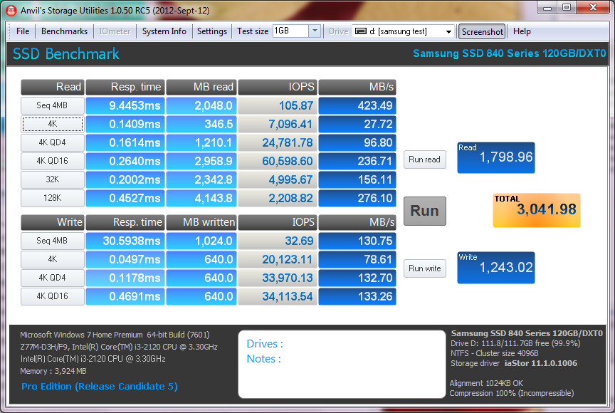

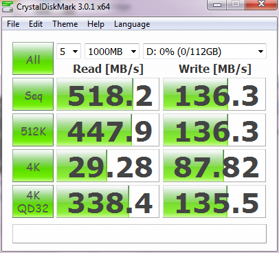

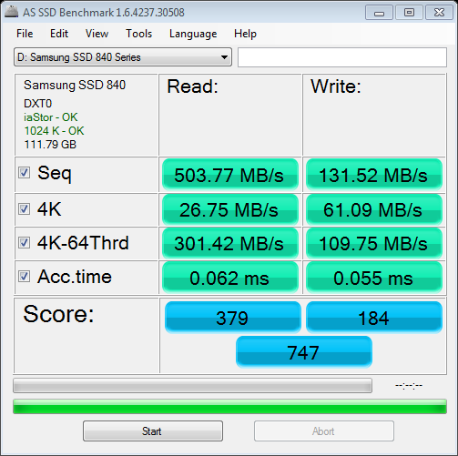

    Samsung 840
    Christopher ... I'm impressed with the read performance of the samsung 840 as well. It is certainly the match of any normal MLC drive.
    Anyway, time to get down to business ... to start off with, some benchmarks for the samsung 840:
    Read performance is fantastic .... easily as good as any SATA 6 drive I've seen.
    Write performance, while not as good, is still as good as your average 120gig sandforce drive .... which really is plenty for the tasks it needs to do.

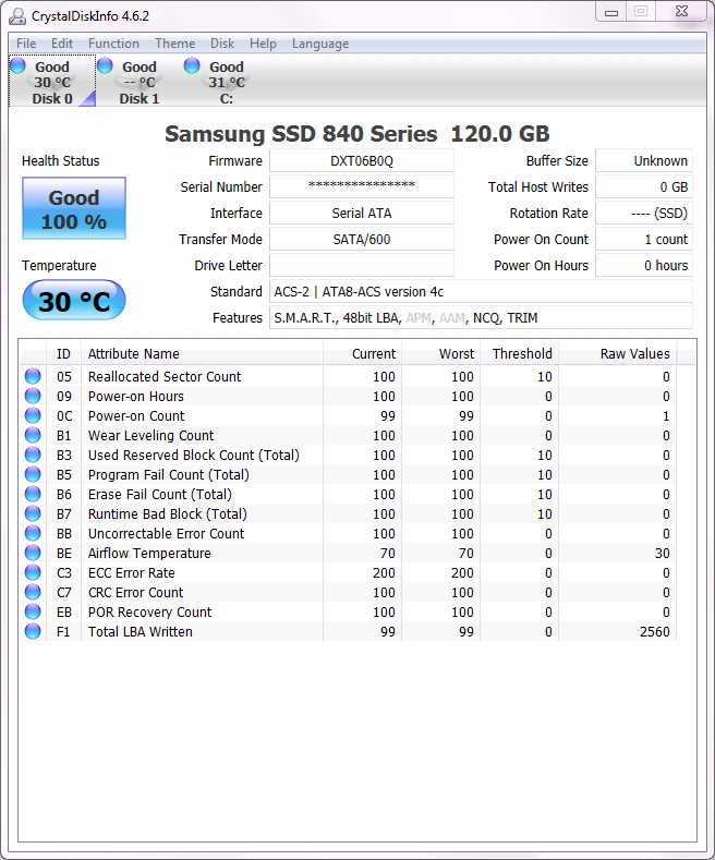

    Initial smart values
    Still plenty of juicy data there!

    Drive Details:
    Make: Samsung
    Model: 840
    Capacity GB: 128 GB
    Interface: SATA 6Gb/s
    Controller: Samsung MDX
    NAND maker: Samsung
    NAND process: 21nm TLC
    NAND part#: unknown
    NAND P/E spec: 1000 cycles
    NAND type: Toggle Mode
    Testing Environment:
    OS: Windows 7 x64
    Hardware Platform: Intel 1155 Z77
    Test Details:
    Static Data: 39.2 GB
    Over-Provisioning: 0 GB
    % Compression: 46%
    ASU Endurance test Started:
