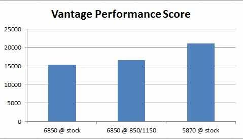

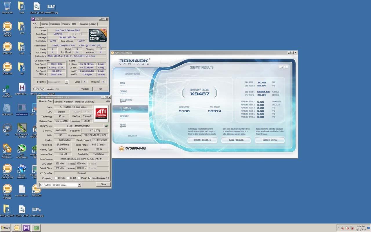

    Vantage Performance
    stock 6850
    6850 @ 850/1150
    stock 5870

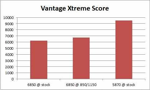

    Vantage Xtreme
    stock 6850
    6850 @ 850/1150
    stock 5870

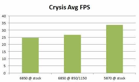

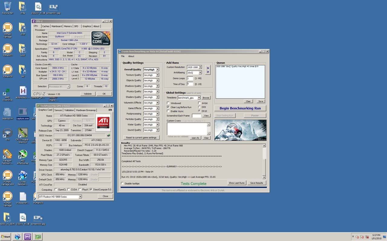

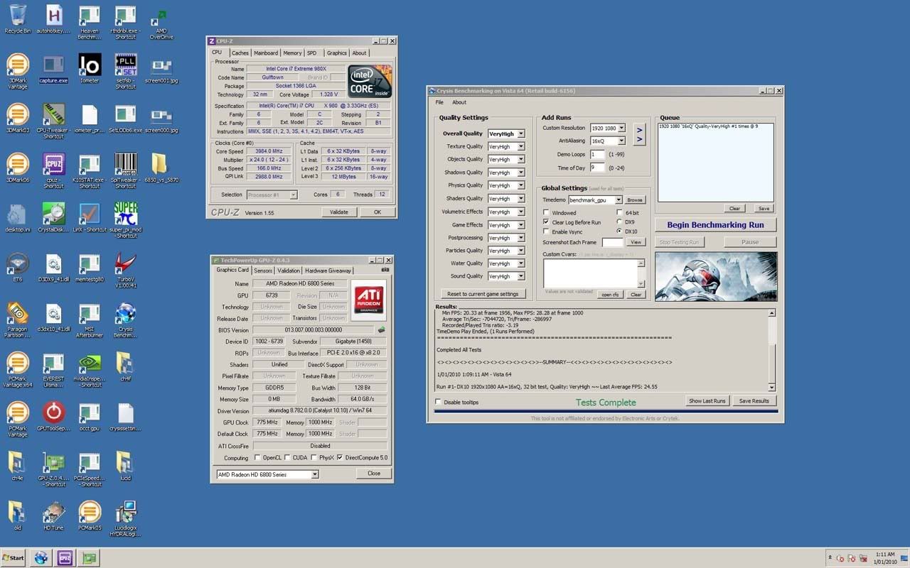

    Crysis Avg FPS
    stock 6850
    6850 @ 850/1150
    stock 5870

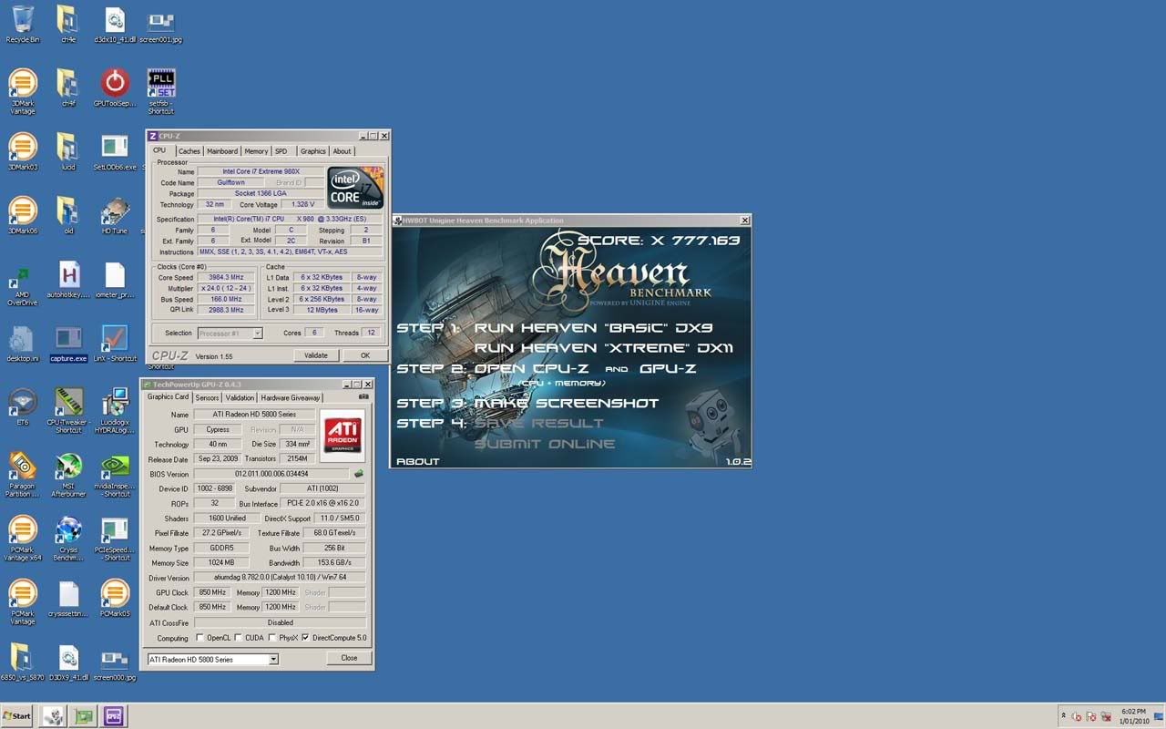

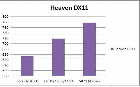

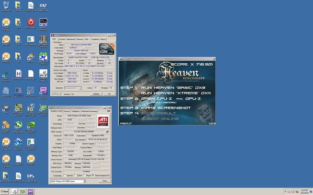

    Heaven
    stock 6850
    6850 @ 850/1150
    stock 5870

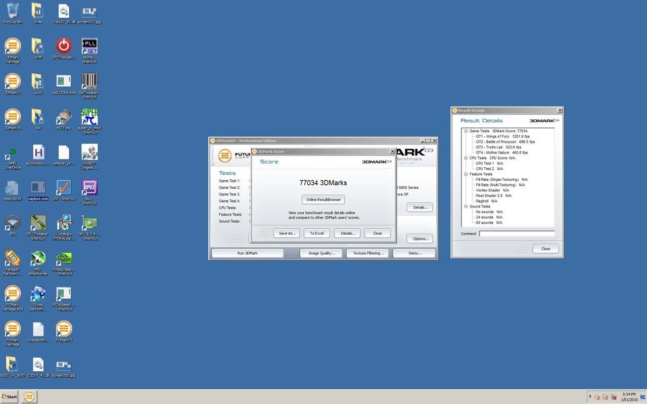

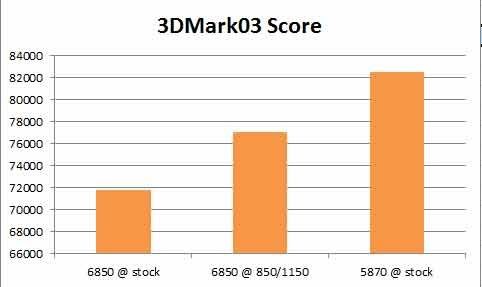

    3DMark03
    stock 6850
    6850 @ 850/1150
    stock 5870

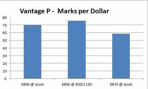

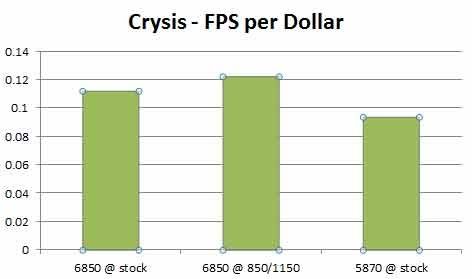

    Cost per Dollar analysis
    Costing was done at cheapest price I could find to purchase each unit from staticice.com.au (Australia's pricing search engine)
    5870 - $359
    6850 - $219

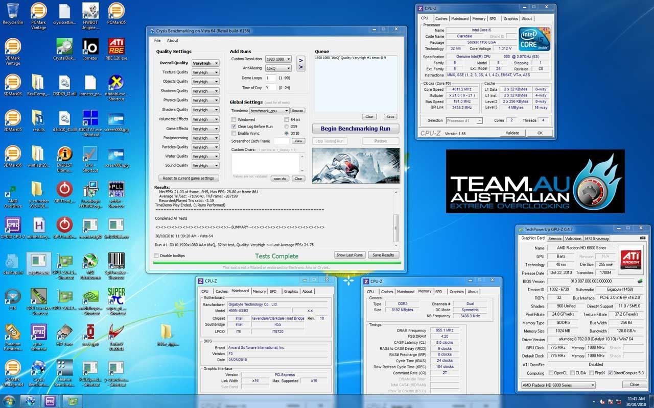

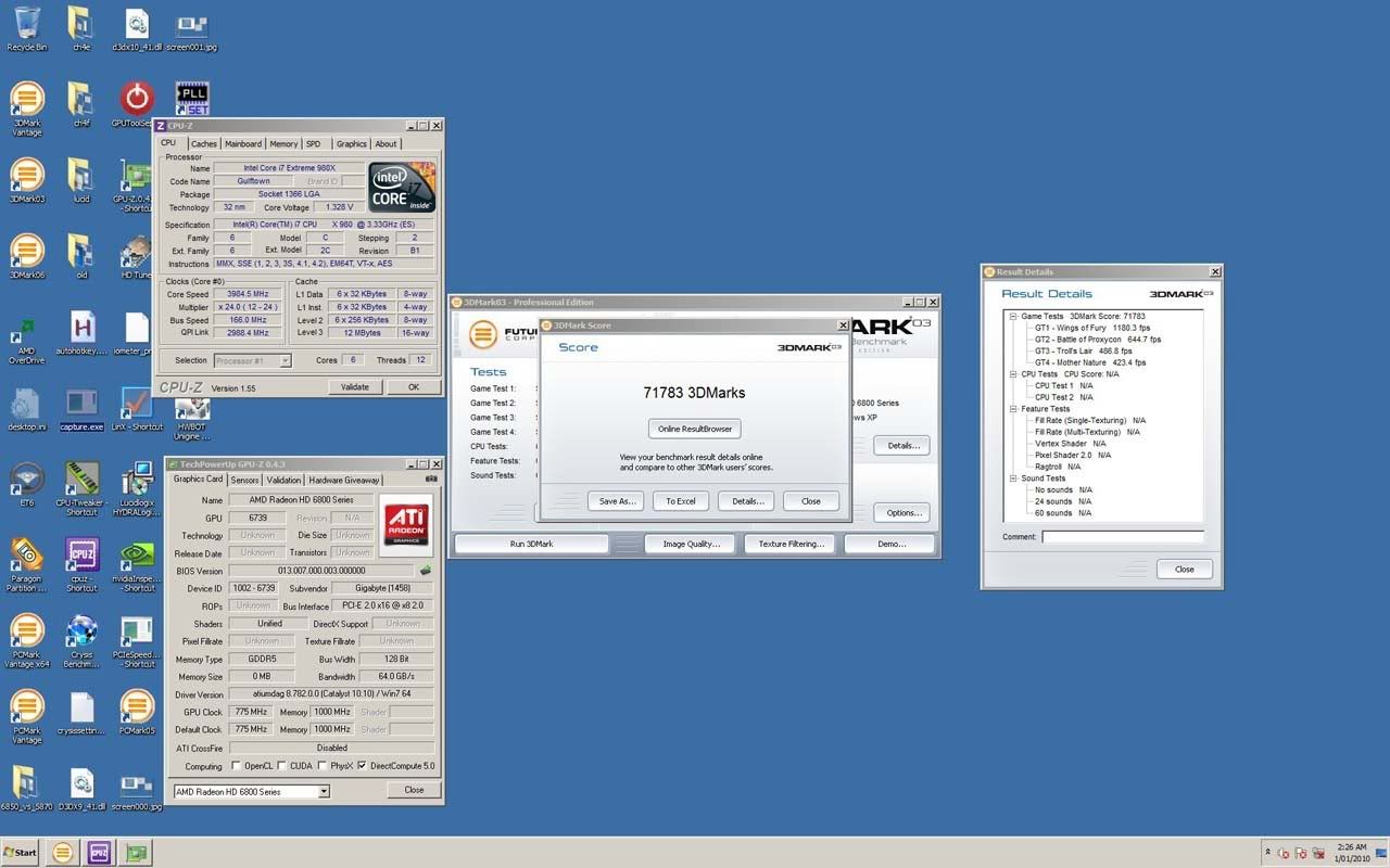

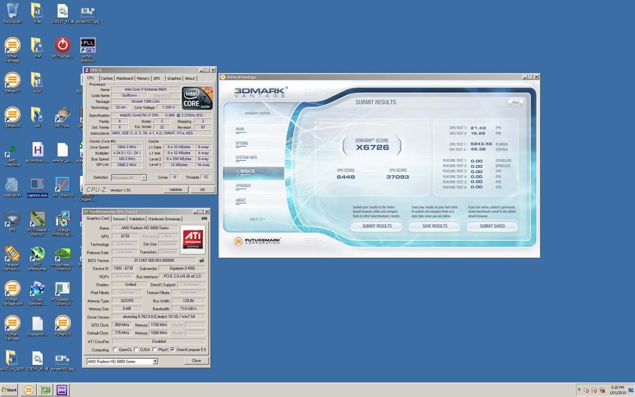

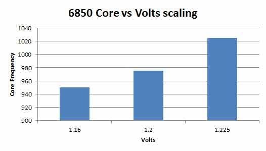

    Max Overclocking
    3DMark03 full pass was used as a test of max clock stability.

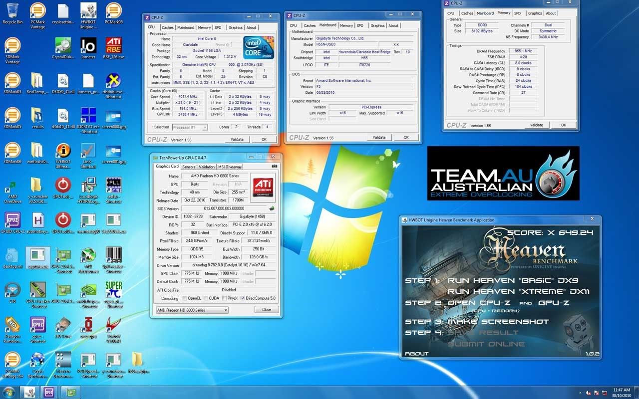

    Clarkdale Gaming Comparison
    Just for kicks I put this card into my clarkdale system, set the same clocks and punched out a Crysis and Heaven.. To see is these games gain from a massive 980X or maybe they are fine with a little clarkdale and gigabyte H55N-USB3

    It is clear looking across all the benchmark results that the 6850 is no 5870 and in most tests the 5870 is 20% of above the 6850. This was to be expected, they are different specifications and not in the same price range.
    Things get interesting when we start to look at price vs performance results.
    The 6850 is a winner in all these tests by a massive percentage. When overclocking the 6850 we see nearly a double price/performance ratio advantage in Crysis and about a 50% advantage in Heaven. This is what "budget gaming" is right here, a card that doesn't break the bank but can deliver a large percentage of the performance of the higher end cards.
    Moving onto the Max Overclocking, this is all done on the stock cooler of course and without moving the stock voltages too far.

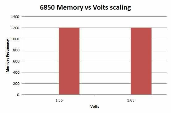

    We can see the core scales up nicely and consistantly with voltage bumps and we were passing 3DMark03 and Vantage Xtreme with 1025 core, 1.225v and reaching a maximum temperature of 55 degrees. This is a fairly impressive clock.
    The memory overclocks nicely, but doesn't seem to be impacted at all with volts. I was able to bench at 1200MHz on stock volts but bumping to 1.65 didn't increase these clocks at all. Perhaps with some more time and playing with these settings we could get the voltage to help.
    The Clarkdale gaming comparison is fairly interesting.
    Crysis has always been known as a game that scales reasonable with CPU power and cores. It seems there is a heavy GPU bottleneck even at 4GHz, as the clarkdale system actually comes out with the advance, be it so small it is within a tolerance of difference between runs.
    As Heaven is heavily GPU bound, again there is very little difference, again within a tolerance of difference between runs.
    These results give a clear picture, at least with these two game benchmarks. If you are running single card gaming chances are you are going to be heavily GPU bound with the newest games. If you are purchasing an expensive X58 system, with a 980X or bloomsfield CPU it might go to waste with one GPU. Multiple GPU configurations may be difference for these benchmarks, but that is testing for another day.

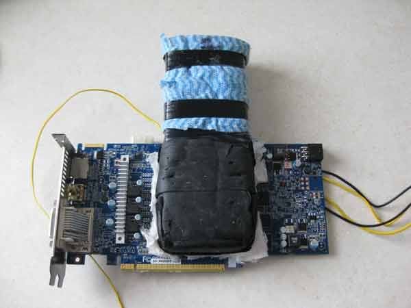

    No subzero?
    Not yet, card is prepped though. Just waiting on the ability to push past 1025MHz with software and I'm away!

    Why testing 16xQ in Crysis? Doesn't make sense to me.
    PS: in Crysis, 6850 @ 1000 performs more or less like a GTX470 @ 800.

    why did you compare crysis max fps?
    to me that doent matter at all when gaming, its all about reaching a comfort zone for av fps, which is different for everybody and every game, and then having min fps at or above the min fps comfort zone...
    actually if i had to chose id even go for av fps below my comfort zone if it gives me min fps at or above my min fps comfort zone.
    40av/30min>50av/20min
    i dont understand the volt/oc scaling, there are two entries for 1.16 and 1.225?
    When overclocking the 6850 we see nearly a 100% price/performance ratio advantage in Crysis and about a 50% advantage in Heaven.
    what do you mean? the 5870 has a 10-20% higher perf/dollar score than the oced 6850
    this is the settings I always use for this testing, so i will continue to use a setting for comparison sake, if you can suggest settings that is more likely to be used by gamer, please let me know i can include in future testing
    Quote Originally Posted by saaya View Post
    i titled the graph wrong, you can see now it is AVG fps
    i have changed it just for you sacha, now it should be more clear

    @saaya: comparing min fps in Crysis is totally stupid...because at the beginning of the bench everybody has a HUGE stutter for a really short period of time that jeopardizes the whole benchmark. Its so bad that you can improve the min fps up to a 20% just running the bench enough times (cause the stutter is kinda random), that is why I never take into account the min fps value for that benchmark.
    Quote Originally Posted by youngpro View Post
    It is pointless IMO because you will never use that setting. You will use AAx4 and thats it, so its better to test with realistic settings.
    The first run doesnt count towards your score, and the lower frame rate is because its not cached to the HDD yet.

    mate this is a MSI test bench, i got it for a christmas present a couple years ago,
    IMO our good friend Andrea "dimastech", makes the best OC benches!
    fLucking photobucket, i had to pay some money for my images to display, oh wells!

    Notice how GPU-z read the 6850 correctly on the Clarkdale system ? Did you reset the mobo's bios after each card swap ?
  22. #22
    PIfection
    May 2006
    989
    nah i dont recall doing that mate, is there some issue there?
